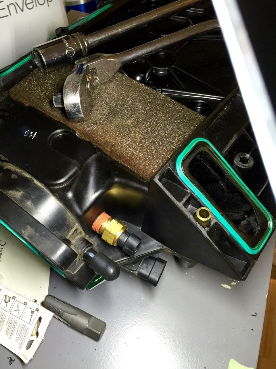

If running SD tune you can put nozzle before MAF and use IAT built into MAF..
If not running SD then nozzle needs to be after MAF and IAT needs to be after nozzle. Couple of options but I used part number WT382 and put it on the passenger side of the intake manifold just after the throttle body. Drilled a hole, tapped it, screwed in MAF. Obviously it has to be wired in.. I pulled the two IAT wires from the MAF harness and extended them over to the new IAT.

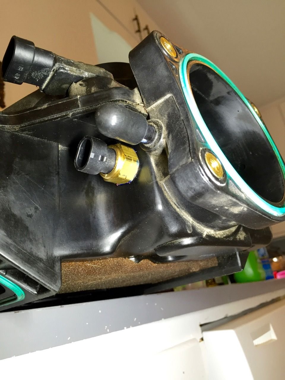

Old Jun 4, 2016 | 09:56 PM
schpenxel's Avatar
schpenxel
Joined: May 2004
Posts: 16,667
Likes: 1,209
From: Raleigh, NC
St. Jude Donor '15
I've got a bunch but here's the basics

Old Jun 5, 2016 | 11:27 AM
Unreal's Avatar
Unreal
Joined: Nov 2007
Posts: 24,035
Likes: 2,342
From: Gilbert AZ
Or you can do a push in one on the pipe if drill the pipe is easier.
IAT is right next to PS res.
