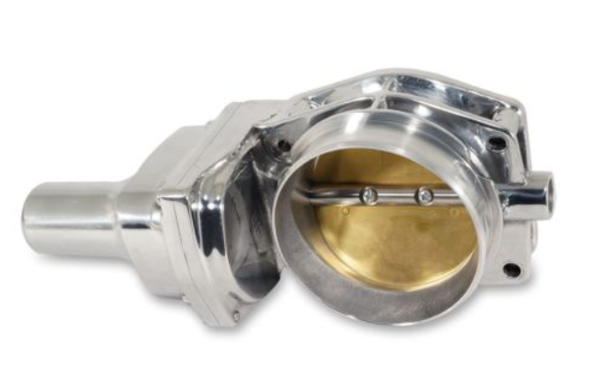

Wondering if this was done before:
Problem is I'm over 20lbs boost, too much for a stock LS3. Don't want to pulley down to keep max boost under 12-15 because I'll lose boost on the low end. A fixed restrictor can be used to set the high limit but something programmable might be better and possibly flatten out the torque curve or track a boost profile vs RPM. A $100 throttle body can be mounted at the end of the inlet pipe, and screwed to the air filter where the fixed restrictor is. Some simple electronics could be used to accept a user configured profile or max boost setting, then monitor kPa and RPM and use that as feedback to control the motor in the throttle body. Total cost under $200

Working on the pressure side makes a lot more sense and would be easier to control. The opening/closing of the valve or throttle body would be more linear in relation to boost. I think the suction side would be a lot harder to control unless it was a Iris type opening and those valves are north of $600. Pressure side probably has less turbulence and less parasitic losses since it's relieving head pressure and not reducing inlet flow, and less heat. Again, everyone said it wouldn't work.
Care to share some details on your setup?

I'll pick up a small gate used on some 4 cylinder rice burner or something, probably only need 1 sq/inch area to vent. Thinking of putting it on before the intercooler also to avoid heating the air only to blow it off later, also less turbulence at the throttle body the further away I'd imagine. (And I can still run MAF )
The solenoid would work great to clip the max but I want to screw with a gear dependent boost controller. More **** to play with.
