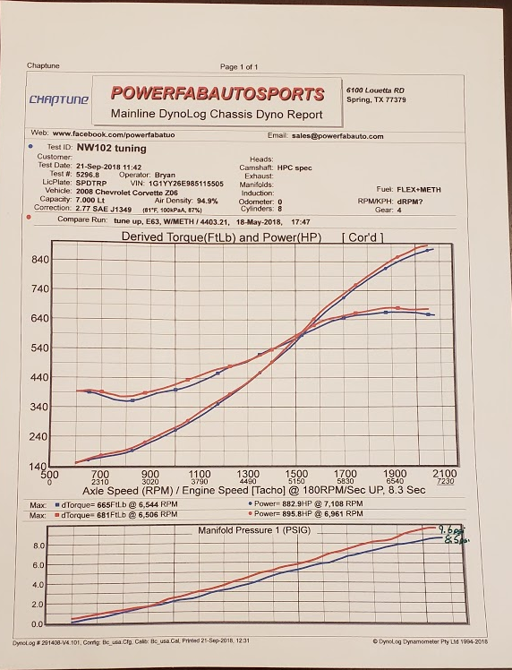

What kind of power did she make?
Old May 19, 2018 | 09:28 AM
silvrhand's Avatar
silvrhand
Joined: Oct 2013
Posts: 520
Likes: 31
From: Austin, TX
900rwhp on e85 @10PSI.

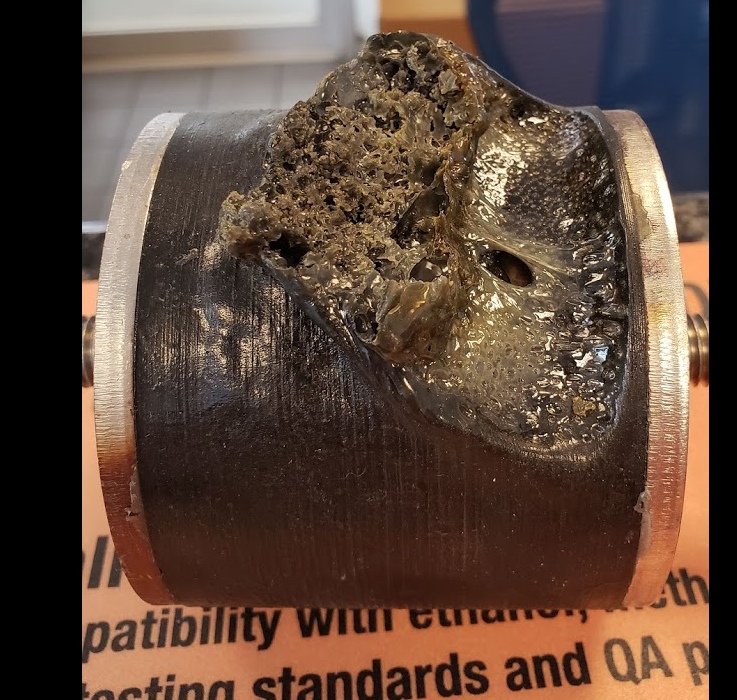

A few follow up issues:
- never could get the surge out, figured out that the porting of the TB I got was a bit much allowing for too much air to pass.. upgraded to 102mm throttle body.
- clutch master went out upgraded to ticker master clutch
- headers cracked at the collector, ARH refused to warranty them since I had them jet coated, had them welded and put back on.
- when headers cracked it melted the poly motor mounts..
Old Sep 29, 2018 | 11:24 PM
silver408z's Avatar
silver408z
Joined: Feb 2010
Posts: 1,310
Likes: 99
From: Arlington Texas
Put some heat wrap on your mounts. I had one melting and I did not have a cracked header.

Details on engine?
What was the correction factor on the dyno? 2.77 doesn’t make a lot of sense
Old Sep 30, 2018 | 03:14 AM
silvrhand's Avatar
silvrhand
Joined: Oct 2013
Posts: 520
Likes: 31
From: Austin, TX
Originally Posted by schpenxel
details on engine?
ls7
