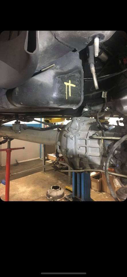

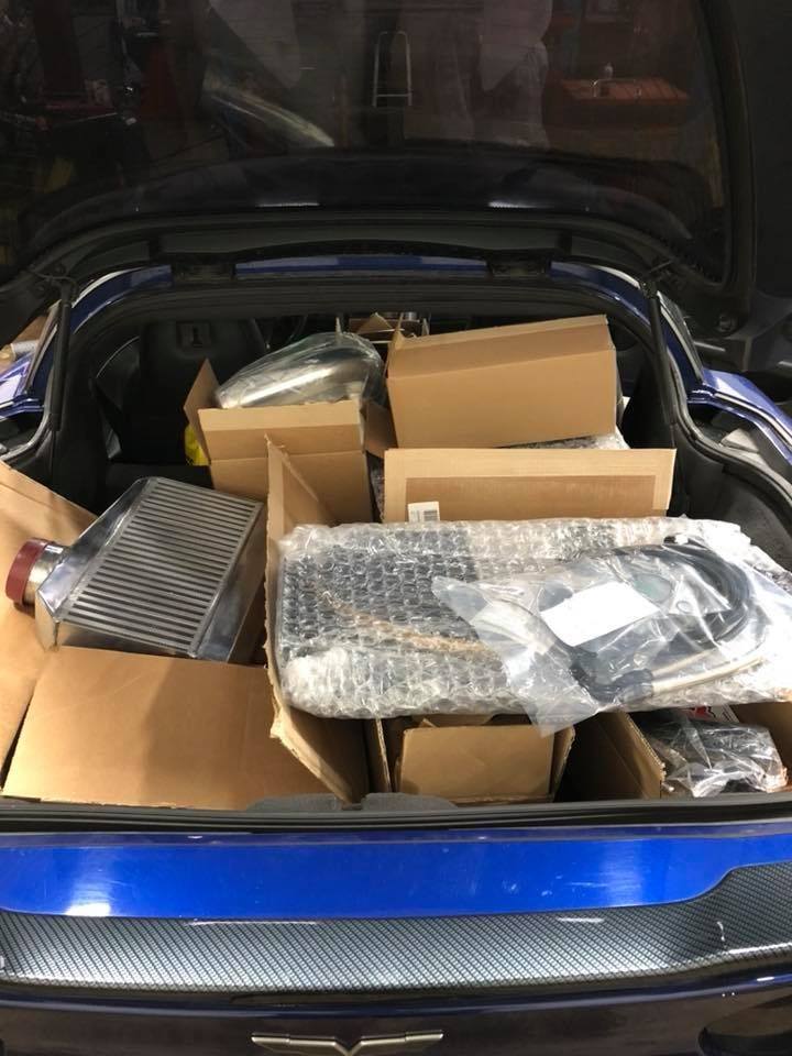

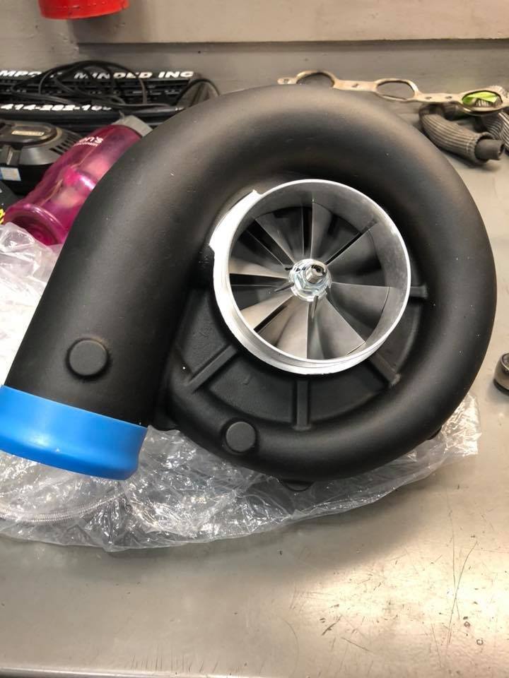

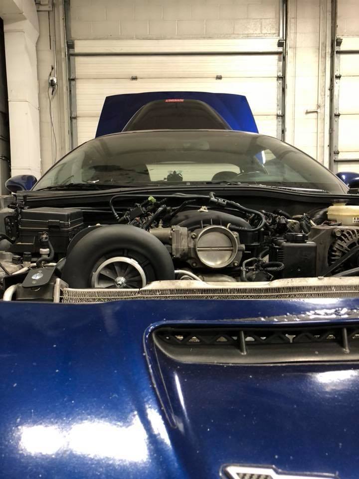

Last year I bought a 2006 Corvette Z06 that already came with PRC 285 heads, LS7R cam, LG headers, X pipe, intake, and B&B fusion exhaust. I bought the car in Texas and drove it 1200 miles back home to Wisconsin all in one day. At that time it was making mid 550whp but a few months later I wanted more power. So I ordered the ECS supercharger kit, with the novi 1500 supercharger and Bosch 1000cc injectors. McLeod RXT Street Twin Clutch, dsx flex fuel kit, and ecs stage 1 e85 fuel system. Here are some pictures of where we are at with the build so far. MY goal is somewhere around 750whp when it's all said and done.
All the parts barely fit in the car.
Holy hot spots!

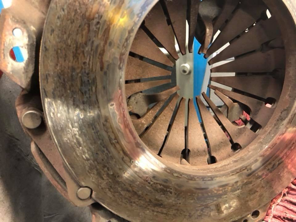

Was in worse shape than I imagined.
Holy hot spots

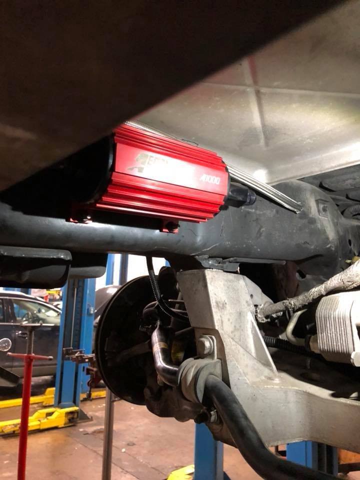

Installing the ECS Fuel system

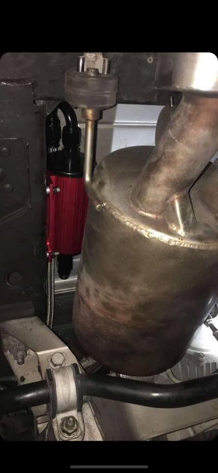

We had to relocate the A1000 fuel pump above the exhaust.
It was shocking to see how bad the stuck clutch was, with so much life left in it. What we have left is to complete the flex fuel system and put the blower in. Plan on using an AEM flex fuel wideband failsafe gauge to monitor ethanol%, boost and AFR as well as used for data logging and as a fail safe case the car goes lean.

Looks good... should be a fun build. I am a little surprised the fuel pump is so close to the exhaust though.

I would move the pump boss, I heard the a1000 get hot enough as is.

Yea I was also a little concerned about the pump being so close to the exhaust. We plan on putting some heat shield insulation on the muffler, although there is a couple inches of gap and mufflers only get up to 300, maybe 400 degrees, and it's exposed to a ton of air. Also the pump is running on a Hobb switch therefore it would be off for majority of my driving.

I would be happy to send you picks of the install of our fuel system, that is not where the pump belongs. You can also go onto our website for the instructions too, that's probably easier.
Your build is going to be awesome though, congrats!! Email us anytime if you have any questions along the way.

Thank you and I PM you guys about the pump.

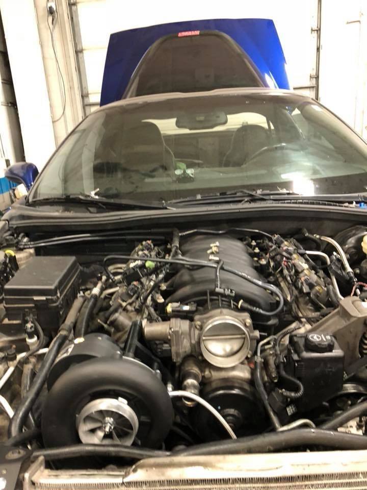

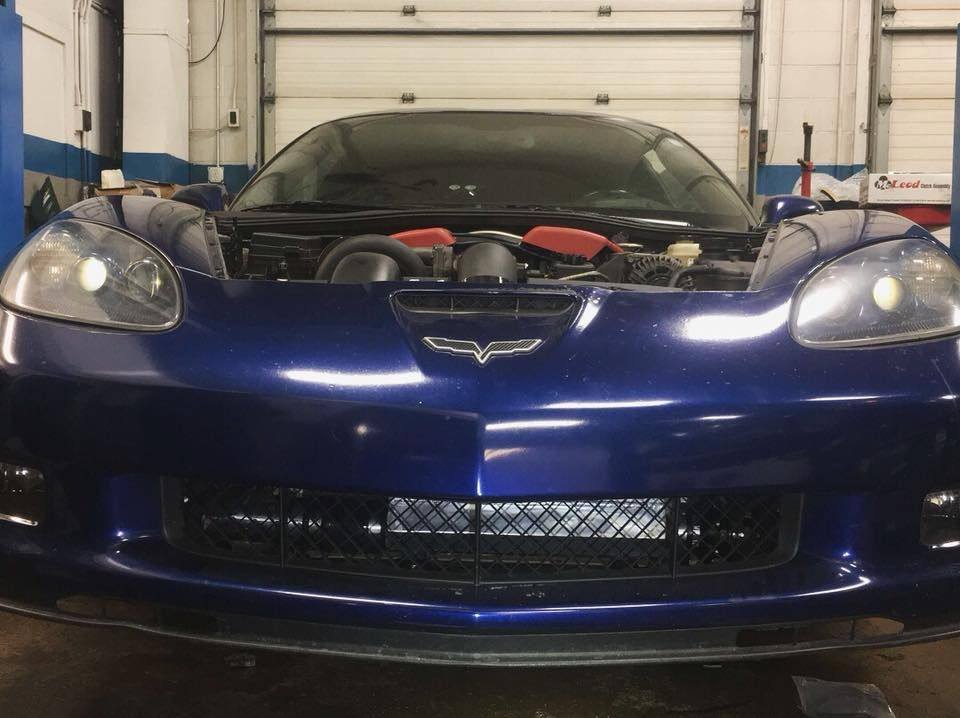

Over the weekend the Blower was installed, the fuel system was complete. Next is to install the AEM gauge and put the exhaust back on and take it to LMT(Late model throttle) up here in Wisconsin.
Mock up of the intake hoses. Not all the brackets are on
