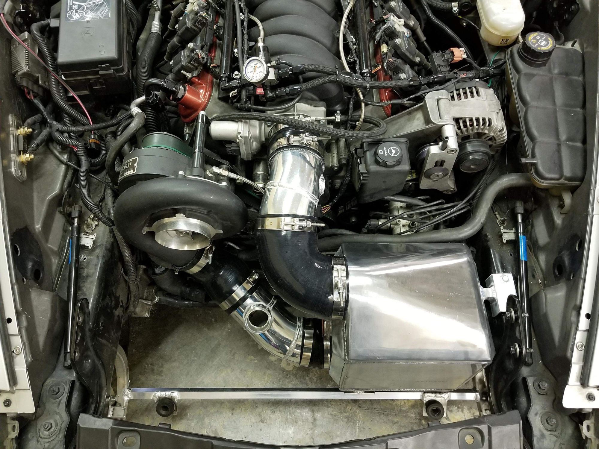

Custom build. Mine has a ShearerFab front mount 2000hp intercooler and a ShearerFab 8 gal tank in the back. Ormes brothers for all the lines and fittings. Cools better than it ever did with the A2A blocking the radiator. In 90 degree heat, 1/4 mile pass the IAT started in the upper 50's and finished in the 80's. Best move I ever did to my F1X build was go A2W....

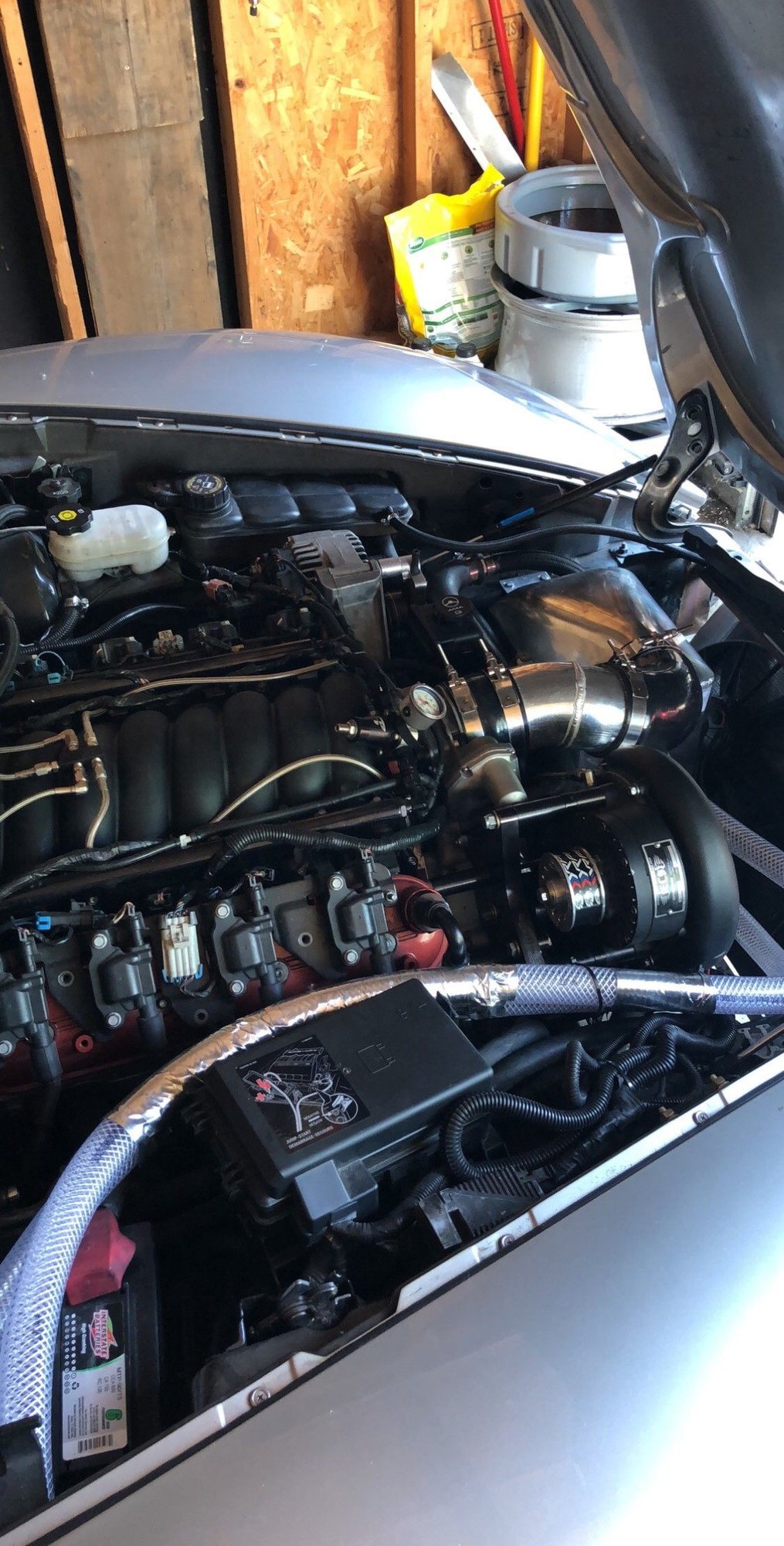

I just did A2W on my 2200r setup, Frozen boost core, Rhoades Fab 5 gal tank with rule 2000 (should have gone bigger tank). Recently did a 1/2 mile event, I wasn't running the pump in the staging lanes until I was next up IATs started at 88 finished at 122. I have roughly 2k in parts and labor in to my setup.

Which FB IC is that? I’m looking at options, and that might fit my needs.
My initial idea was to put it in the passenger foot well, but if I can keep it up front, it might work out better for my application.

type 12, its big and its a tight fit, but I'm very happy overall. Drove the car 30 miles yesterday in stop and go traffic in 98 degree heat and coolant temp stayed at 190.

Thanks. That’s pretty slick how you’ve got it mounted in there.
