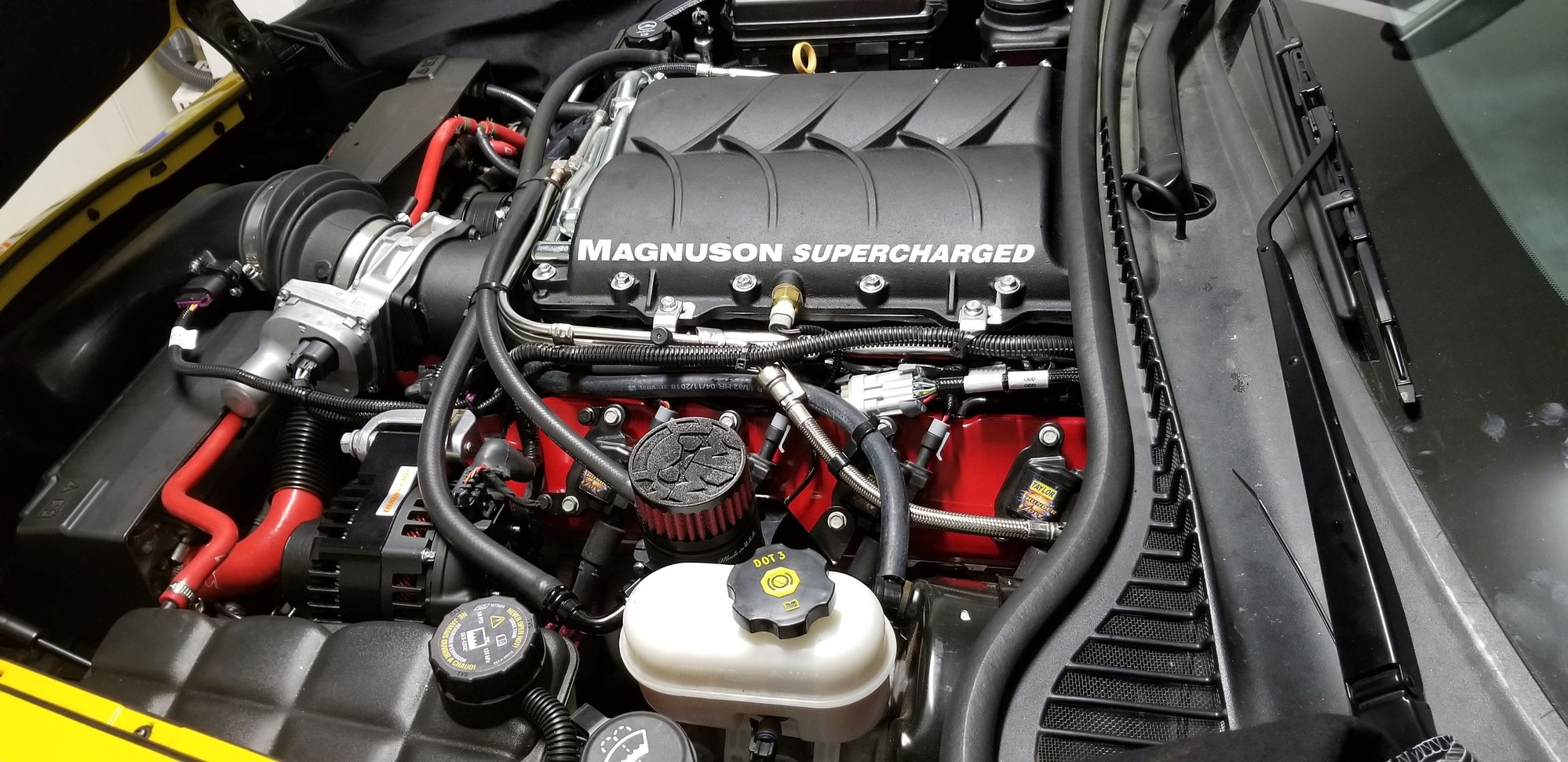

Same LS3, same SuperCharger, put the MM on the driverside. Just build a quick bracket coming off the coil mounts.

Just ordered my MM Gen 5 today. I'll have to remember that mounting idea when I install it. I have the E-Force on my LS3 and am hoping to mount it on the passenger side but will do this if needed. I'd prefer to keep it away from the headers if possible since I'll be running the remote drain extension.
