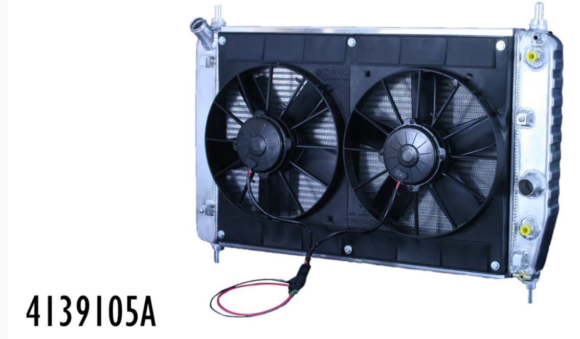

How has your experience been with the DeWitts radiator with Dual SPAL fans ? My mechanic just received this unit for my 2012 Grand Sport manual transmission, not installed yet, so i do have time to exchange the 4139105A for the unit without the fans 1139105A and use the OEM fan. My car is NA, mild cam, headers, tune.
- Does the OEM ACDelco alternator handle the dual fans draw or is a larger amp alternator required ?
- Is any custom wiring required ?

No reason for the fan upgrade unless you have something like a big heat exchanger blocking air flow through the radiator. I ran the same setup as Chiselchst (stock fan). Even with the small Maggie heat exchanger in front there were no issues with cooling. I could idle it standing still with the a/c blowing cold in hot assed Tx weather and engine temps stayed under 200. As soon as you started moving it went down to 175 to 185. In cool weather, it ran too cool with a 160* stat. If I had that one to do over, I would use a 180* stat.

I noticed you called the DeWitts dual fans an "upgrade", so it could be said that the dual SPAL fans are overkill, or another way to say is that the DeWitts dual SPAL fans will cause no harm whatsoever.
Would a larger amp alternator be required to handle the draw of the two fans ???
Also, what is considered "too cool" and do i run the risk of that using the dual SPAL fans with the rad upgrade ???

In cool weather, it would not get much over 165*. That's running too cool in my book. And you don't have a heat exchanger blocking airflow. If you're bound and determined to light a few benjamins afire to make an "improvement" that's absolutely not needed, it's your money and time that will be wasted.

My 08 base would hit 230 in traffic with AC on. The intercooler made the stock fan barely able to keep up. The tuner set the fan to run hard from start up. Of course, the connector was melted from the high current. I bought direct fit short Dewitt’s Prospeed fans and while pricey they are awesome. The plug now carries light load to the controller and the fans are powered from the fuse box post. No more pucker factor.
