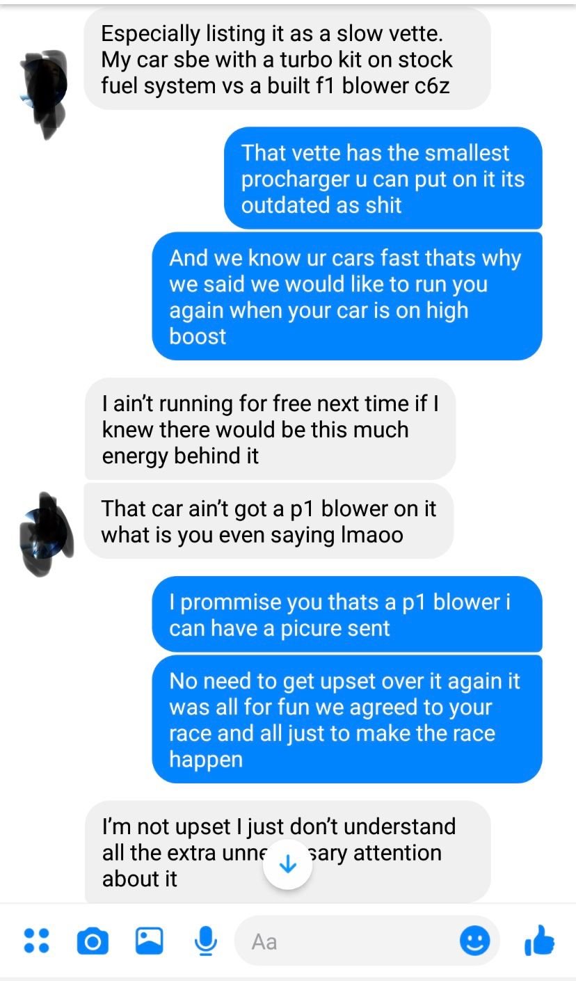

I can’t take any credit for the video editing....that’s courtesy of my buddy, great guy to have on Mexico runs! Lines things up, get footage and not bad at editing either! He also sent me a screen shot of his texting with the mustang owner the next day(they are somewhat “friends” lol).....it’s pretty damn funny.....👇🏻
Little back story....there was a large cars and coffee the next day....the night pre meet was pretty good and Mexico runs that night had been set in advance....around 200+ cars showed up in this part of Mexico and to my surprise our race ended up being the “main event” apparently so this got a lot more attention than I’m guessing he expected. Weather was sketchy but it held up, I think the weather be so iffy kept the 4 digit cars from making the trip, not a many of those around here anyway and the few there are didn’t come out.

Took me three months to get this dude to actually show up and he was the one say “no corvette or any around here is gonna touch me” 🤣 I just do the Mexico stuff for fun....and he’s aware of that, I’m guessing why he threw out the next time it’ll be for money🙄.....him and his tuner where all up in my engine bay as well, I had it open all night...**** I gave them my flashlight so I found it amusing that he was saying I have a fully built motor with and F1X
To Alky Control question
