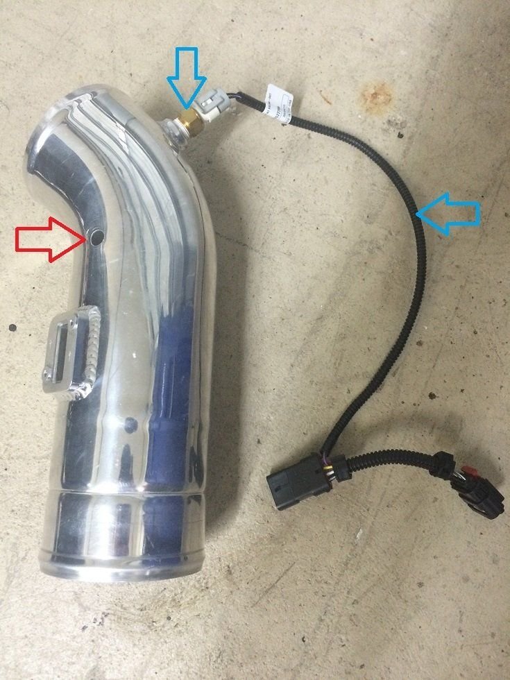

You'll need an IAT breakout harness to relocate the IAT sensor from the MAF to a position closer to the throttle body on the intake charge pipe so that it can accurately measure the cooler IAT temps. Nozzle should be between the MAF and the IAT sensor/throttle body.
I've never heard of a breakout harness before. Is this what everyone does with alky kits, or only if you want to measure IATs?
Cash1333 how do you plan on displaying your IATs? Gauge?

The blue arrows point to the harness. If you want to accurately measure post-meth IATs, this is how it's done.

Ahh so it breaks off from the MAF sensor, so there are no new plugs to splice into the harness. Where did you get that piece?
ECS sells one.

I was just going to use my phone and use a OBD2 port to moniter the IATs.
if you're running e85 you may not necessarily need meth anymore... if your tuner never adjusted the iat table after tuning on e85 have them look at that first, they can raise the threshold and as long as you have no knock you're good
He did adjust the tables after e85 however he was still getting high IATs(mostly due to the fan set up on the dyno I think) of 170-180F. Out on the streets it would see 140F however I would like it to not change all that much and using meth for a cooling mod will be beneficial for that point.
Also What I am reading I just buy a break out kit and a IAT sensor? does the break out kit come with an IAT sensor?

Dashlogic is great, but you still need a screw-in or push-in style IAT sensor to use with the harness.

I’d get the pop in style one. You can buy the sensor and grommet at advance auto. If you need the part numbers let me know.
Which SC setup are you running?
I’m assuming you’re sure it’s actually using the MAF? A lot of FI setups do SD tunes that don’t use the MAF. In that case you can spray before the MAF and skip the break out harness, etc.

If you're using an SD tune then it doesn't matter if you spray on the MAF since the only thing about it actually being used is the IAT anyways. That's why I asked.
All you need is the harness, a sensor and grommet. The grommet and sensor you can get at Advance Auto if they aren't included worst case.
Call ECS, they sell a kit with everything.
