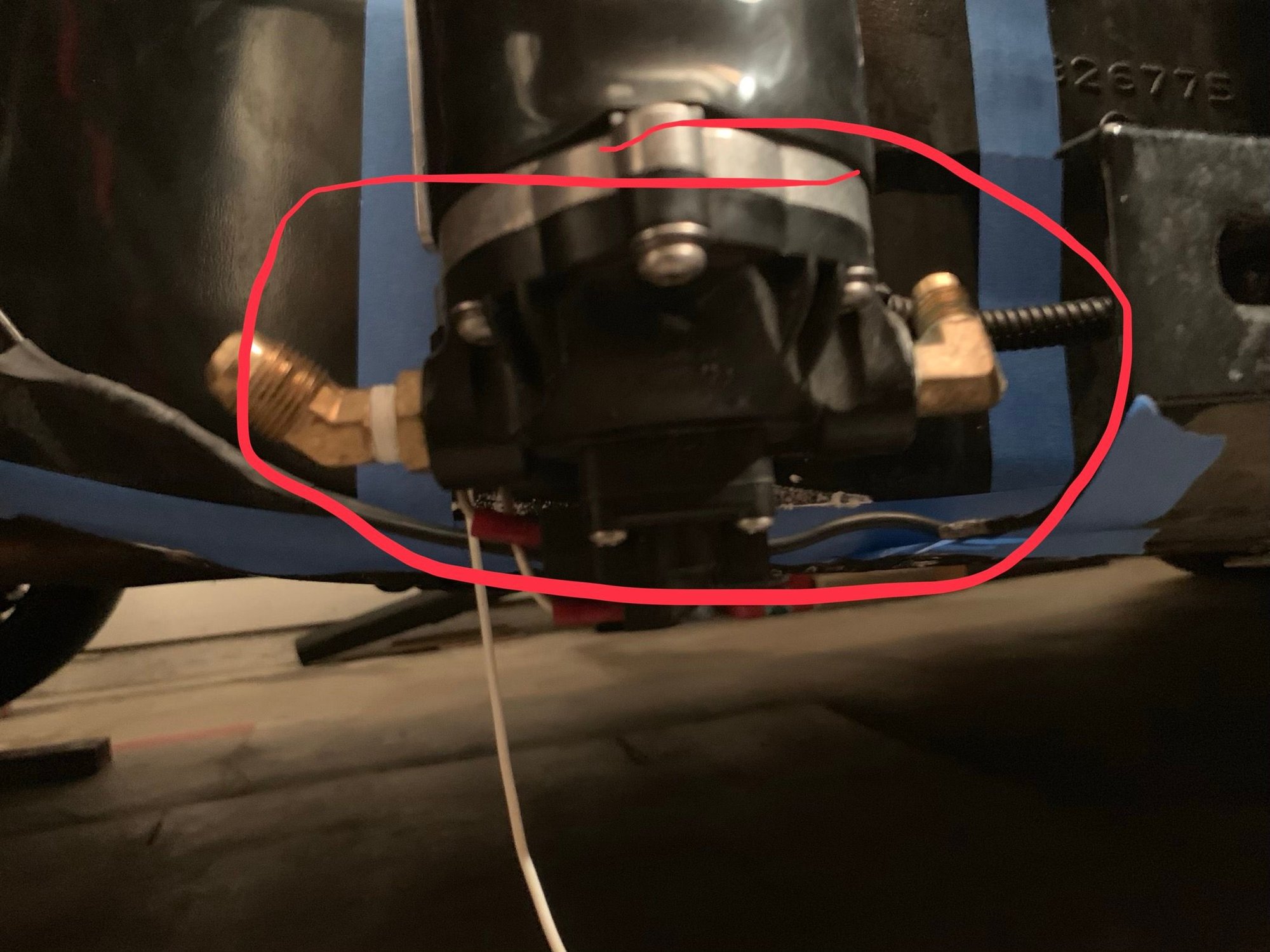

Made it by Alkycontrol today! It was cool to see the shop and I’m glad Julio let me stop by, it’s really not a store front or anything so much appreciated letting me pick up a new pump sir!
They were pretty busy to say the least but he did show me the quick change out of just the bottom section, said I could do that in 10-15 min easy so that might be my course of action for this weekend....got a date in Mexico 🇲🇽 with this dude apparently...
he also gave me some pointers on purging the lines after the swap, testing it afterwards and the do’s and don’ts I didn’t get as much as I wanted but we both ended up having limited time unfortunately

What bottom section are you talking about? Just the bottom half of the pump?
Straight from Julio actual....three screws and the two nozzles and two electrical quick connects come off swap the new section button it up/purge the air from the lines and your gtg. The motor itself will “last forever” that section is what goes bad and gets rebuilt.
