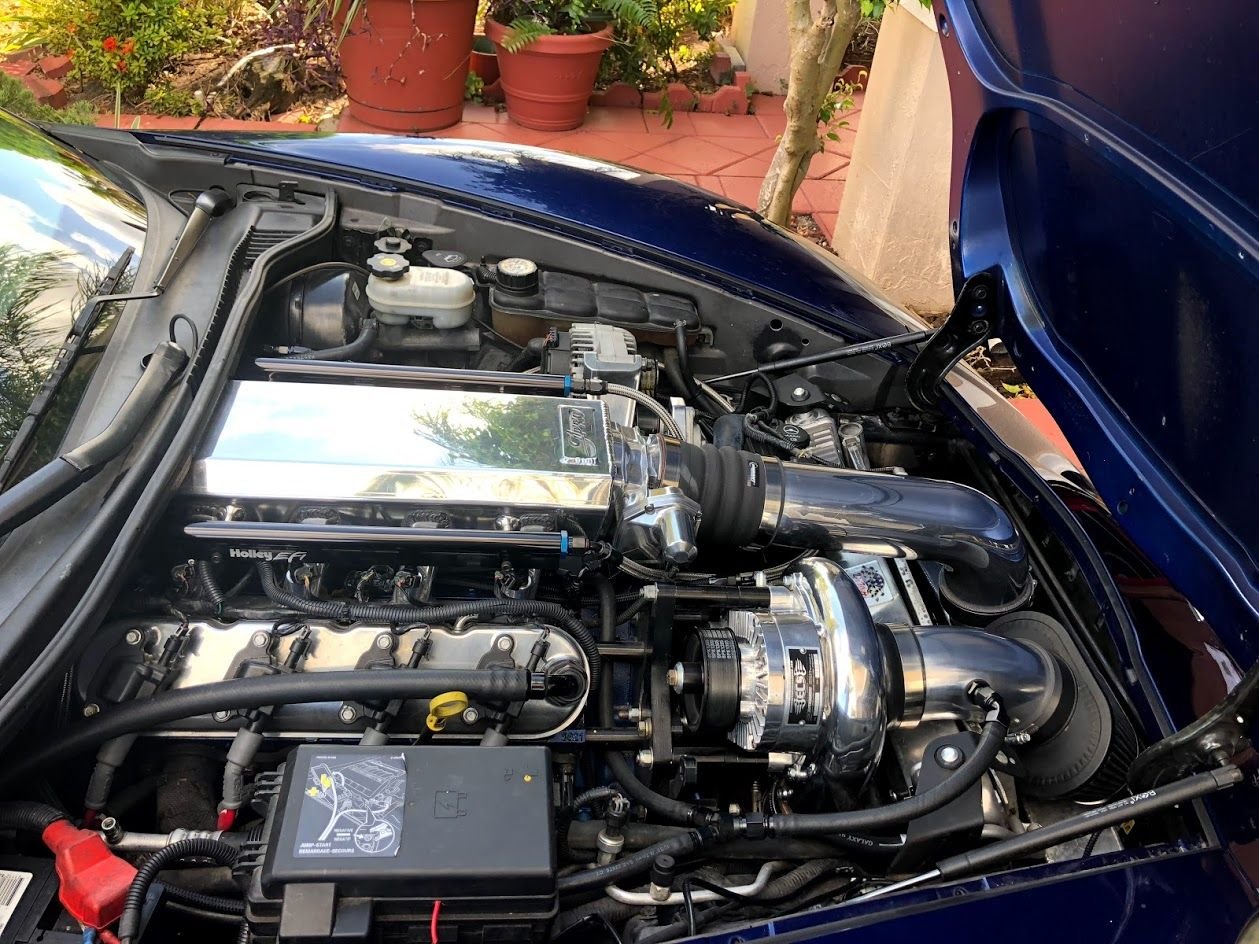

My 3 year project has finally taken shape. With the help of my good friend Ray, I have been able to make one of my dreams come true and I'd like to share it with the forum. Many long hours, hot days, busted knuckles, and "let's drop the frame again" because of a pinched oil pickup tube o-ring, has resulted in this.. Enjoy:
416 LS3
2200R 3" pulley
IW 8" overdrive
Methanol
93 Octane
G1Pro Intake
LG 1 17/8th headers
Car made 888/784
80% Injector duty cycle w meth
Video:
Special thanks to Rich at Redline Motorsports

It really is. It did wonders to my mid-range. The party starts at about 4K in this car and pulls extremely hard to around 6200. I wanted a low revving motor that made a decent amount of low end torque. A lot of that has to do with the runner length in the manifolds.
I also had James weld in bosses for direct port meth injection. Right now I have them plugged, but If I ever needed it, I could spray there too:

I'd stay where you are. For me, it was a matter of not wanting to do it twice. At the same time, I wanted direct port meth injection. Well, at least the option for it. I'll eventually put some trick flow 255s, 2" headers, bigger injectors and the 2.75 pulley. My boost should remain close to where it is with the 3" pulley...right around 18 psi.

I was never impressed with my G1P intake. Then again I had one of the first ones, so maybe they got better. Fit/finish/quality/reliability were all poor.
3"/8" on that blower should be 1000rwhp worth of air, so I would double check some stuff.

Jodi made well over 1000rwhp through a filter, on an automatic, with a 3"
Any solid 2.7 combo I've seen made well over 1100, mostly in the 1140-1180rwhp.

Different dyno's put down different numbers and as long as the car is running solid so be it, but I have to agree with you. I have never had a 2200R/X combo make less than 1000, those are more 2200HD numbers. Not knocking your build slow goat, just looking to make sure you're getting what you should from your build.
