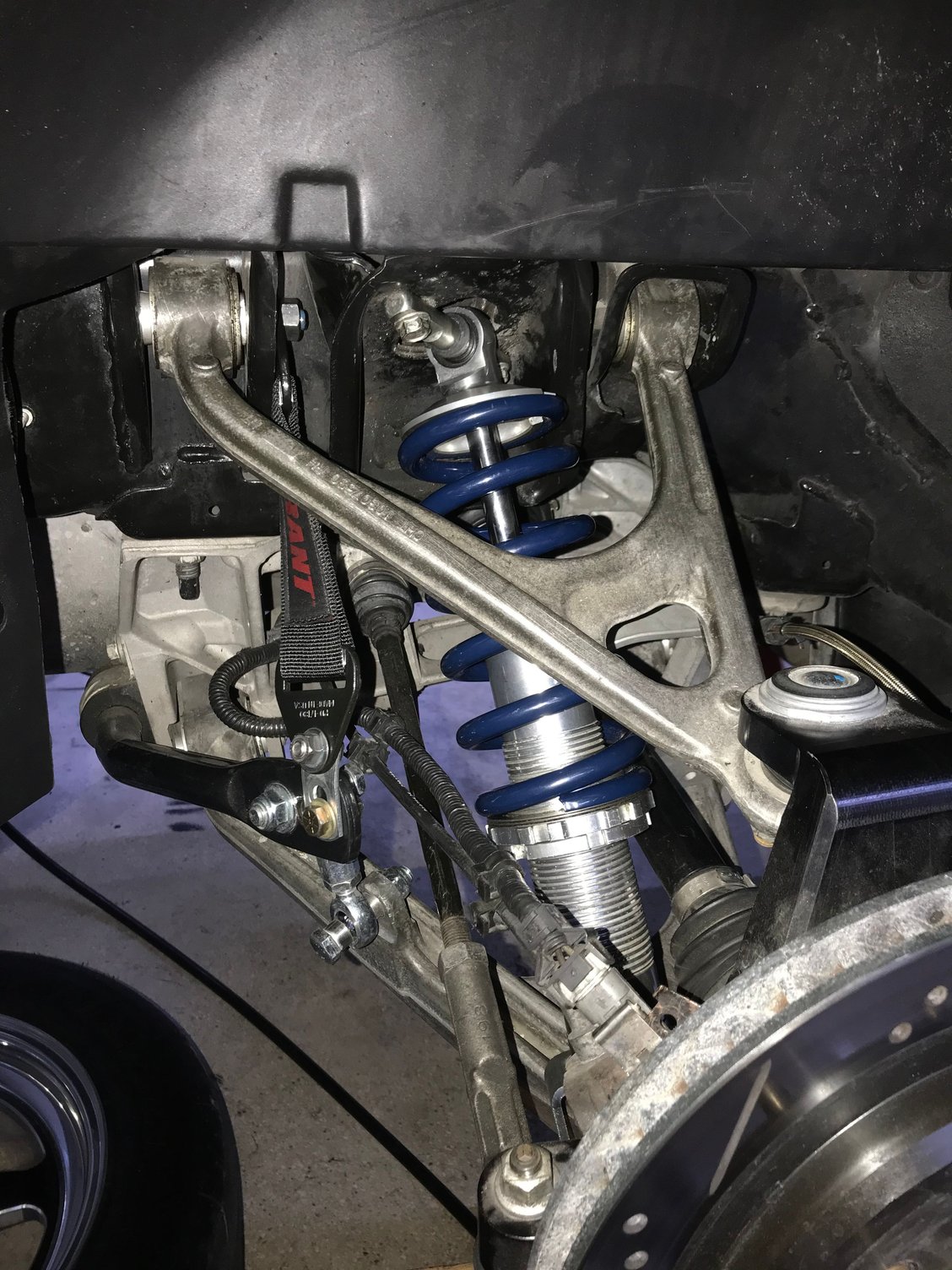

I removed my OEM rear shocks and leaf spring and replaced them with a set of Viking 'Warrior' series coilovers.
The thing is, the Viking coilovers have an adjustment for spring preload, but there is no adjustment to set the ride height ...
Look at this 'BC Racing' coilover in the photo below. You can see the 2 locking rings directly below the spring. I guess you could call them the 'Spring Preload Adjusters'. You screw them up until the spring has a certain amount of preload when the shock is fully extended.
Then, below the 2 spring preload adjusters (locking rings), there is another ring that gets loosened and the bottom shock mount is rotated (screwed in or out) so as to shorten or lengthen the shock. Then that ring is tightened down ... This adjusts the ride height ...... See below:
_____________________________________
Now, look at the Viking coilovers in the photo below ... They too have the 2 spring preload adjusters (locking rings) that you adjust the spring preload with, but these coilovers don't have any adjustment for setting the total length of the coilover ... so there is no ride height adjustment.
The problem is ..... With the Viking coilover fully extended, you first adjust the locking rings (preload adjusters) so as to get a little spring preload. But, when you remove your car jack and put the full weight of the car on the suspension, you find that it sets too high.
The only way to get the ride height lower, is to take all the spring preload out ... In fact, with my car, I need to loosen the spring up so much that with the car jacked up, and all weight is off the rear suspension, the springs have so much play in them that sometimes the upper spring retainer cap falls out.
I can't understand why Viking would manufacture coilovers like this ?
Am I doing something wrong here, or don't understand whats going on ?

Ridetech is the same way.. On my car with heavy springs (750-850#) we had the same issue of the springs coming loose. I installed Hyperco helper springs and spring dividers. They keep tension on the main springs when jacked up, but collapse completely once the weight of the car is on them.

I would not lower the spring rate to set the height.. You may be ok at rest, but it will be too soft at speed.
As long as you are within the coilovers rated ride height (Ridetech is 1 to 1.5" lower than stock) you should be able to adjust as needed. We get my car near perfect front to rear and corner balance without separate height adjusters.

Ron, that’s how they work, unfortunately. Mine are the same way, and even when I put the new 425# on the other day, I still had to lower the spring seat below beyond the point where there’s preload on the spring at full extension, in order to put the car at the ride height I wanted.
It’s only an 8“ spring, and although there’s a lot of threads on the shock body, you can’t use a longer spring (unless it’s a very low tension 9”) because the spring seat will collide with the axle. Ask me how I know. I have a pair of 10” 400# springs that I tried to fit on my car, to cure this very same problem, and that’s what happened, and I had to pull them off again. Maybe if they were 9” springs, they would’ve worked - maybe.
BTW: You could actually use a lower pressure spring - even a 400 p.p.i spring won’t result in a significantly lower rate than the stock leaf at the wheel, per the Borg Motorsports table that I posted on the other thread that I started a few weeks back. But, that might still not cure the problem. It may be that the shorter series of Viking Coilovers don’t have this issue, but mine (which are the stock to 1.5” lower Crusaders) do, even with the 425# springs. What I did was put a limiter strap on it to keep the coilover from fully extending, which I needed to do because with the Carlyle 15” conversion spindle, the upper control arm crashes into the spring at full droop when I jack the car up. (Picture below)
Here’s the thing, unless you’re using your car to jump over hills or speed bumps at high speed, you will never unload the springs enough for them them to come off the seats, unless it’s when you jack the car up. That’s why most folks don’t care about or even notice that the spring is a bit loose at full suspension droop.
However, if it bothers you, the easy and cheapest thing to do is to simply take the coilover springs and seats off the coilover and convert it to just a shock and use it with the stock leaf, like I ended up doing with the front of my car. Trust me, you won’t be compromising the performance of your car, since the important thing is that you have a good double adjustable shock, which you would still have.

I think you’ll be fine. I’ll let you know how my car works with the 425# hyperco springs vs. the 650# that I removed recently and compared with the original 450# Viking springs. I feel bad that I advised you to get those 500# springs, although everyone seems to like to go higher than that on their coilovers.
I note that the Van Steel QA1 coilovers have the helper spring too, as well as the adjuster ***** up top, Since the shock is mounted inverted, which I personally like better. I just can’t figure out how they are able to work without hitting the axle, since form the photos on their site, the spring extends down almost the full length of the shock. Maybe they adjust them higher on the car?
Nice looking car, BTW. You have yours a bit lower than mine. You might have to be careful that those bigass drag radials don’t rub the fender liner when you launch it. When you run it at the track, try setting the rebound a tad higher, like at 6 or 7 and leaving the compression at 3.
EDIT: Actually, forget what I said above about the tires rubbing the inner liner. I just realized that you have the 28” radials on the car in that picture. The 305/45/17s are actually about only 27.75” dia. anyhow. That looks to be very close to the ride height I have in the rear. My 275/60/15 Hoosiers are ~28.25” and they didn’t rub the liner at all with the 450# springs, even when it bumped the front wheels off the ground:

Whilst the helper springs would solve the problem, they might result in extending the spring seat and locknut so much lower down on the shock body that they may hit the axle, which would not be good. If look at the picture that RecMech posted, you’ll see that those two things take up approximately 2” of space when the helper spring is fully stacked.
Now, I personally have tried to fit a 10” spring on my Vikings and I could not get them to work, because I had to adjust the spring seat down so low that the seat and locknut was exactly where the axle was. Now, I do remember saying that a 9” spring could work, IF it was light enough so that the adjuster nut had to be adjusted upwards above the axle to get the right ride height. At the time, I had figured that a 9” 400# spring would have fit the ticket. I abandoned that because I became erroneously distracted with the idea that I needed a stronger spring, which turned out to be a failure, because it was hitting the tire too hard and not allowing the rear to squat at all. Now, you can get springs for ~$50.00 apiece from Summit, Jegs, etc. so, if you want to experiment with taking this “slack” out of your suspension, the way to go MAY just be a 400# 9” spring.
The added advantage is that you would end up with a spring rate at the wheel that‘s very close to what you had with the stock leaf spring (which you seem to want anyhow?) and it would certainly have more stored energy at the same ride height than the 500# 8” spring that you have now.
BUT, this is just a suggestion. God knows I don’t want to mislead you again with buying the wrong springs, so think about it and take some measurements on your car before you spend another $100 on springs.
