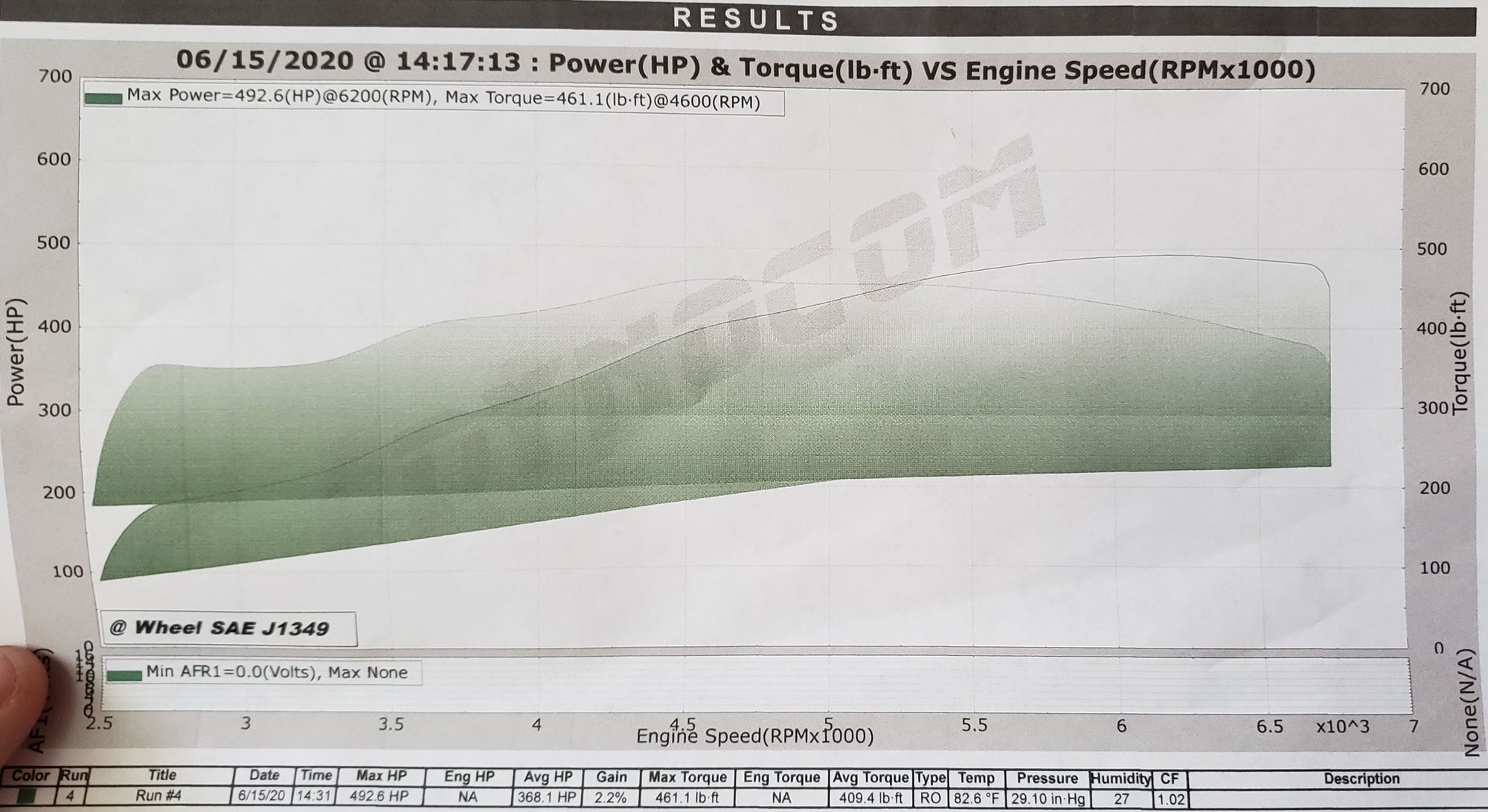

Super excited to finally get to post in this subsection. I've had my 09 base model poverty vette for a couple years now, and while it's making decent power cam only, I finally pulled the trigger on an A&A Ti kit. Unfortunately looking at a 2 week or so wait so this is more of a place holder. Tim King Racing and Automotive will be doing the installation and tune, so I'm sure it will make great power. As it sits, 09 z51 car M6. Hooker catless header back, vararam and the new iteration of TSP stage 3 N/A cam. 492/464 to the tire currently. I'm hoping for close to 700 or so with the blower and meth.
