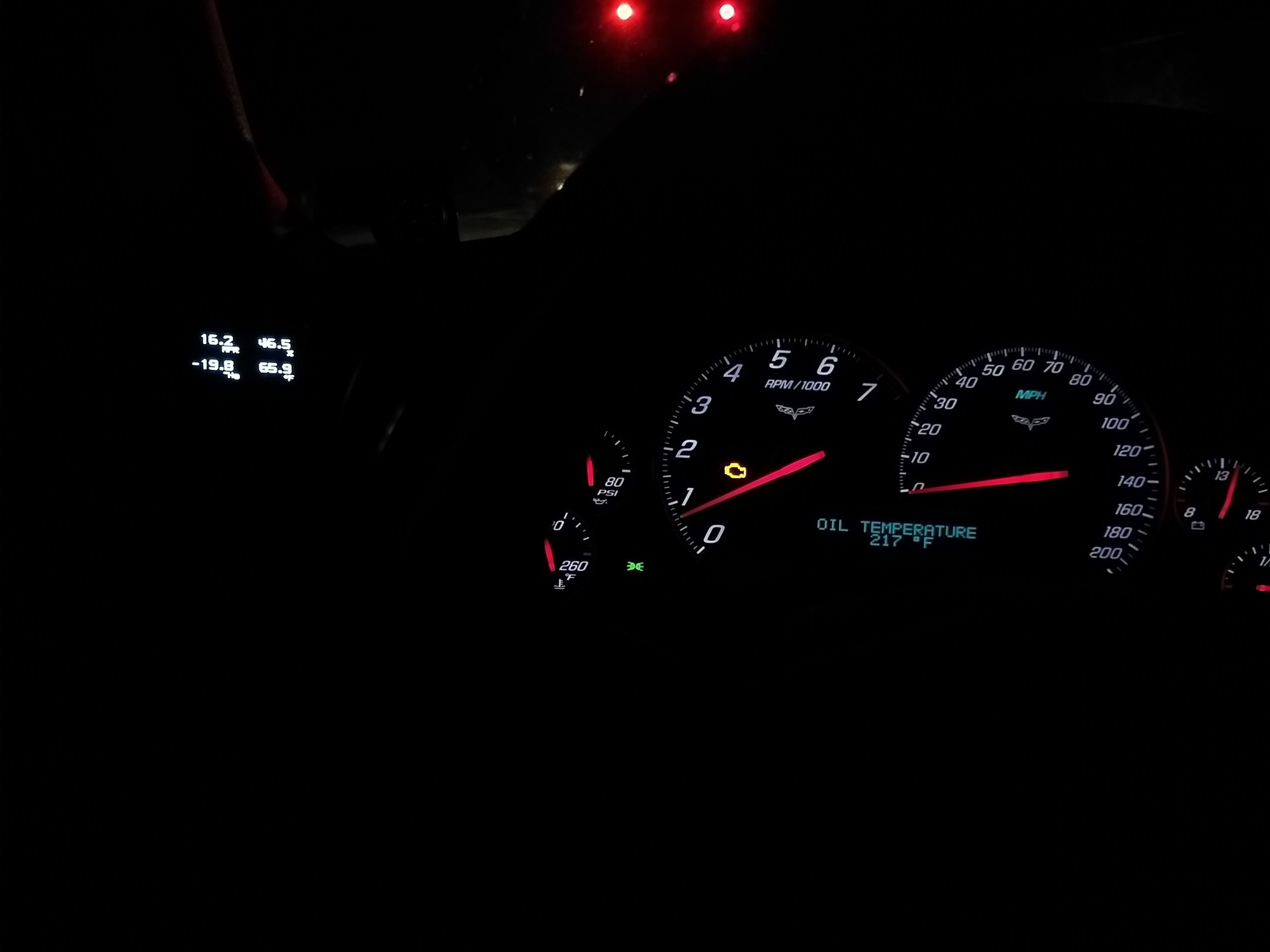

They are tight... hard to get a night shot ha... also hard to video (when my map sensor was on the fritz and sent to innovate for warranty)...Also my car isn't always dirty lol!! that was after a day road rally for charity haha and a super close up.

Which model is that and have you had any issues with it reading incorrect? I have a dual gauge pillar pod id like to replace my old boost gauge with this.

Innovate ECB-1... nope, it's great! The MAP sensor did die after 2 years and I replaced with a part from Innvovate for about $40. I made a pig tail closer to the sensor for changing them out in the future.
