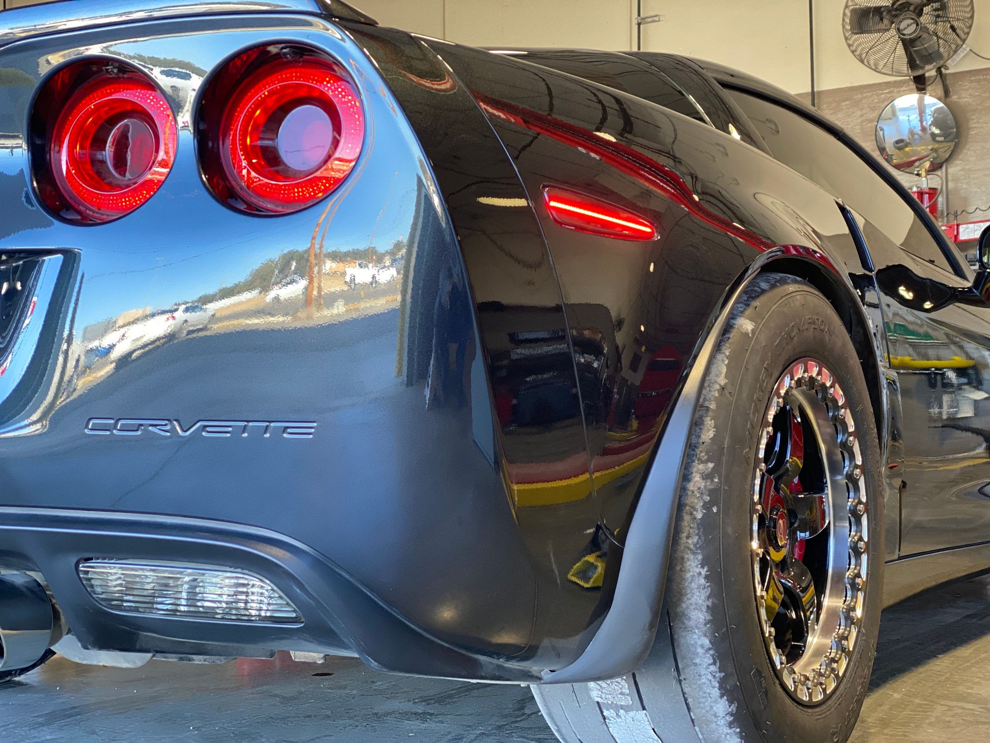

y’all are in luck. Just put mine on. 28/6/17 tire. They do rub some. Will mess with lowering bolts and see what works best for rubbing.

messed with the lowering bolts a little bit. She’s a little tight but I think this will work. Will definitely rub during sharp turns. 😕😕
