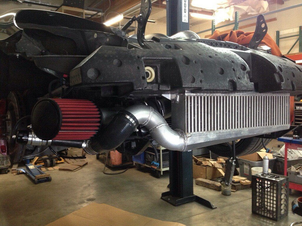

This setup resolved my heat soak issues:
Mounted it front of the crash bar huh? I like it. Thanks for sharing! Looks like it gets plenty of flow there

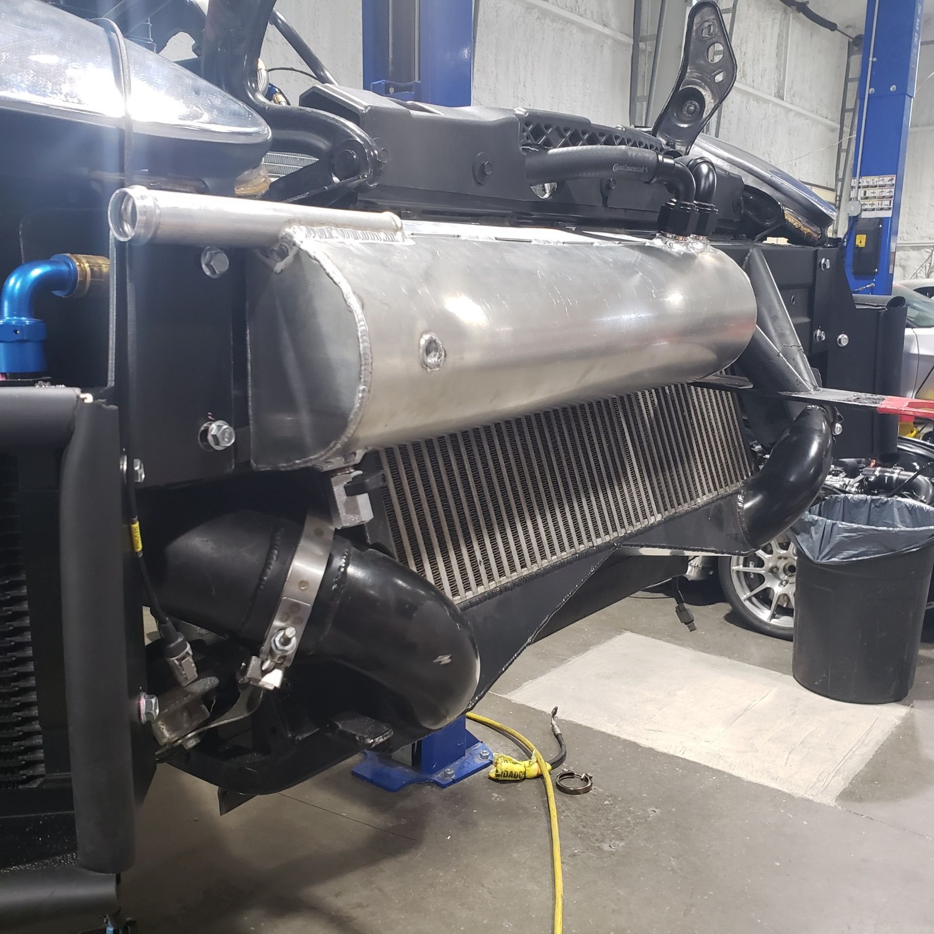

I used 2 garrett cores to make one vertical flow unit. 2.5' in on both sides and 3.5" out.

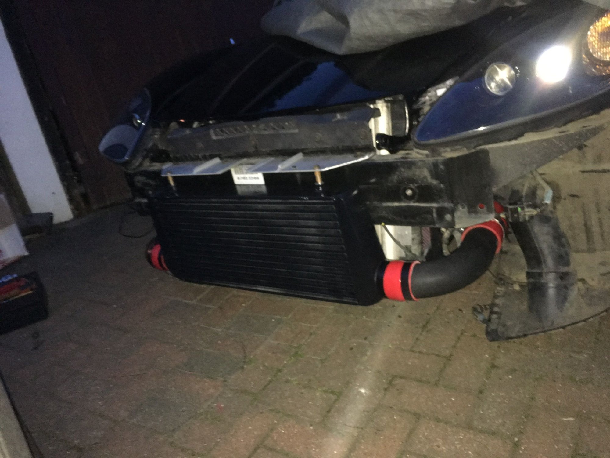

3’ core with 3’ inlet/outlet

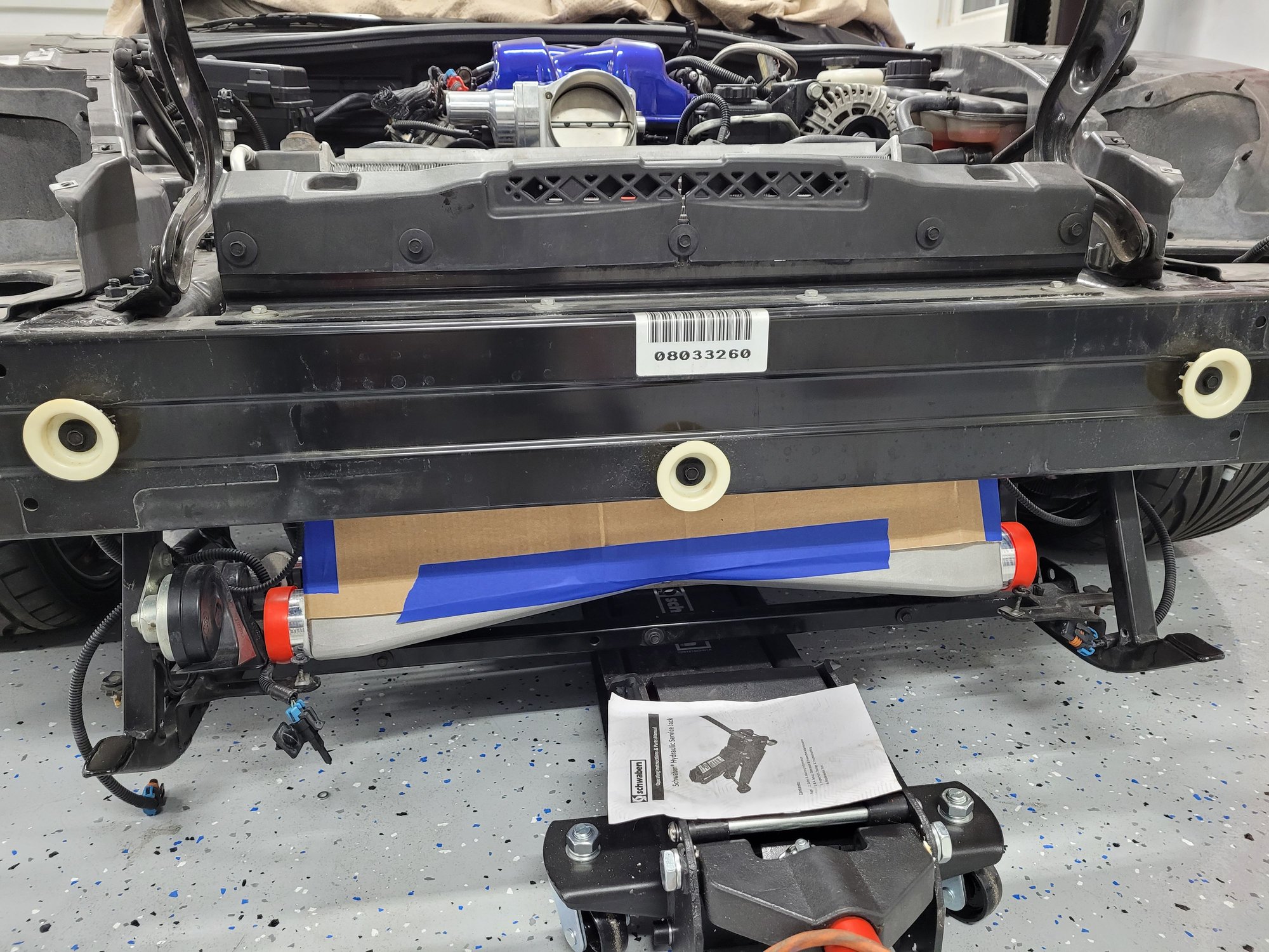

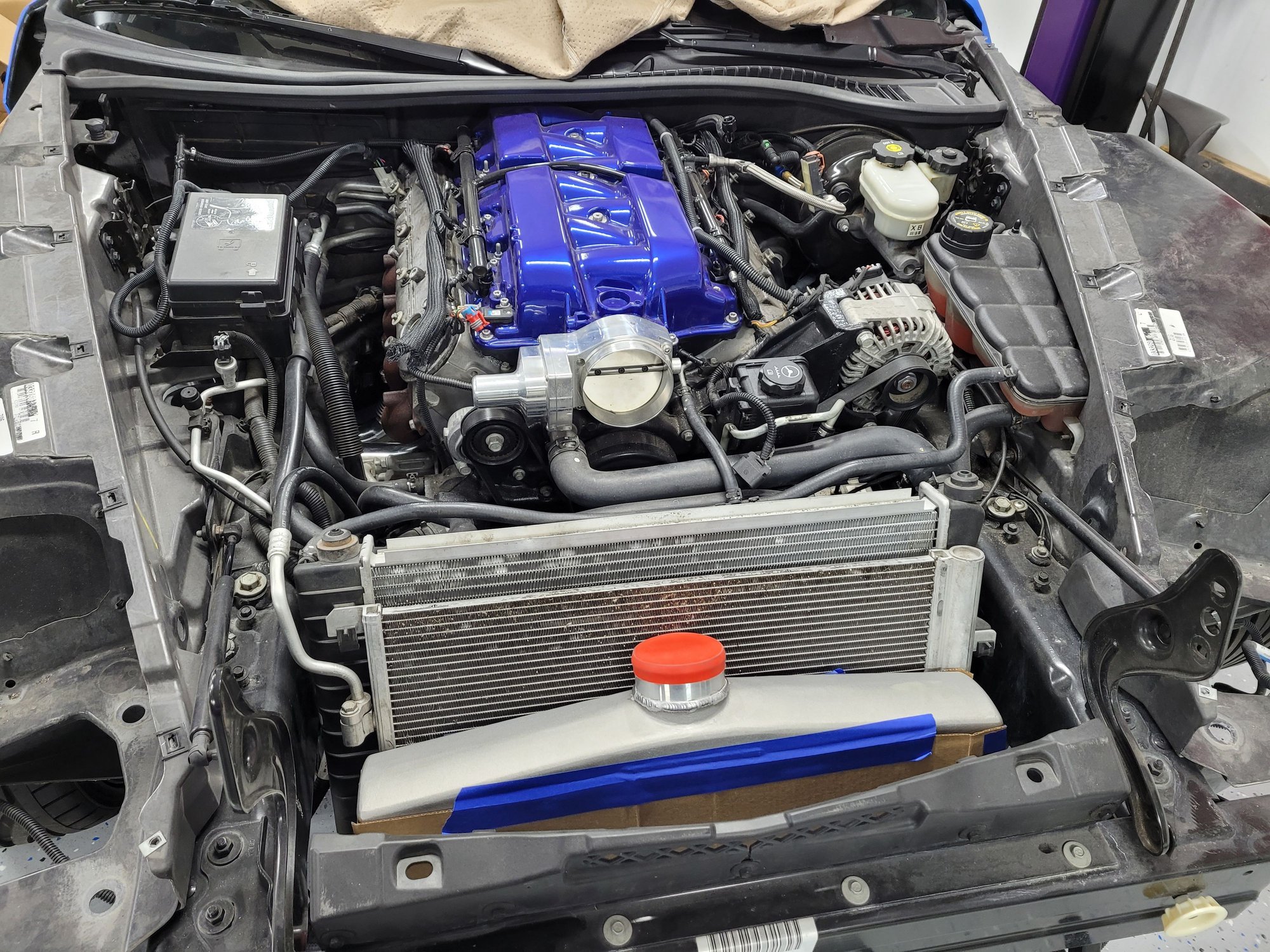

Looks like a great setup. What brand/model intercooler did you use? Did you have to modify the bumper cover to make it fit?

Notched crash bar camp here
NICE! Clean work.
