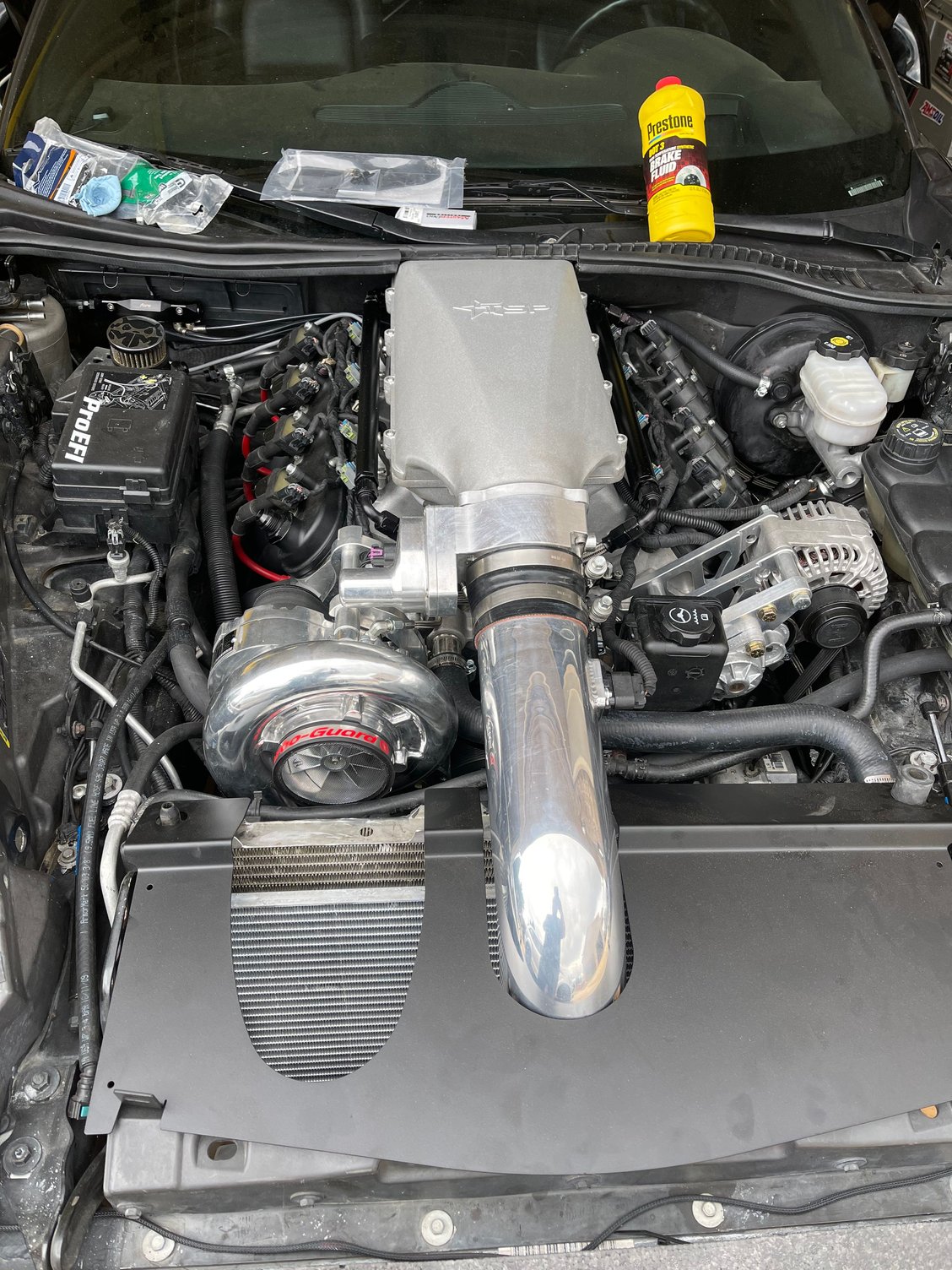

I just got my A&A kit for my LS2 c6 and with a 3.4 pulley on 91 pump it made 620. Mine is in the powerband instantly and drives like stock. Shouldn't have any problem making 700 with that big motor LS7. Couldn't be happier with the kit.

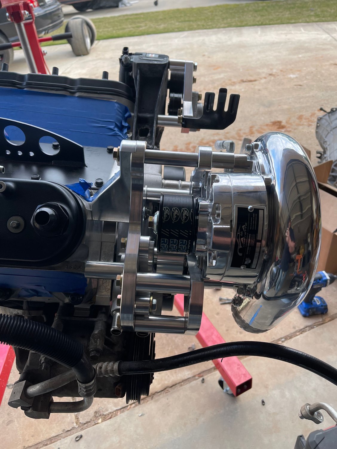

I just received my A@A bracket drilled for a Procharger and it's nice! Very nice!

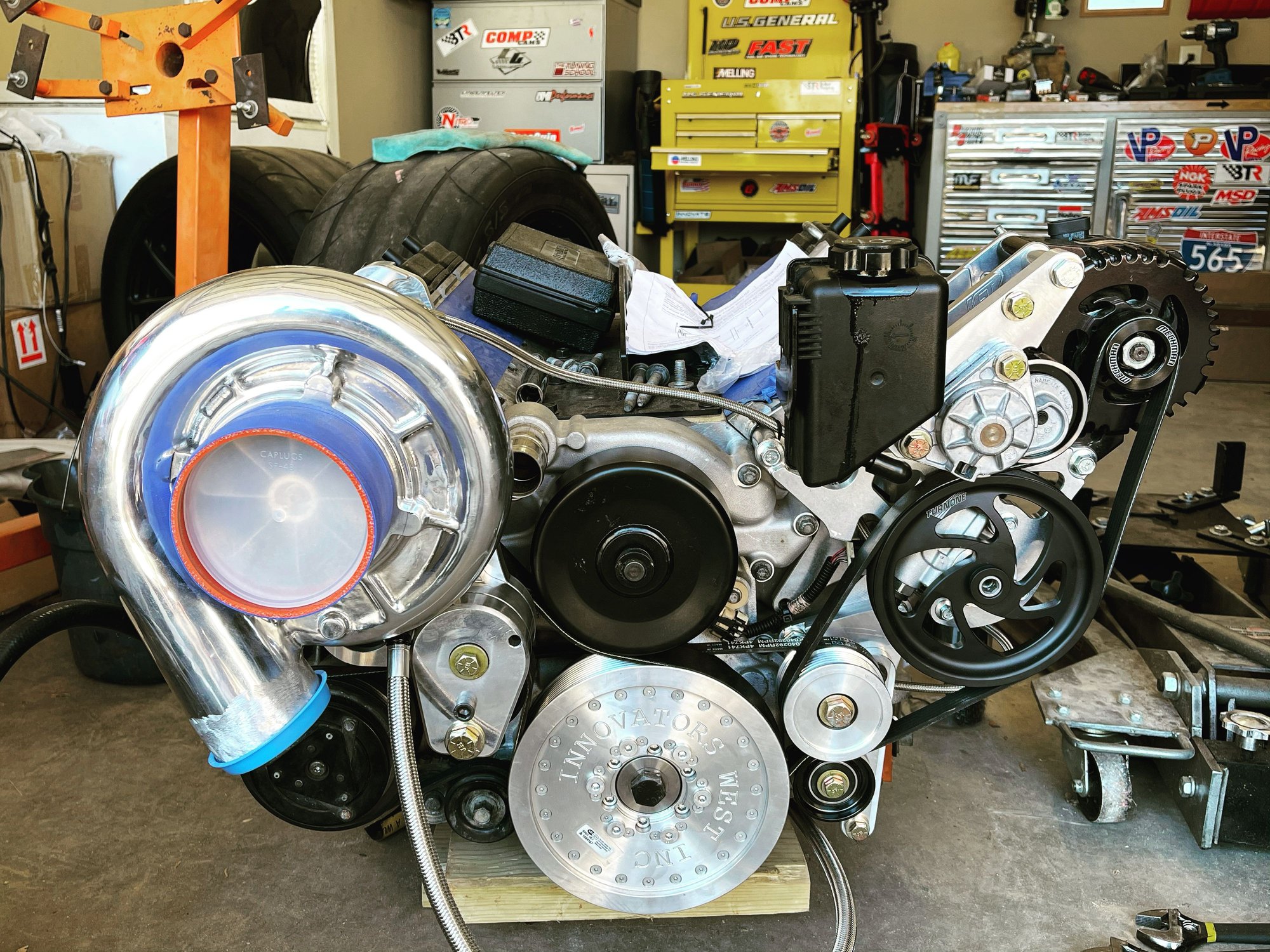

id have to agree, I’ve made over 850 with a tvs2300 and I was always plagued with belt issues and breaking idlers and belt tensioners. Pulley bearing failures….you name it. It makes a difference when you’re pushing limits or when you’re using brackets and a blower designed and engineered to make the power you want.
I just recently swapped to A@A YSI-B with their 10Rib and secondary drive and let me tell you. The quality and design is top notch. I just wish A@A would make their own alternator power steering bracket just for looks. I ended up making a billet one work.
