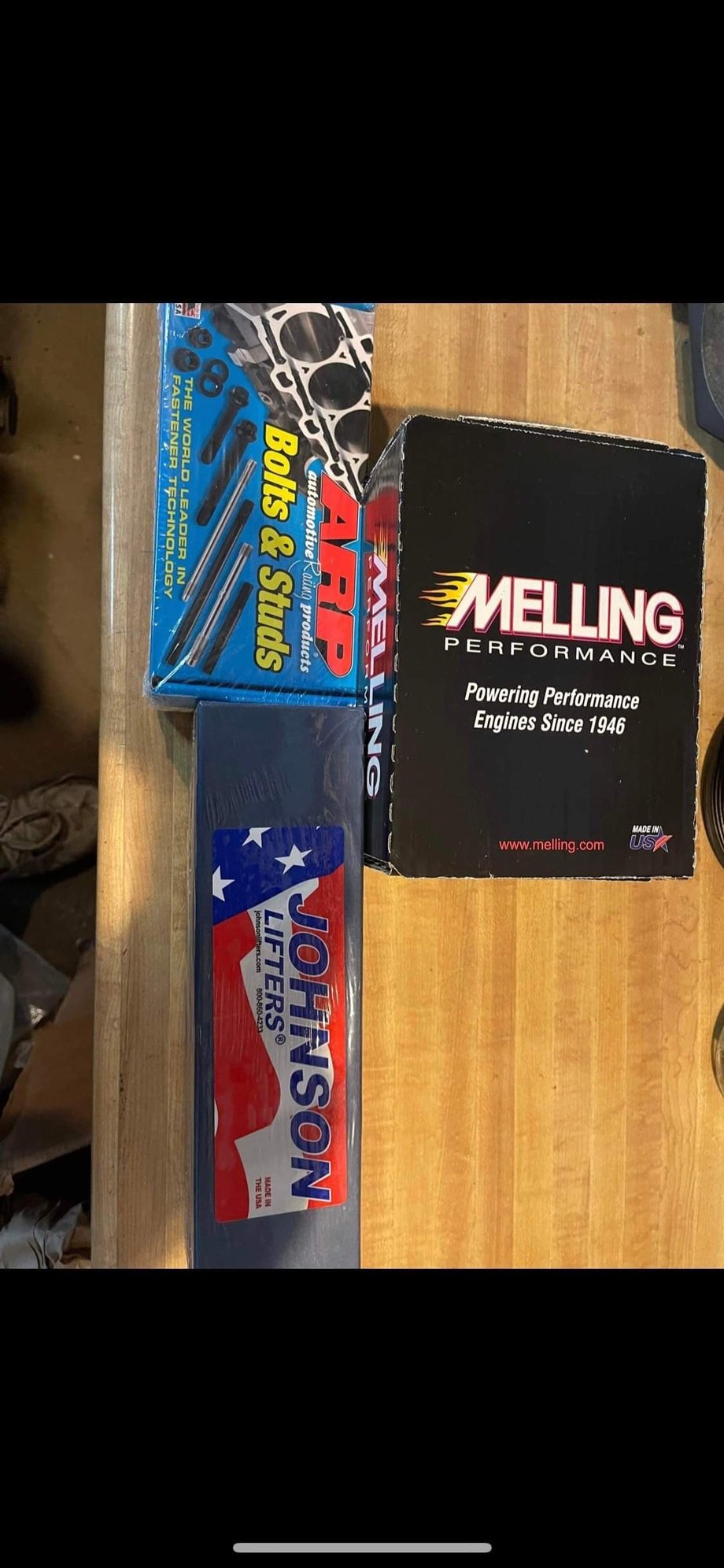

I was going to hold off on doing my cam until I got it a little more sorted out at the track but I decided I didn't want to pull the blower to get it ported now and pull it again later to do the cam. So, I'm doing a 232/248 .626/.626 117 lsa cam, 10% OD balance, Johnson 2116r link bar lifters, Nick Williams 102mm T-body and having the blower ported. Going to use ls9 head gaskets and arp studs. Also working on doing a boost referenced return style regulator.

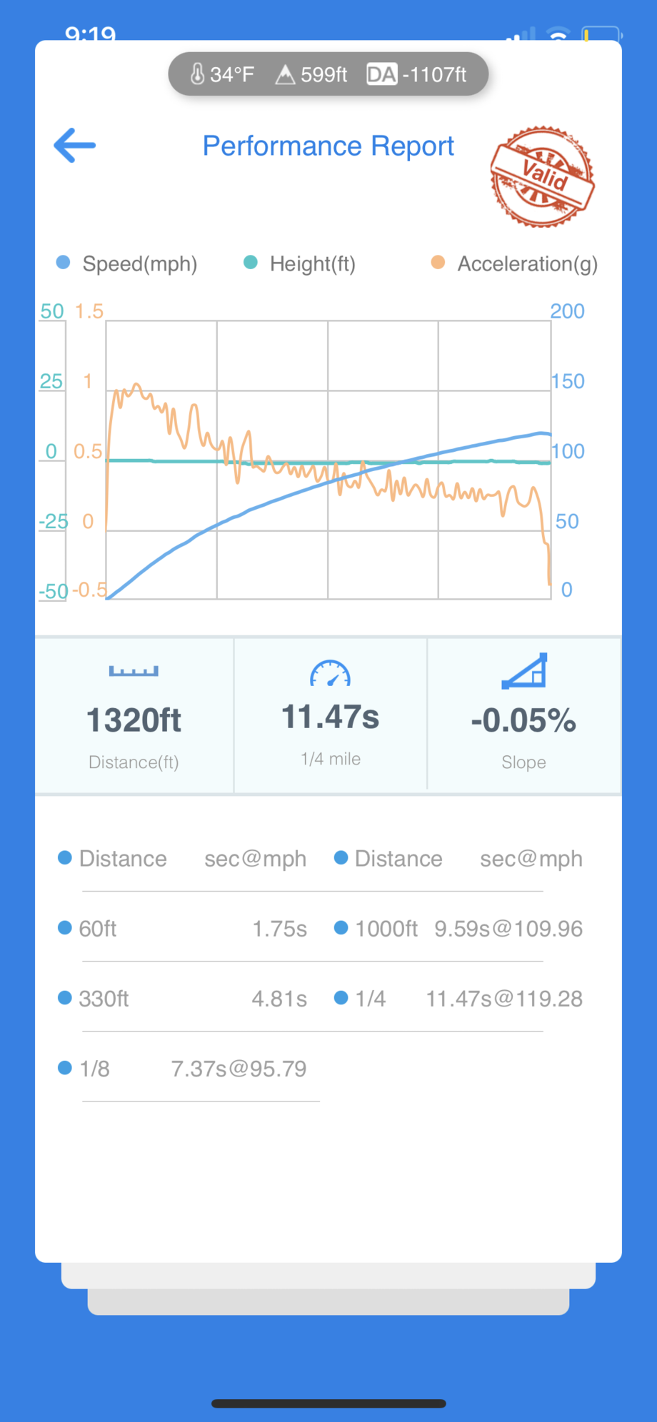

I got a new best in the grocery getter last night.
