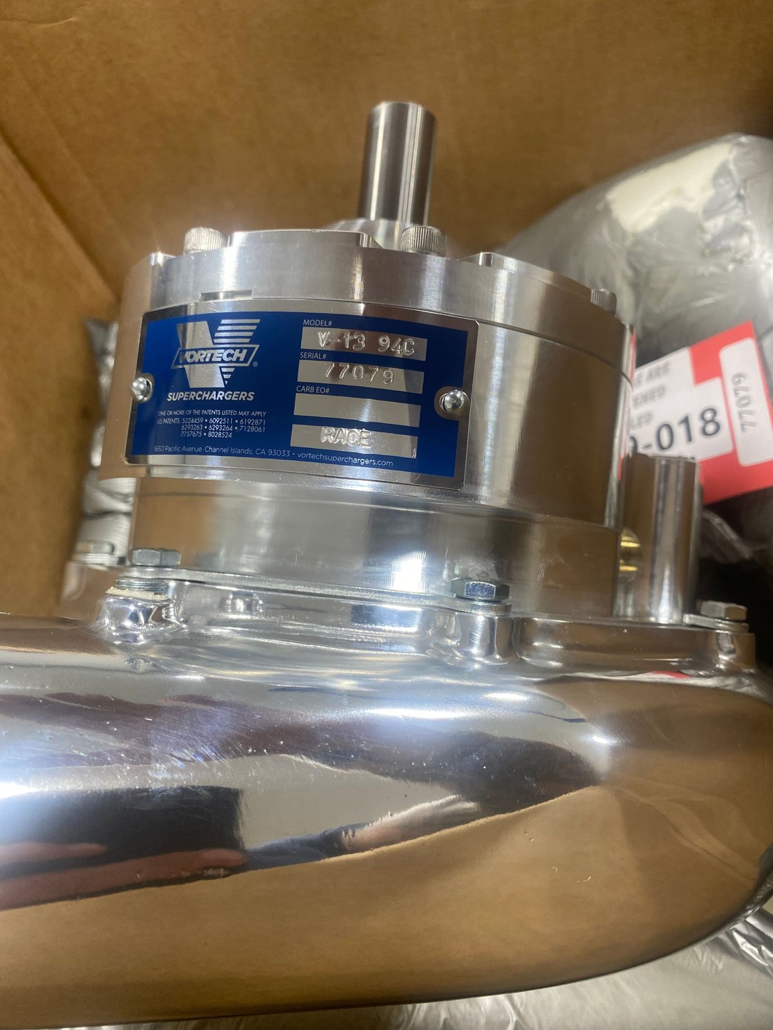

Came in today

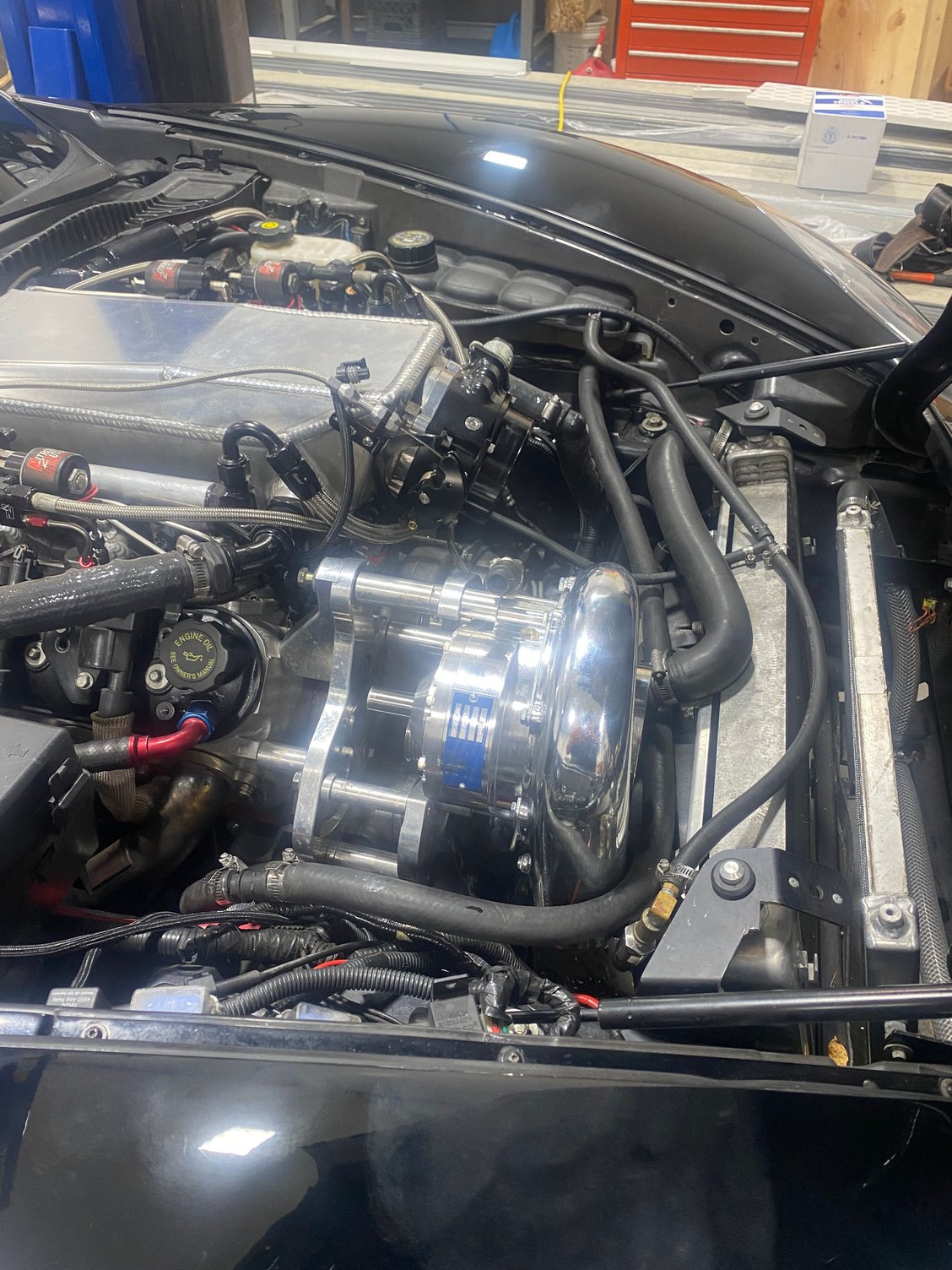

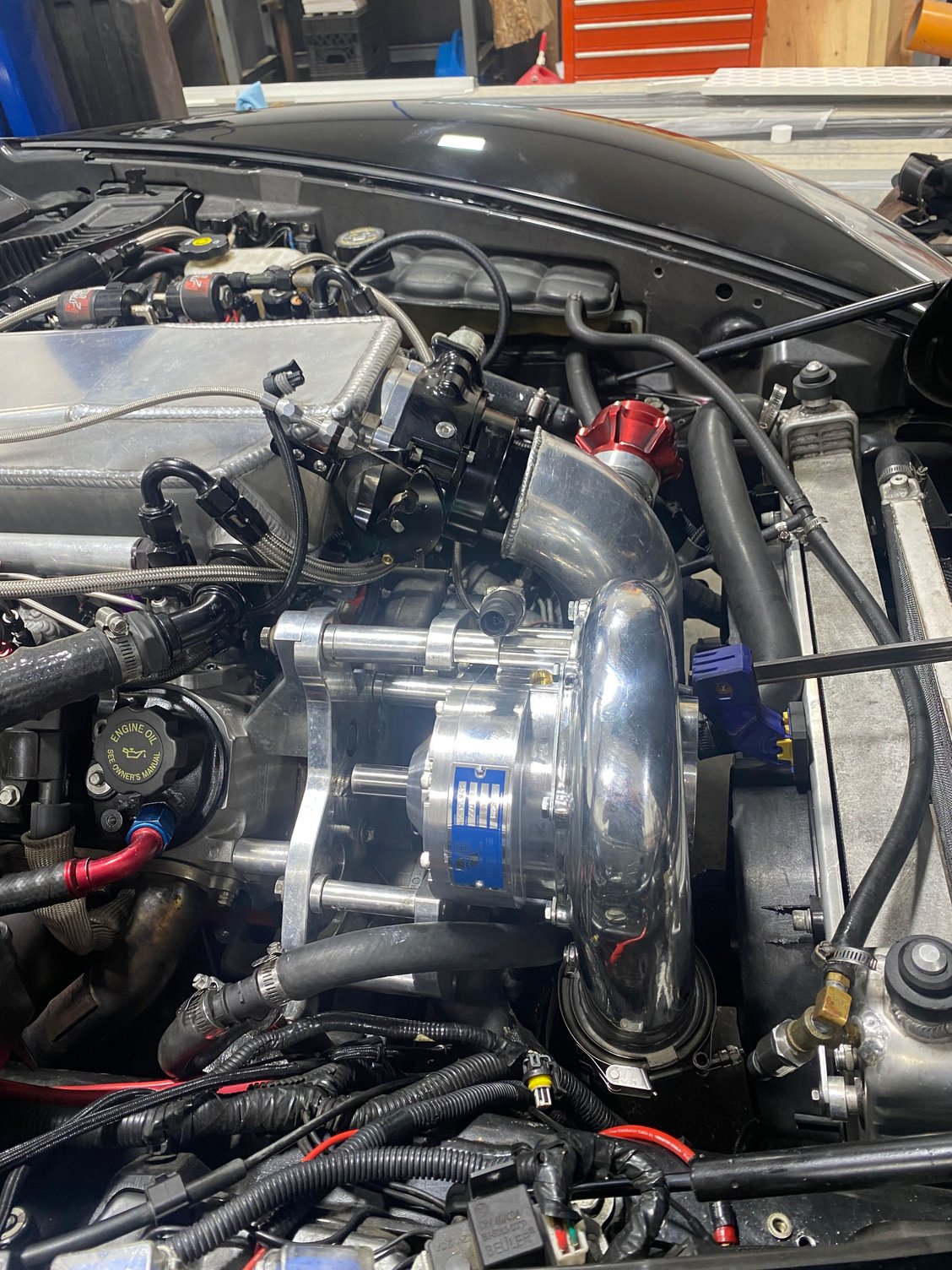

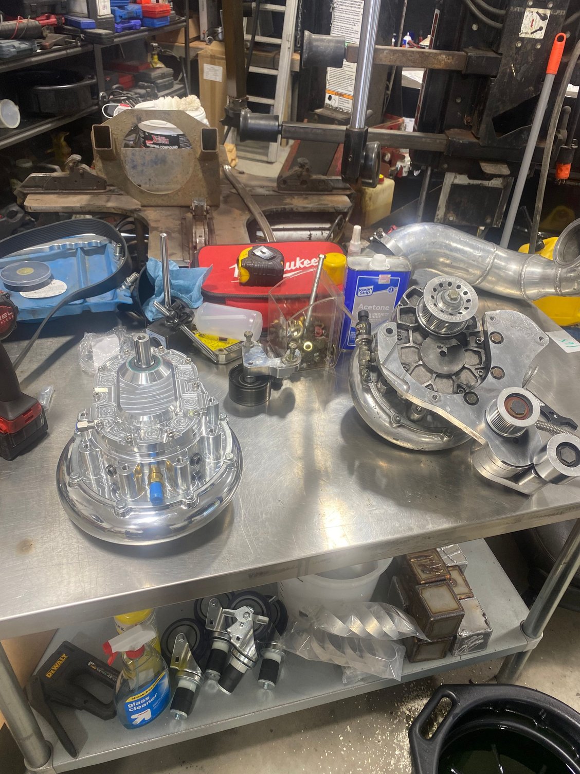

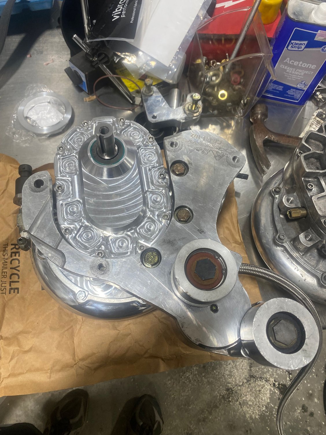

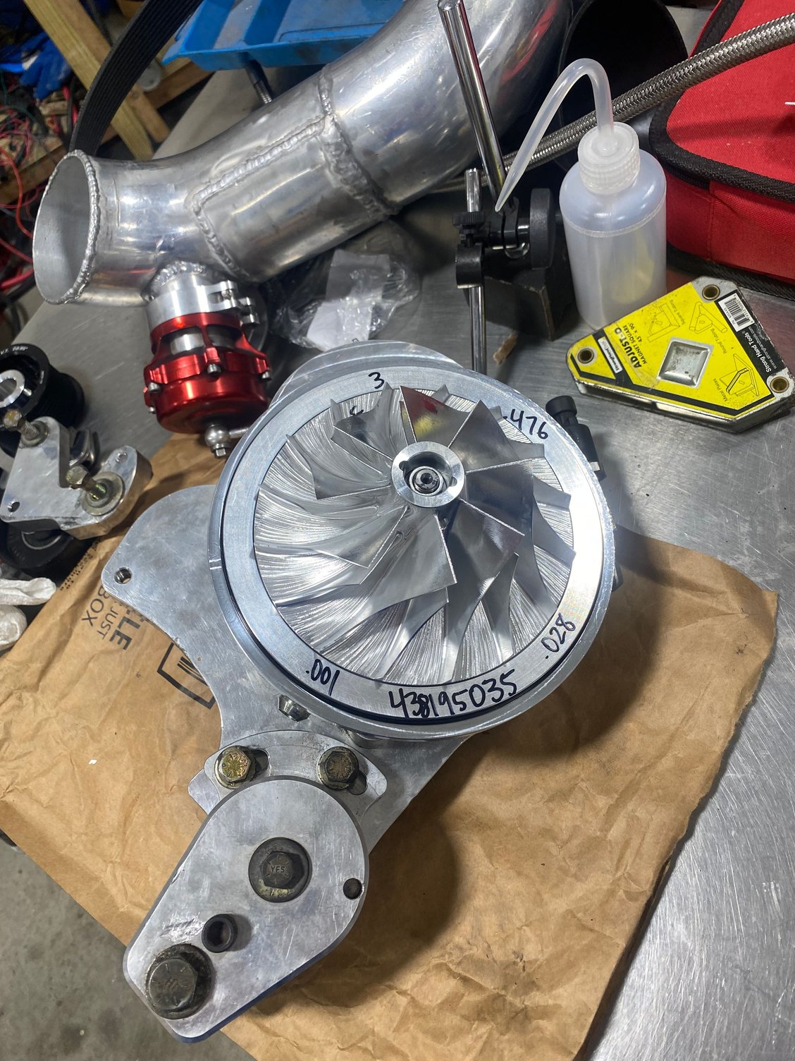

To Vortech v13

Single BOV gonna be sufficient?
Old Sep 11, 2023 | 04:26 PM
jacked cobra's Avatar
jacked cobra
Joined: Apr 2010
Posts: 546
Likes: 23
From: ny
I had 2 on it with the ysi and the second one keep cracking on the weld. Think is was from vibration. Couldn’t get it not to crack. So block it off and ran just one. It was fine on the ysi gonna try it in this one and see what happens. The only reason I even ran 2 was cause I was having a ton of problems with the drive by wire tb. But I have since switched to cable driven. It’s an auto also so not jumping on and off the throttle like a stick car. The bov is rated to 1800hp I believe.

Had to move the radiator forward. It’s on and running but small miss alignment somewhere
