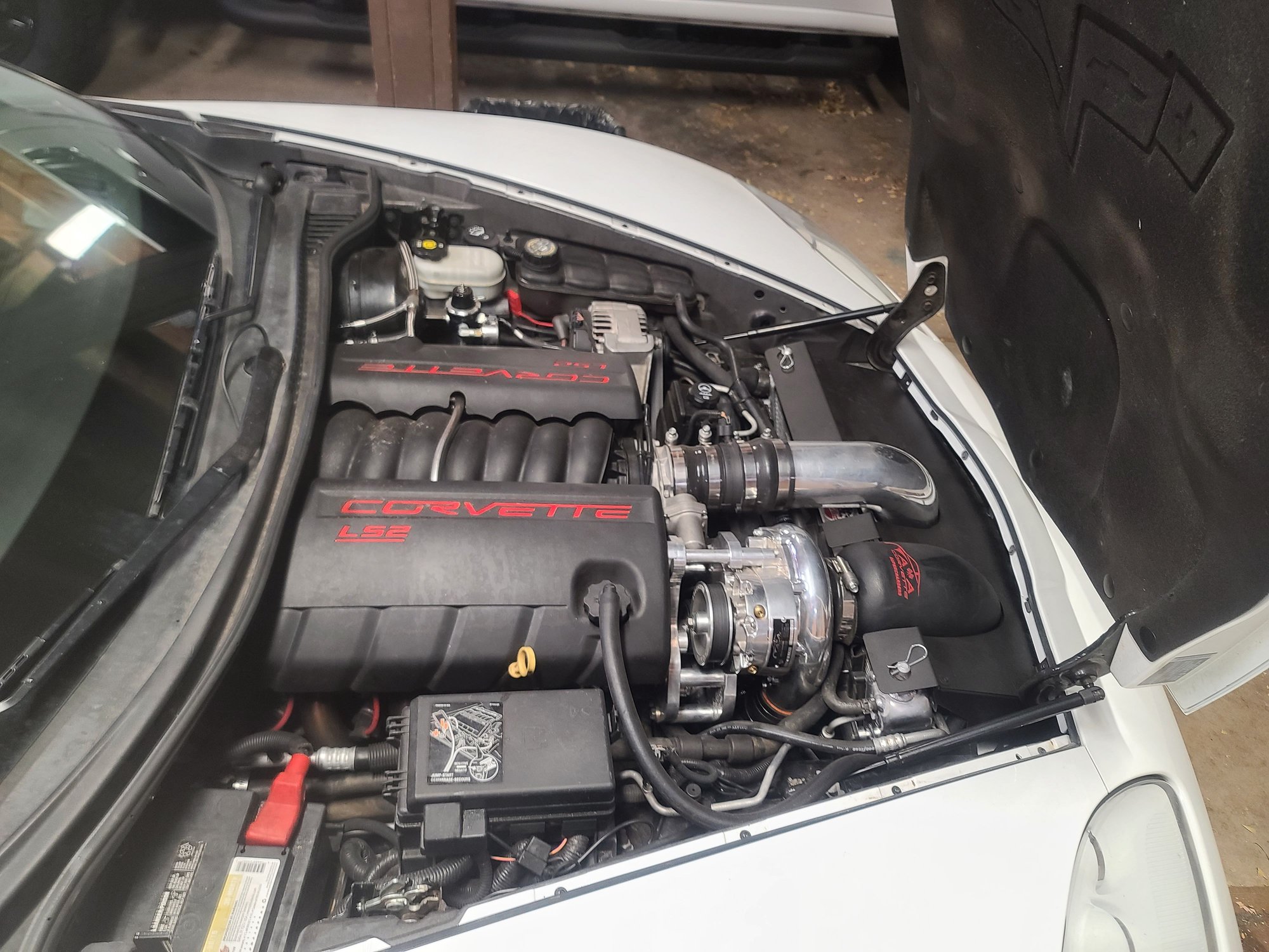

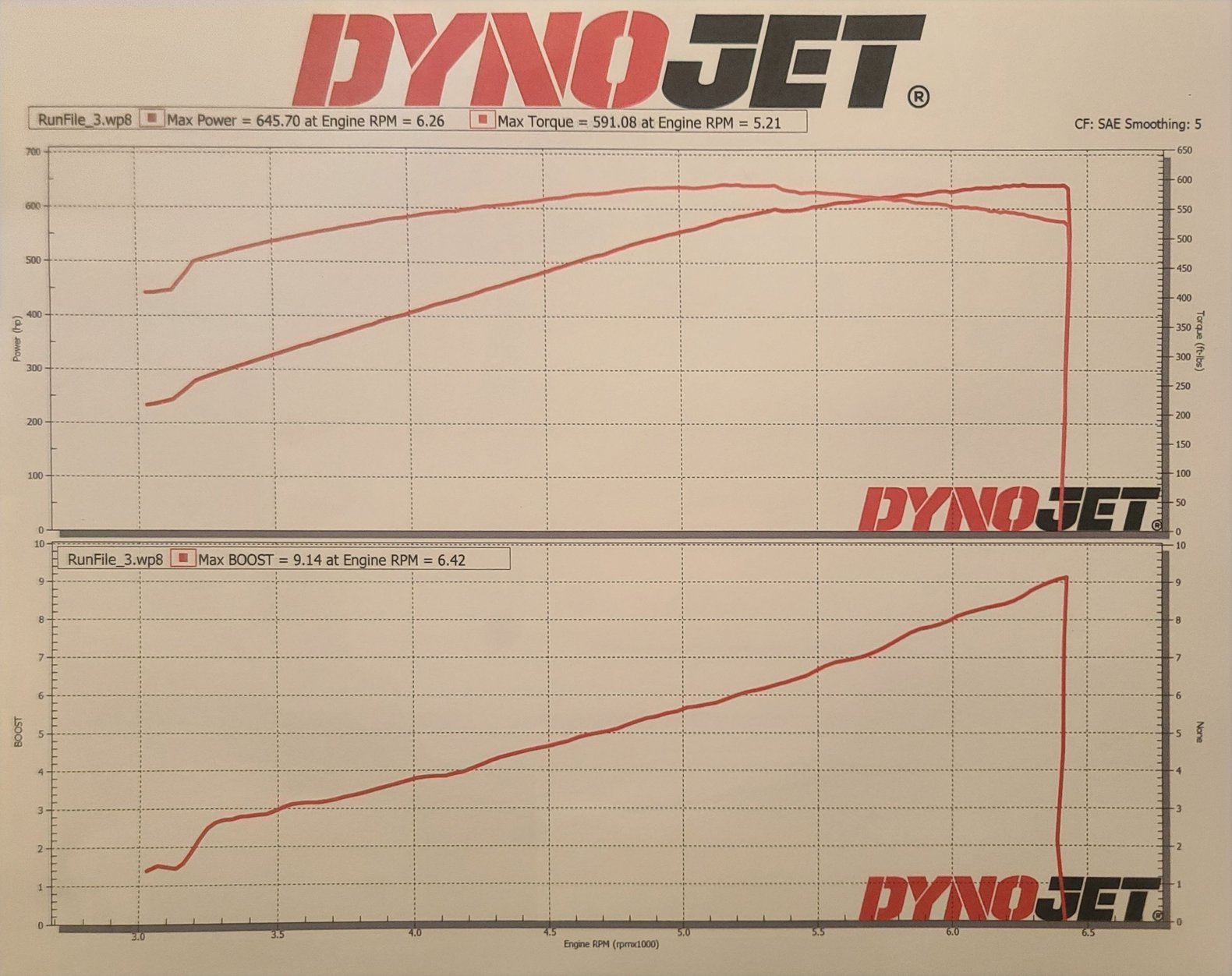

A&A ti trim, 3.8 pulley, 9# boost, kooks long tube headers & midpipe, cat delete. Btr stage 2 cam double valve springs hardened Pushrods trunion kit, dewits radiator, sfi balancer, melling oil pump, a&a auxiliary fuel pump.
not bad IHHO 645 BHP @ 5000' elevation

I already have the 3.4" pulley also. Had it on and got 670 but it was way lean. Tuner said i needed to go e85, go from single to double auxiliary pump, and biger injectors to run that pulley. Probably tune close to 750 bhp

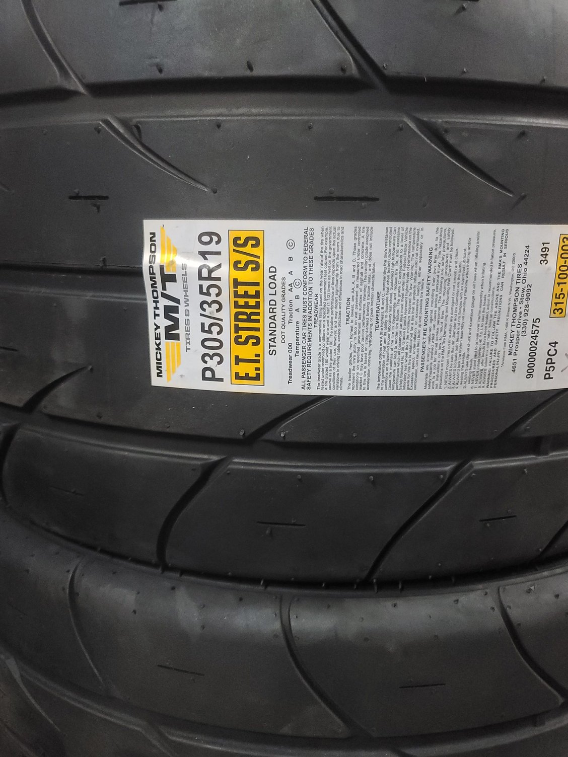

MEAT!

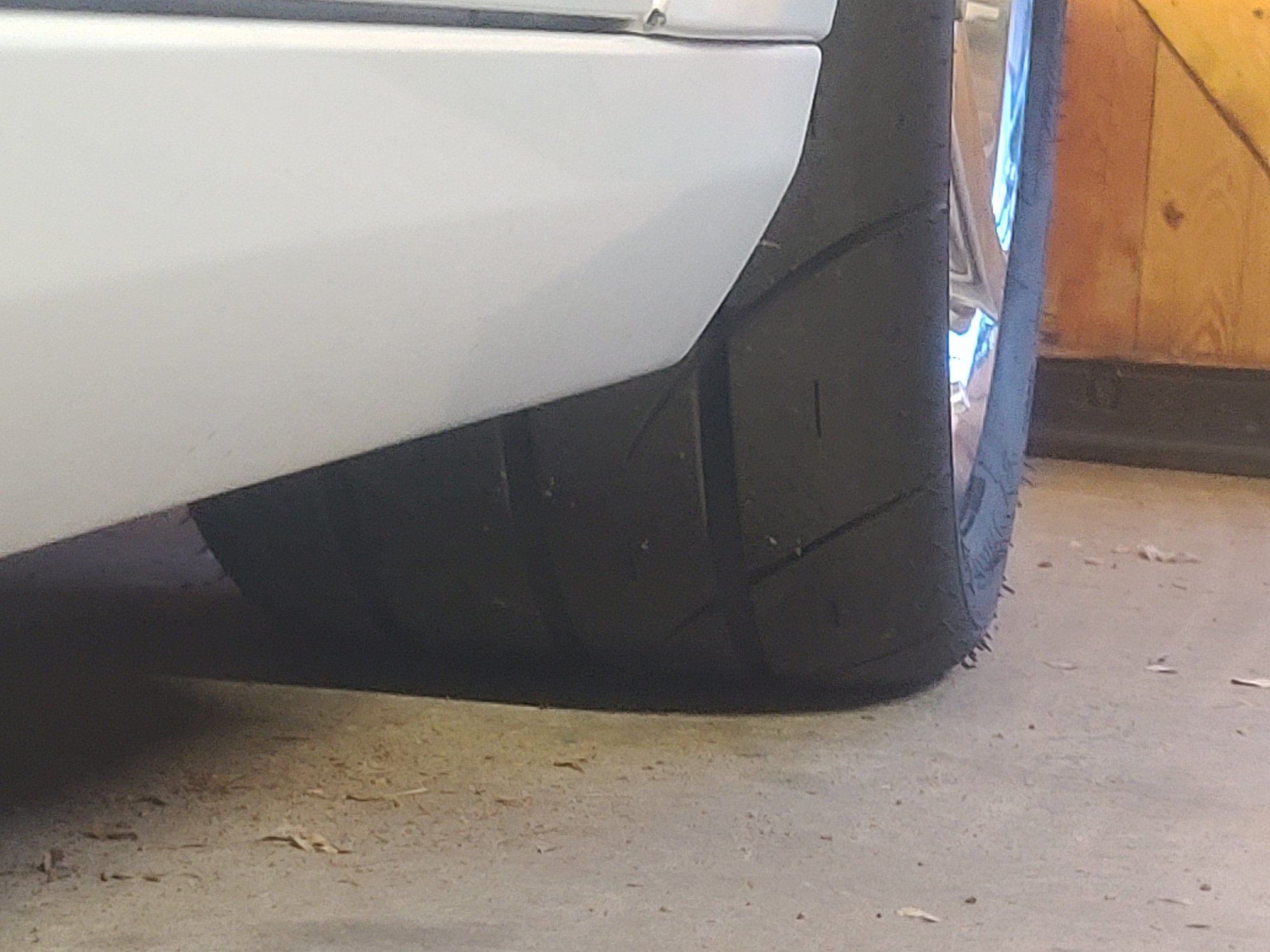

Just put these on ad it sticks at 45 now. Due to weather hant been able to go from a dig.
