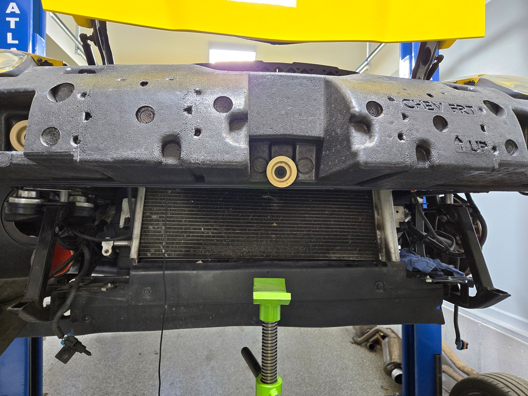

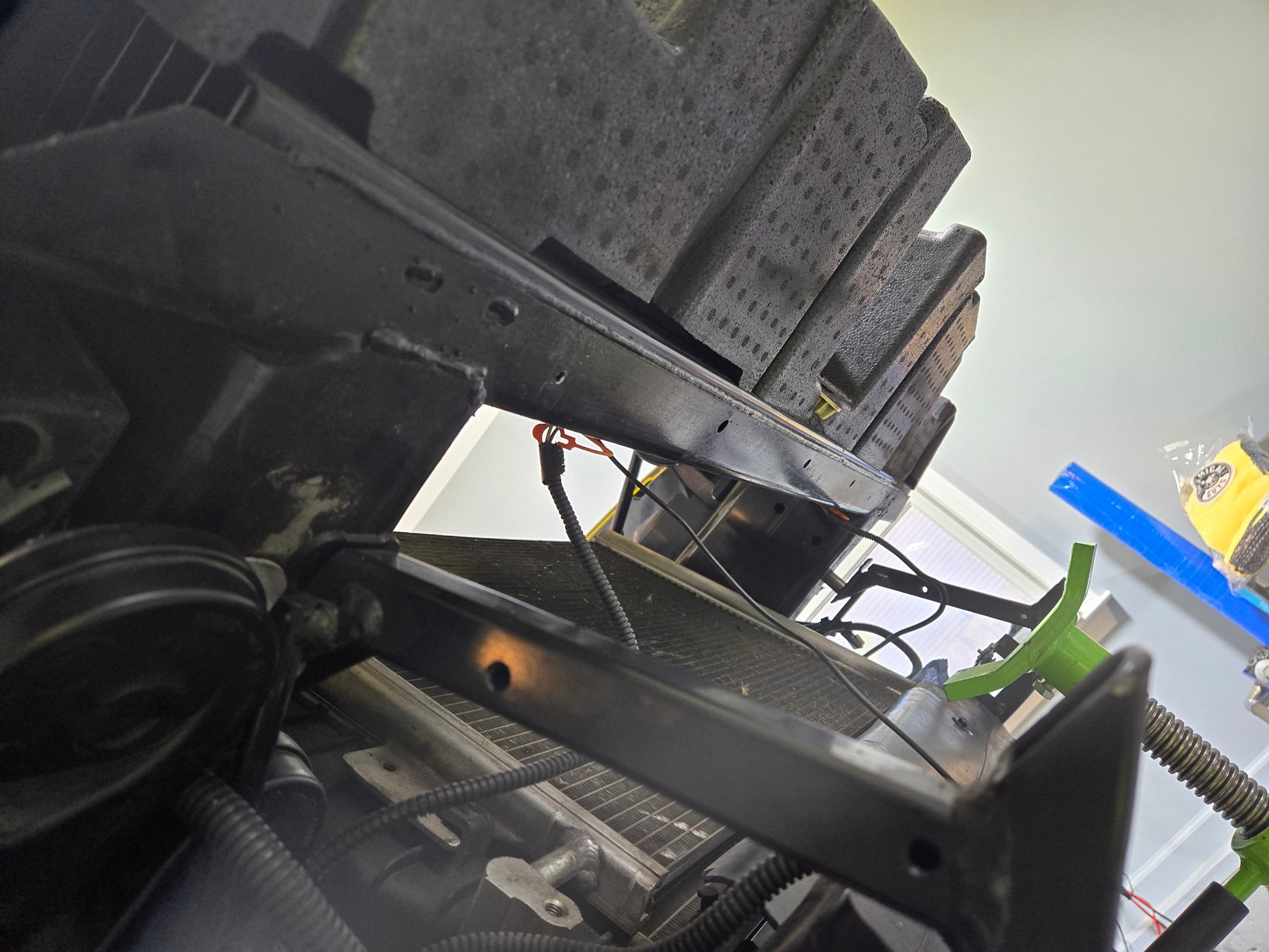

I have a built motor ysi setup 1100whp running the a&a ic. My iat get to 220* at the top of 4th after 10mins of warm up on a 60* day. So this has to be fixed and I'm not interested in using meth. So my plan is to use a vibrant core 22,11,6 . To fit this I'm going to cut out the center part of the crash bar in front of the core and rad and I'll tube it in the front and be able to fit this big core in by laying it back some like the a&a. Pretty much double the size should help bring the iat down below 200 but only one way to really find out. Only issue is the core I'm using is on back order haha.
Theres 6in of space from the ac to the crash bar already.

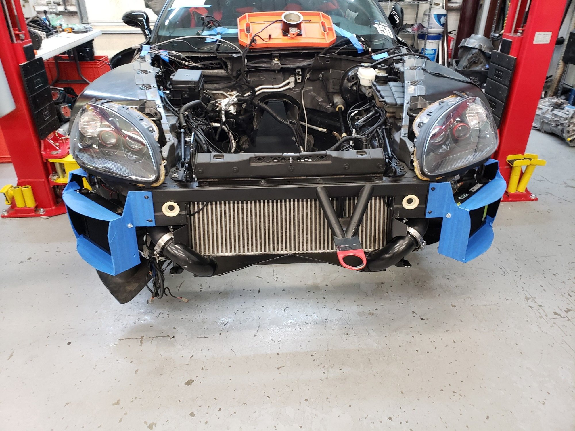

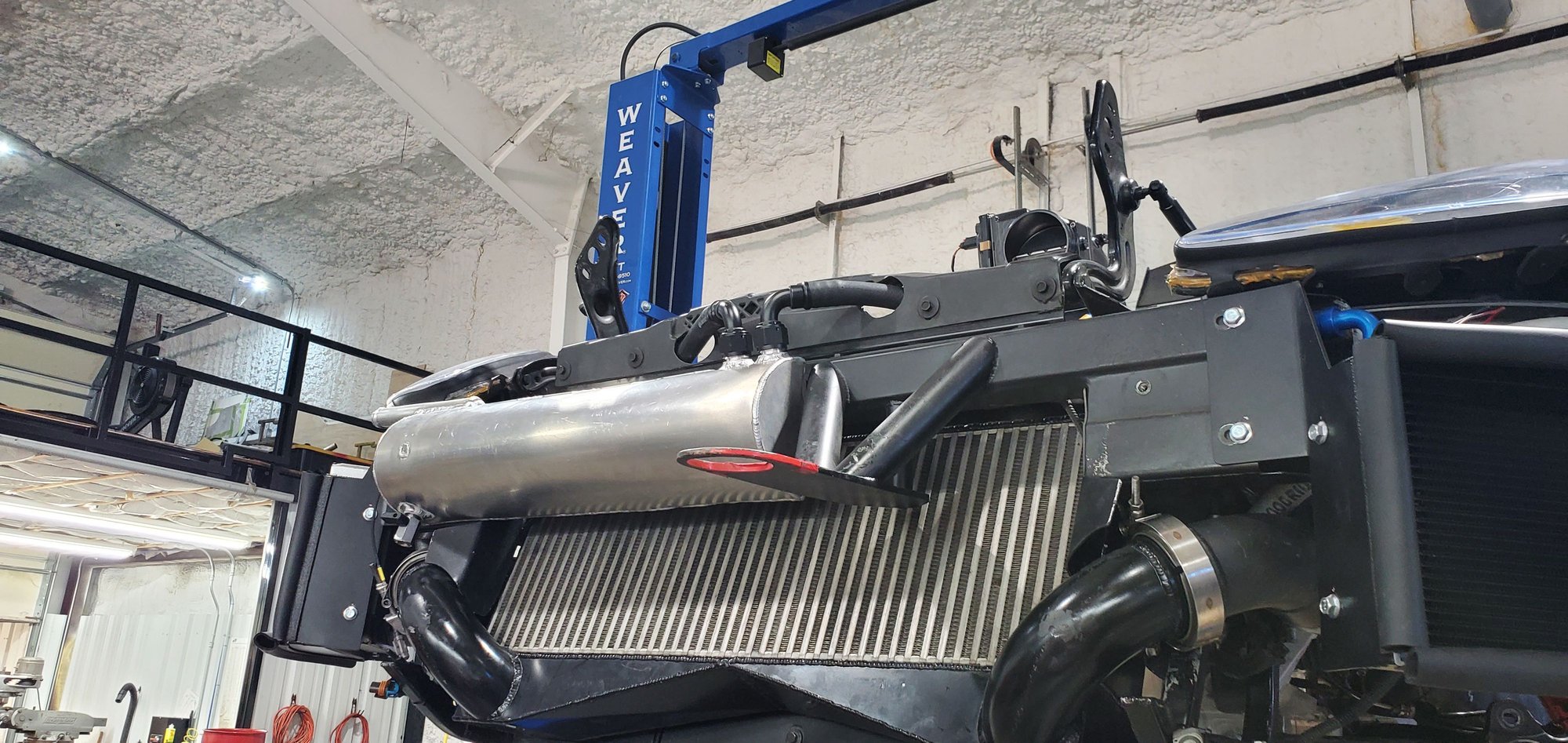

If you cut enough it'll fit
Older pics but it's worked well
what size was the core
Bell 30x10x4.5

[QUOTE=SinisterC6;1607746660]Bell
gotcha. I think there's plenty if Room to do 6in depth after cutting the crash bar

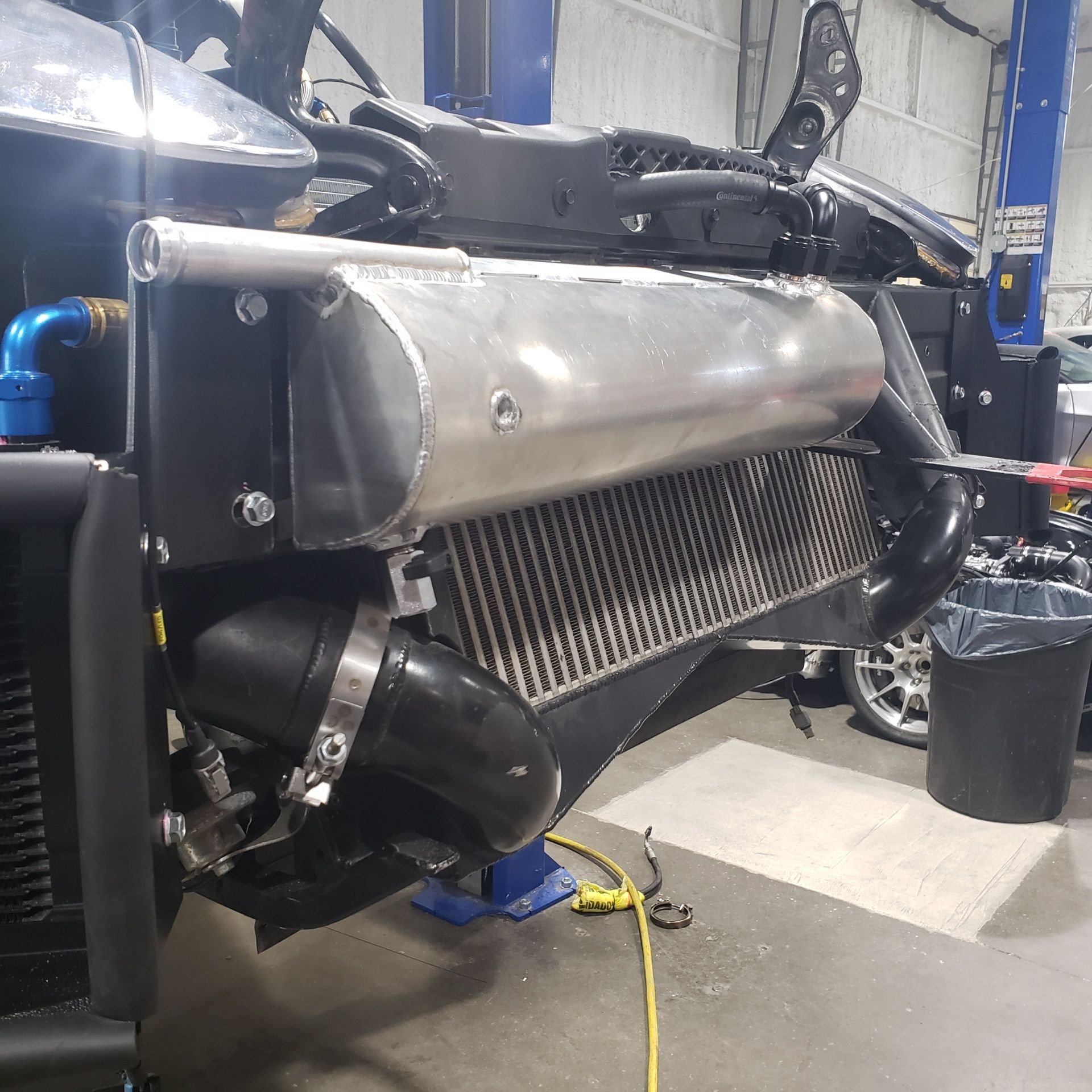

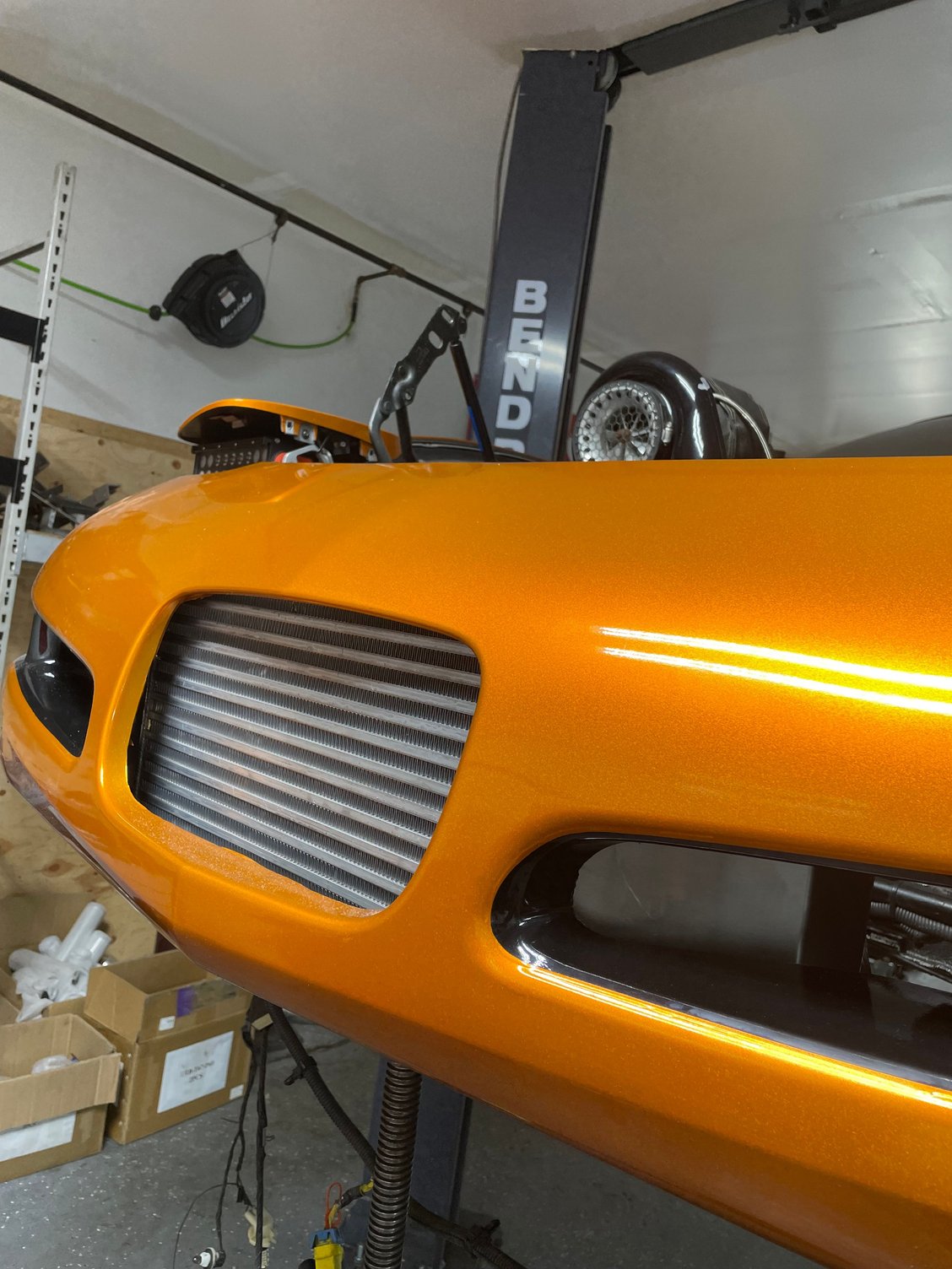

We recently just did this setup that supports 1400 and is pretty compact but it’s for a C5.

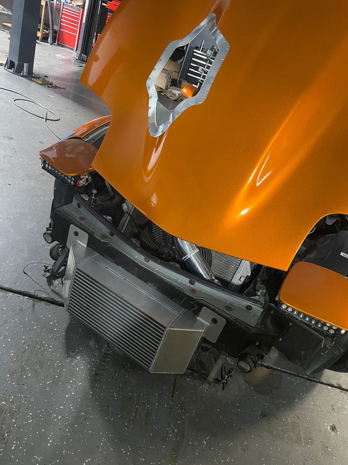

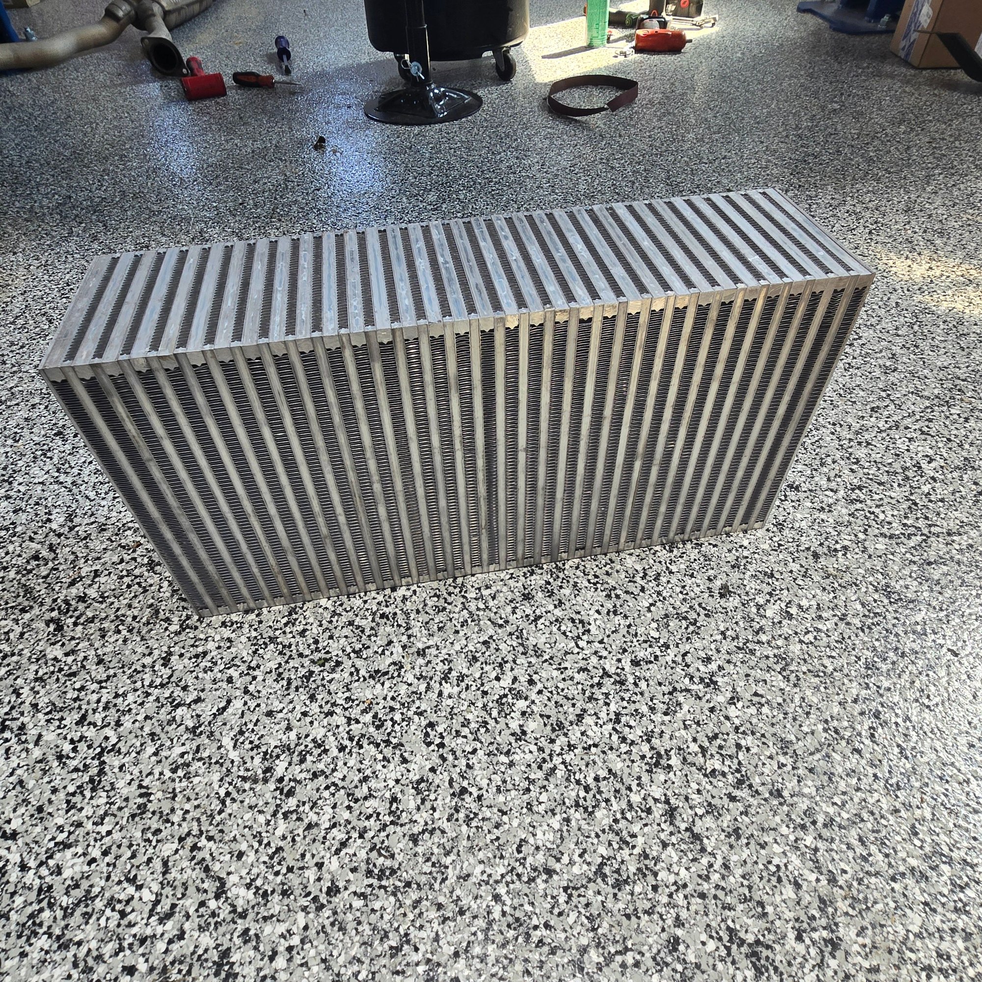

Got the core in finally.

Originally Posted by mgrotel
Nice! What size and brand?
22,11,6 its a vibrant core

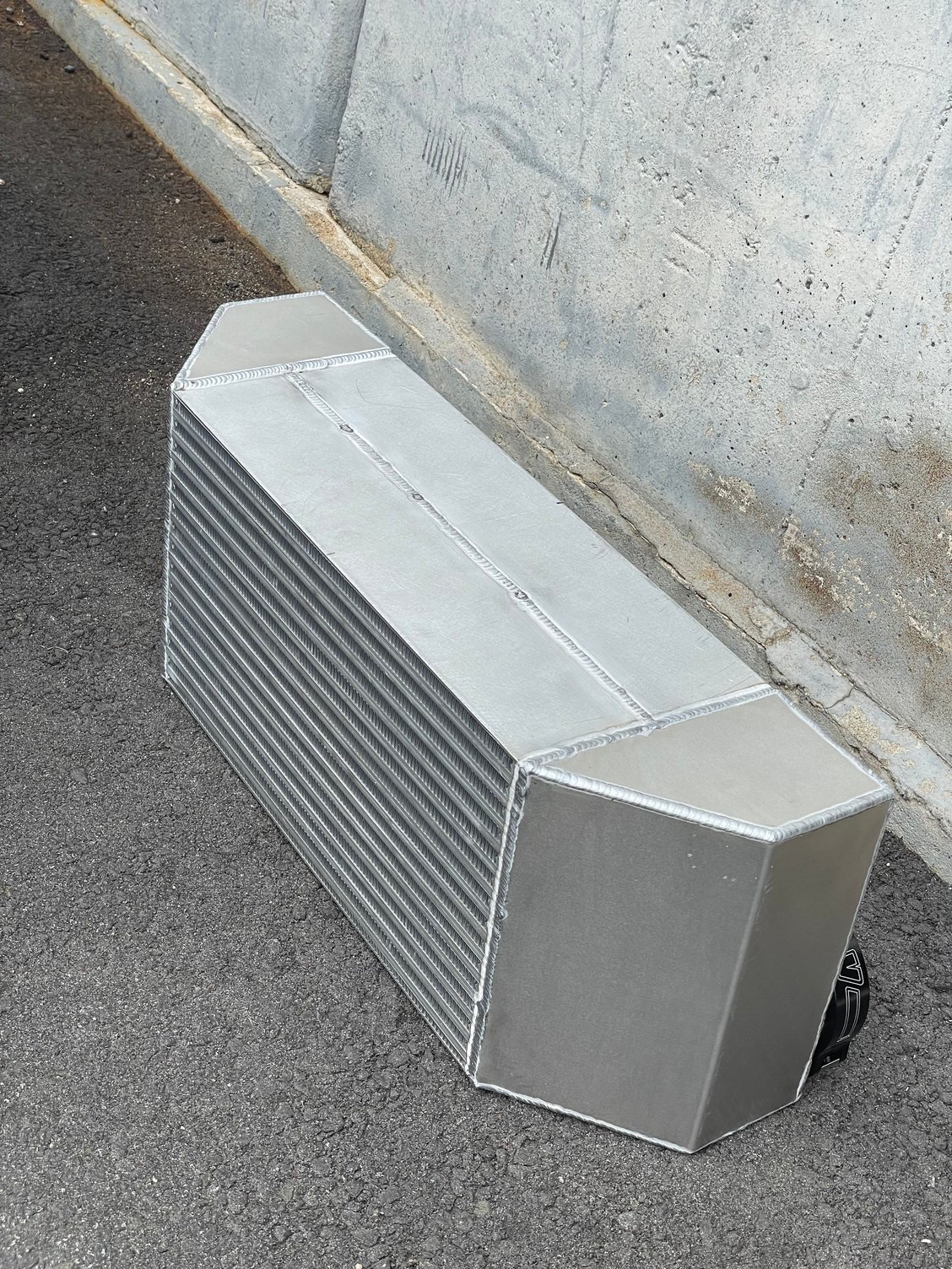

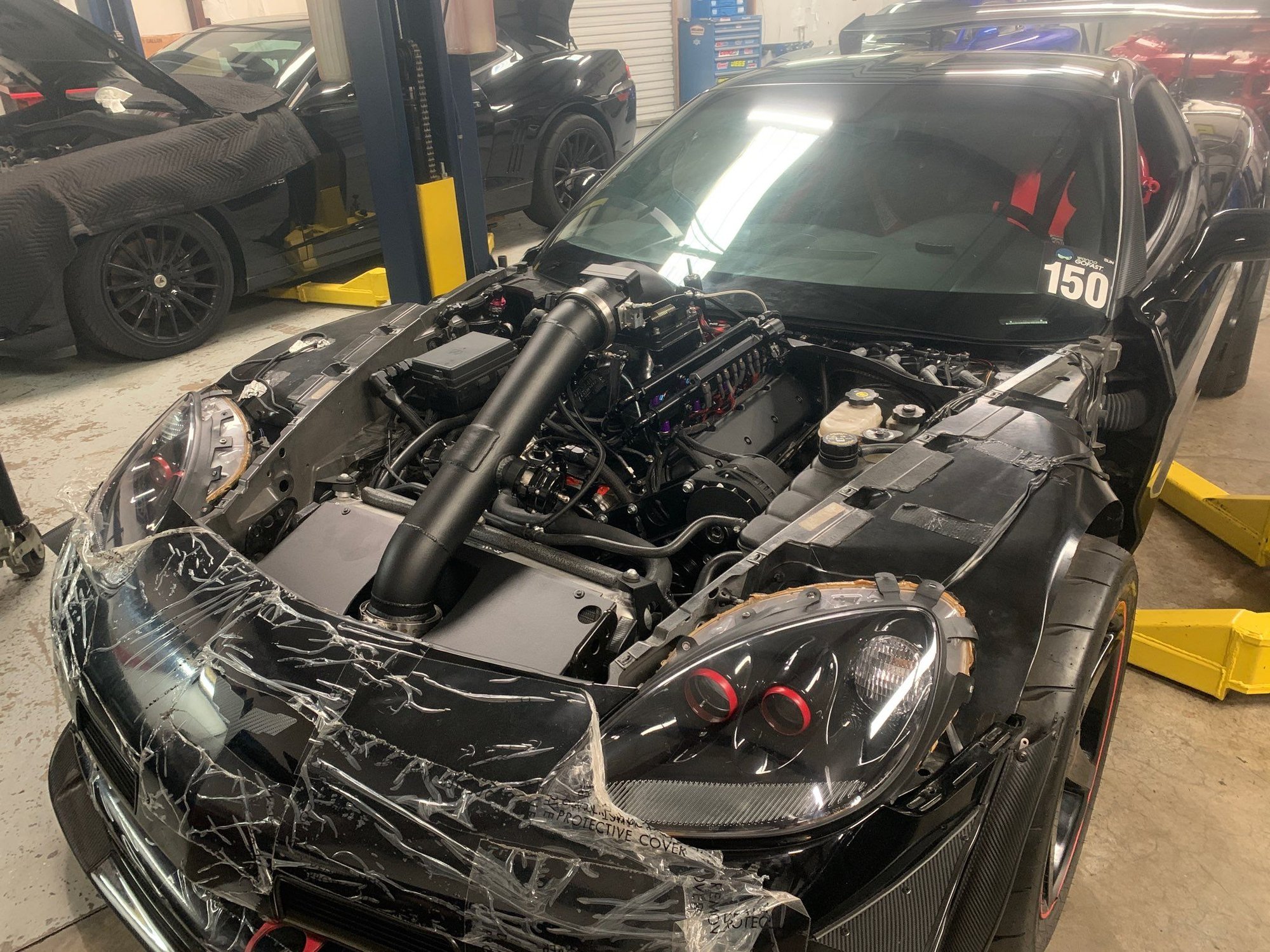

Guess big is relative, but this 2500hp unit fit ok after some things were moved around. 3.5" inlet/outlet with 16AN lines. Standing up the radiator and deleting AC frees up a lot of space.
