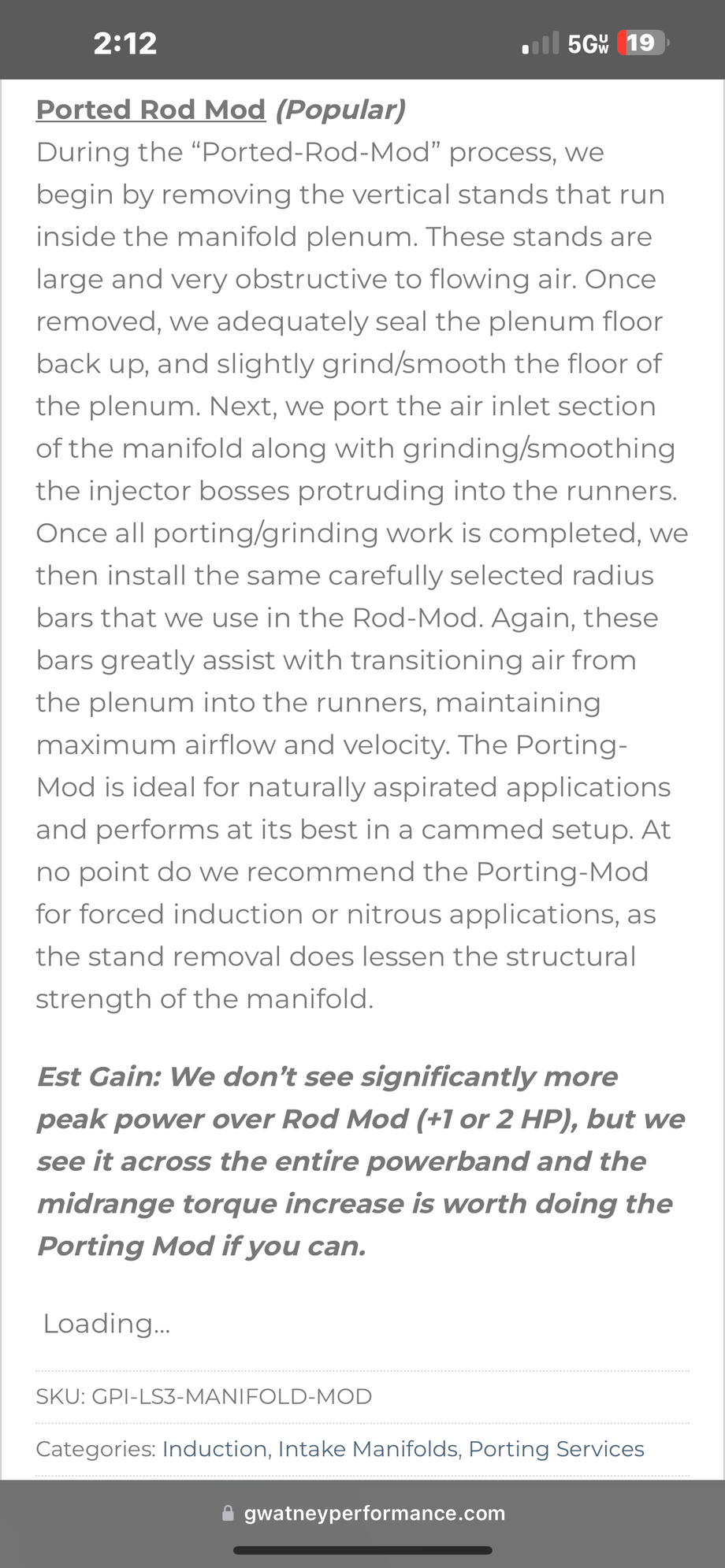

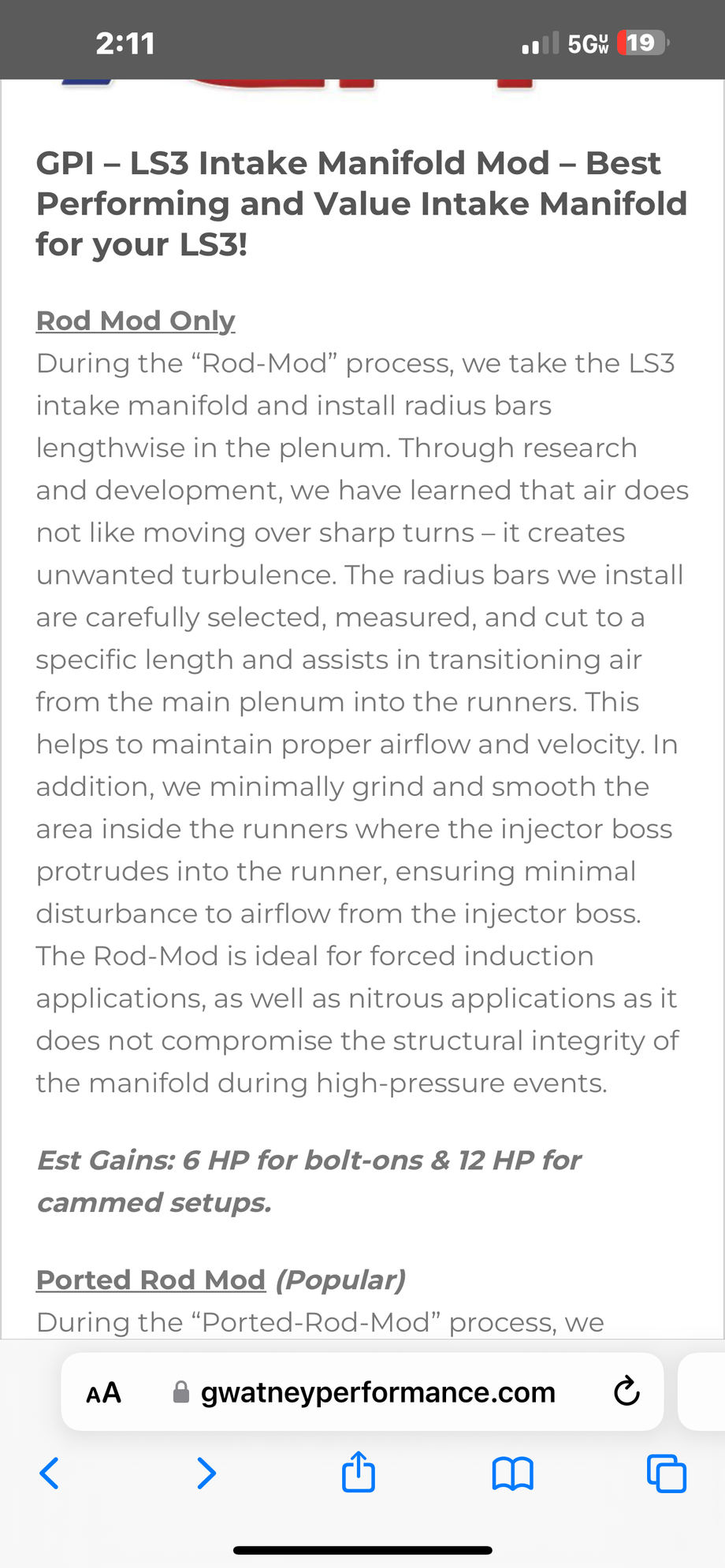

they have multiple versions. The one where they hog it completely out they do not recommend. The rod mod is safe for boost the ported rod mod is not. I emailed them directly when I was super charging my LS three and that’s what they told me plus it’s on their website
