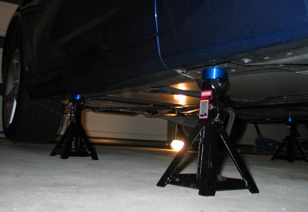

Originally Posted by Shawn S
That's what I have.
I see you cut your rocker panel, did the stealer crush it?
Old Apr 23, 2006 | 01:55 AM
Shawn S's Avatar
Shawn S
Joined: Jan 2005
Posts: 1,238
Likes: 14
From: Charlotte NC
No I didn’t. Unless you know something that I don’t.
Old Apr 23, 2006 | 12:17 PM
repete12's Avatar
repete12
Joined: Sep 2004
Posts: 117
From: san antonio tx
i suspect what he is seeing is a chauk mark next to the puck.
