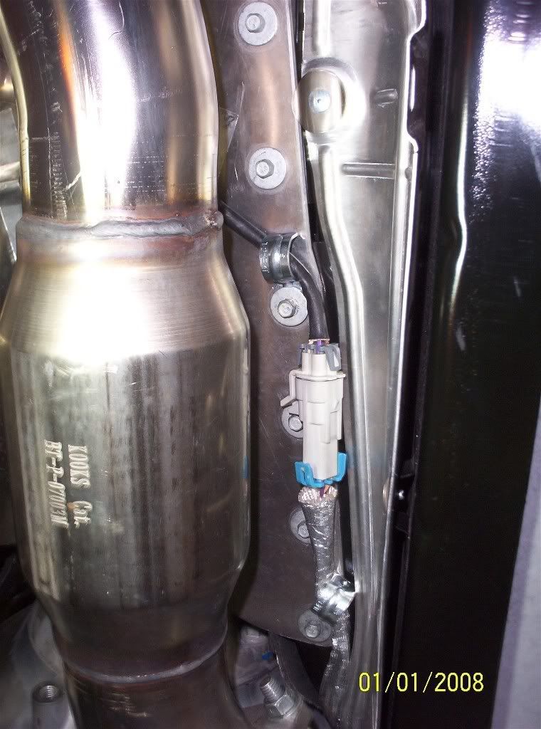

1.Take notice that one of the rear 02 wire extensions provided is longer than the other. The longer one goes on the drivers side. If you mix them up they won't be long enough to plug in. Yes, I got them mixed up the first time.
2. This is what I used to secure the wire extensions. They are left over from a recent remodeling at my house. Simply 1/2" metal conduit pipe clamps. The holes in then didn't have to be drilled for the tunnel plate bolts. Purchased at Lowe's. Also in picture is metal furnace stove pipe tape I had laying around.
This is the hole and clamp position that worked best to get the wires and electrical plugs the furthest away from the cats.
And just in case a strip of metal furnace tape securing the wire to the tunnel plate.

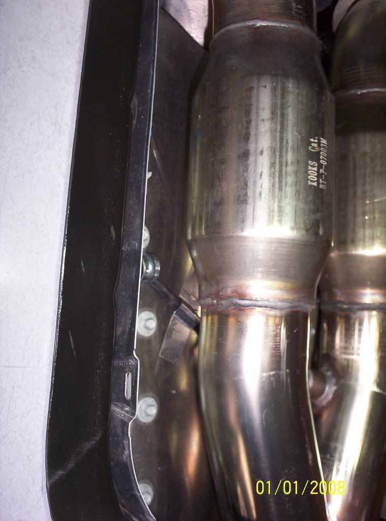

Am I seeing the cats only a half inch from the tunnel plate?
Mine had about with out going out to the garage,
about 1 1/4" clearence so I made a tunnel plate heat sheild out of some
sheet thin stainless, It has 5/16 clearance from the tunnel plate,and fastens at five points.then the cats are another 3/4 from it.

Originally Posted by Rock'n Blue 08
Love the Kook's, Plus they fit like a glove. Now add Z-06/npp mufflers
and a one button exhaust controller.
No, it's a parallax error from the camera angle. I have more than 1/2" clearance to the tunnel plate. No way could I lower the X pipe without road clearance being an issue.
