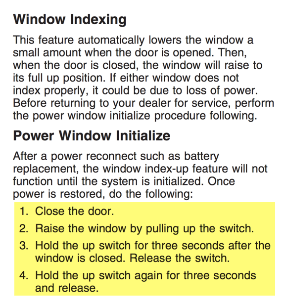

All,
If you disconnect/reconnect the car battery, do not forget to reindex both windows:
To ABS Codes
