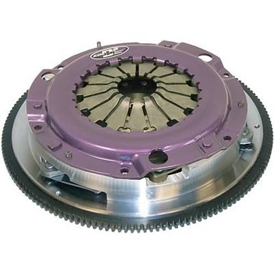

Sam, I spent 4 hours at SEMA, looking, talking researching and have decided on the Zoom Dual Disc. Have a look, it looks awesome spec and build wise, and then Joe_G was kind enough to pit me on the phone with GTODoug who has had it for a while. He had nothing but great things to say about it and the customer service. He said he's tried them all, and the Zoom was the best. When I put it in, you are welcome to try it out first hand.
ZOOM® Performance Products is taking twin-disc technology to the street with their all new D2™ Series Twin-Disc, an affordable light-weight clutch with the holding power of a racing twin, the smooth engagement of a diaphragm style single disc and superior durability by applying cryogenic technology.
Most twin-disc clutches engage both discs at the same time, transmitting harsh shock loads into the driveline and producing an abrupt "on-off switch" effect that is hard to control on the street. ZOOM’s® groundbreaking D2™Twin Disc features their patent pending Progressive Uptake™ design, allowing the discs to engage one at a time for super-smooth operation and the ability to take up to 925lb-ft of torque.
The floater plate features heavy-duty straps for noise free operation and is cryogenically treated along with the nodular iron pressure plate. By applying a cryogenic treatment to the metal friction surfaces, ZOOM® is able to strengthen the molecular structure of the metal to increase durability, prevent heat warpage and stabilize the cover, diaphragm and friction ring.
Matched low inertia discs and your choice of a billet steel or lightweight aluminum flywheel complete this technologically advanced ZOOM® clutch system.
Each D2™ Twin-Disc system comes fully assembled with high tensile strength fasteners. The stack height is designed into the unit for use with stock release bearing set ups and eliminates the need for shims, making installation a snap.

Zoom D2 Series clutch sets are engineered for high-horsepower street/strip applications at an affordable price. These Zoom D2 Series twin disc clutch kits are a revolutionary new twin-clutch design offering high torque holding capacities well over 800 lbs./ft., while maintaining a near stock pedal feel. Zoom uses the latest technology in CNC manufacturing and provides premium friction surfaces. Completing the package, Zoom includes a premium CNC-machined flywheel in every D2 Series clutch set.
1.125 inch, 26 Spline, 8.875 inch Cerimetalic
Includes: Alignment Tool, Pilot Bushing, Flywheel, 225mm Clutch, Pressure Plate.
920 ft./lb. holding capacity. Designed to use a stock type throwout bearing, not included
