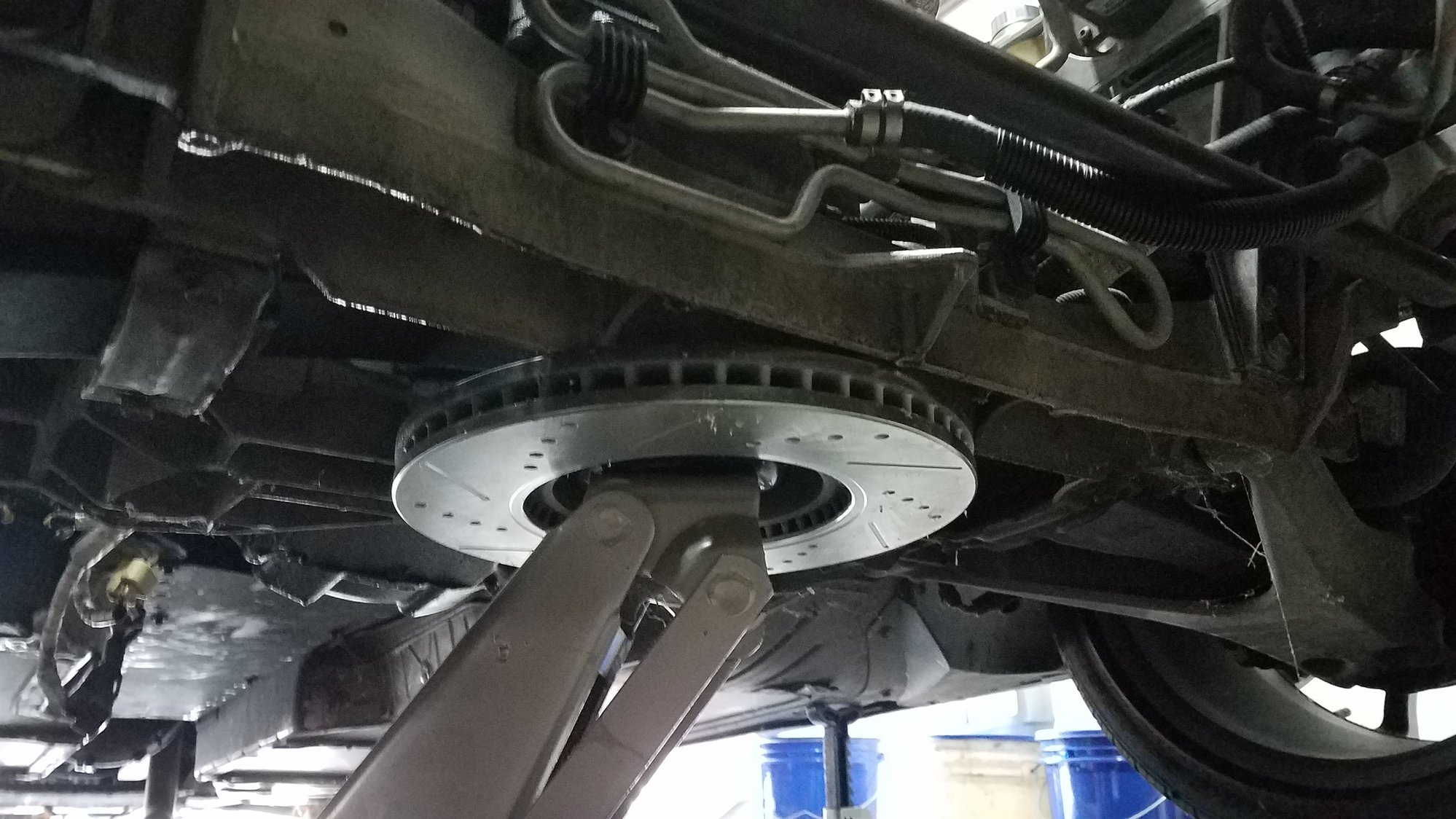

Ok, was able to get mine out also, figured I'd post so anyone with my questions will know as well. The advise above is all correct. What I missed was that the "prop shaft" bit was for the automatic, not the manual. Although I was able to angle the motor up and over the steering tube and lines, this angle was much too great and was catching the TT. Here's what else I had to do:
- Remove upper shock mounts
- Remove upper control arm frame bolts (notate washers and location to keep alignment)
- Remove stabilizer frame mounts
- Use trans jack to support cradle (I don't recommend what I did, but was desperate and will include a photo below for a good chuckle)
- Remove 4 cradle nuts
- Slowly lower the cradle making sure nothing catches - See photo, I only went down a few inches
- Lower engine back down and pull forward
This rotor happen to fit the spaces between the cross members and jack puck PERFECTLY - I will buy the right jack next time!

Scary looking at that jackstand......that could slide and cause ya some problems>>>>
