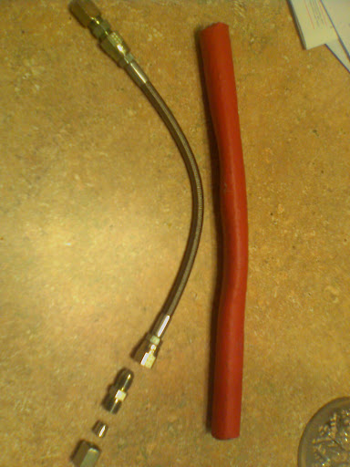

Update... I have measured the outer diameter of the pipe to be 6mm. It is becoming a worldwide egg hunt to find a 6mm compression fitting! I think it will be worth it to replace the rubber hose with a nice steel braided hose, so this problem does not happen again.

I finished the fix a couple of days ago. Ended up replacing the rubber hose with a better steel braided hose from APS. Then, attached the hose using compression adapters and installed a fire sleeve over everything. After this, I bleed the system from the reservoir and the fluid is a clean as crystal (following "the Ranger method).
