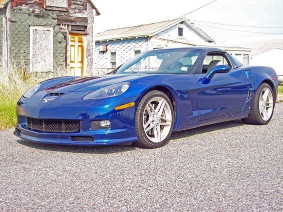

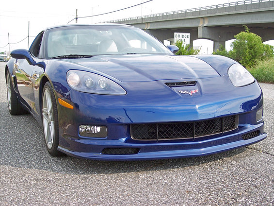

I did the same and saved a whole lot of cash. I just bought a set of spyders for my car and will be selling the set in the pics soon. Good luck
Here is the install guide that I used.http://www.myvettesite.com/files/widebodyguide.pdf
And some pics, check out the before pics:

I have seen Joe's car and it looks great, fast too. I'm sure it won't be long until I need one.

If I were doing it again, I'd go with the 345 rear tires over the stock 325s. It fills the quarters out better. Oh well, I guess I'll wait until I burn these up

Can't wait to get started on this, looks AWESOME!
