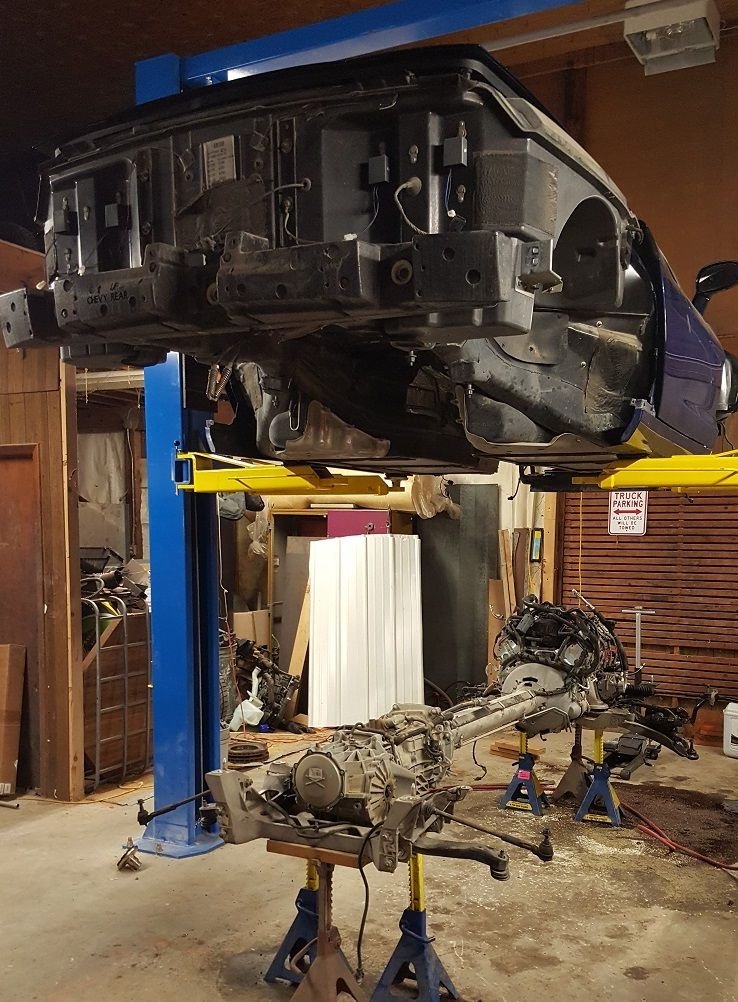

Great write up. I am in the process of this myself. I have the entire drive train out of mine right now. Installing a new high perf engine and a few other gizmos and gadgets. so it just made sense to drop the whole thing. getting close to putting it back together. just waiting on a few odds and ends to arrive.

That's def the way to do it if you've got a lift.

thought I would pass this along. I had a harbor freight 1000 lb hydraulic lift cart in my shop and I went and bought another one. this made putting the drive train back in much easier than using jacks and stands etc. wish I had thought of this when I removed it.
