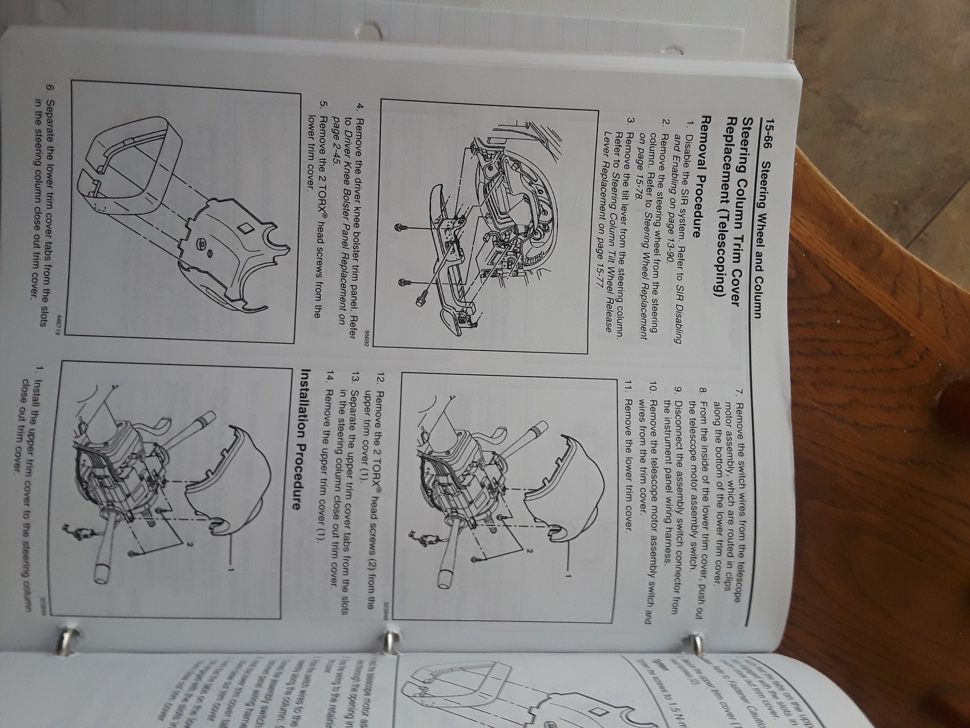

Old Jul 29, 2017 | 01:22 PM
Jon05vette's Avatar
Jon05vette

I'm looking for so instructions also. Want to recover it in leather if I can get it off. Mine is a 2005 with a telescoping column.
Anyone find instruction?

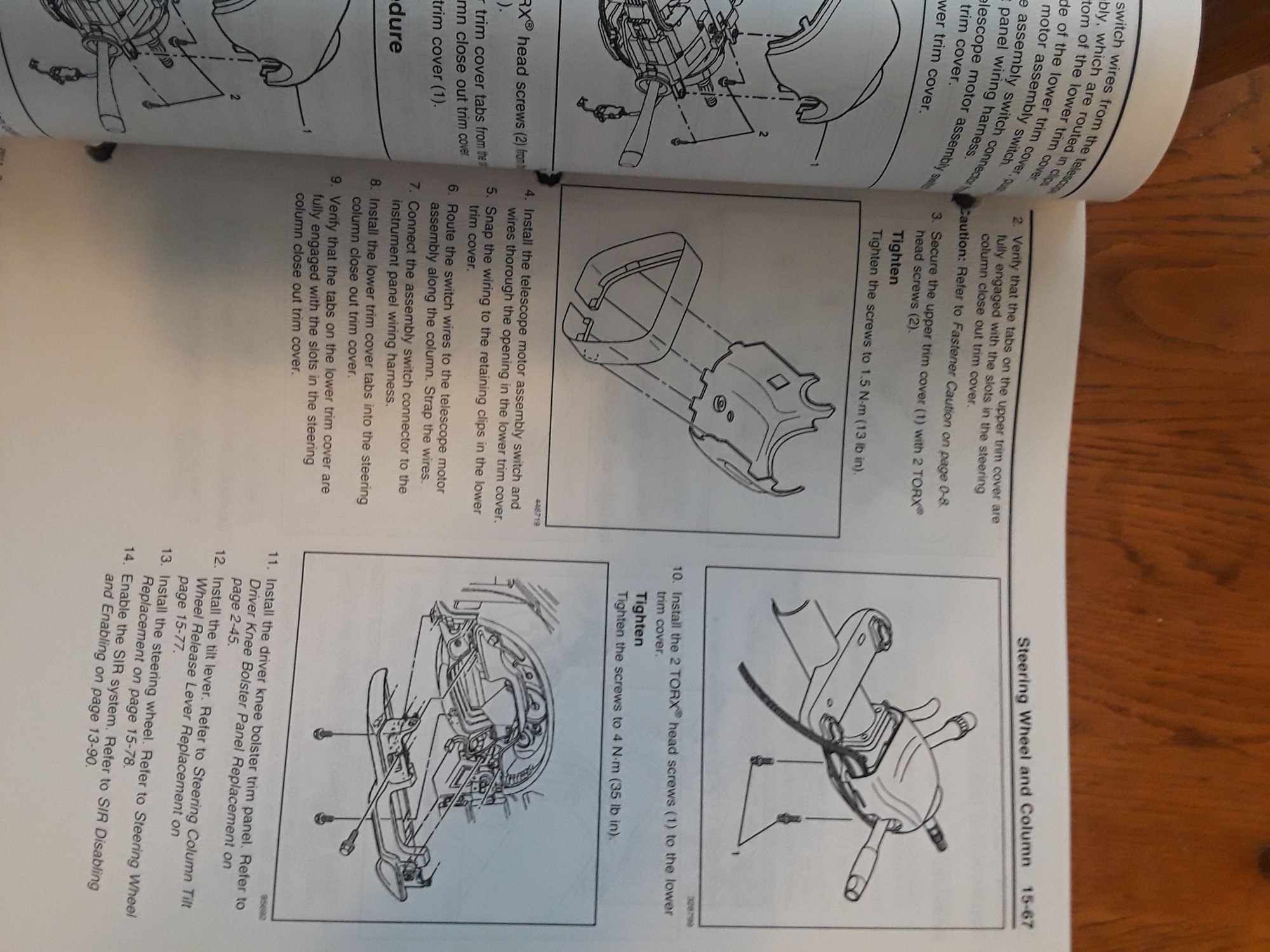

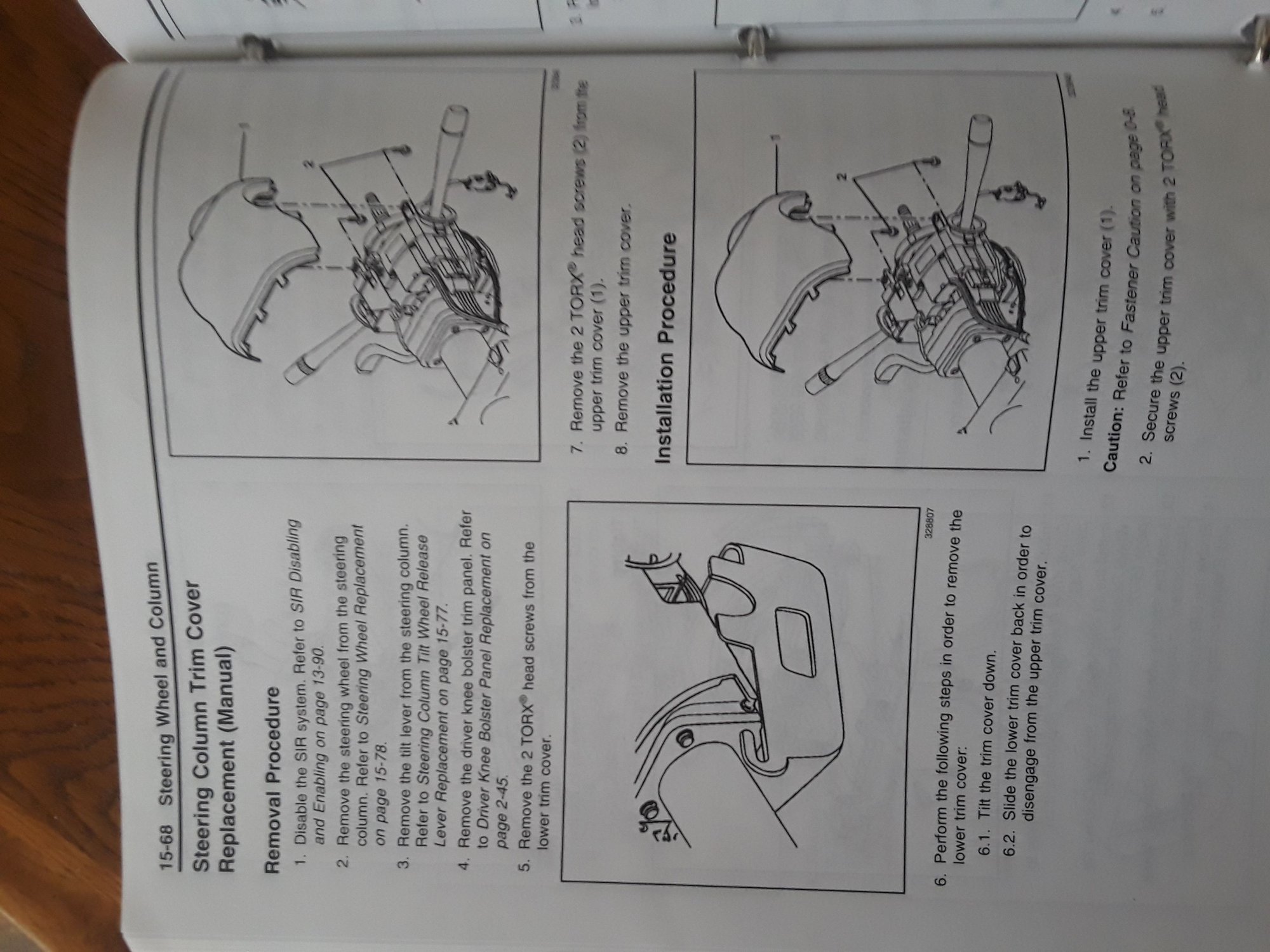

Old Jul 29, 2017 | 05:07 PM
HK770's Avatar
HK770
Joined: Aug 2014
Posts: 1,240
Likes: 258
From: Tampa FL
From my 11 manual...............LUCK
sorry pics out of order

Old Jul 30, 2017 | 06:46 AM
Jon05vette's Avatar
Jon05vette
Joined: Jan 2016
Posts: 187
Likes: 60
From: Reisterstown MD
2016 C6 of the Year Finalist
Many thanks!
