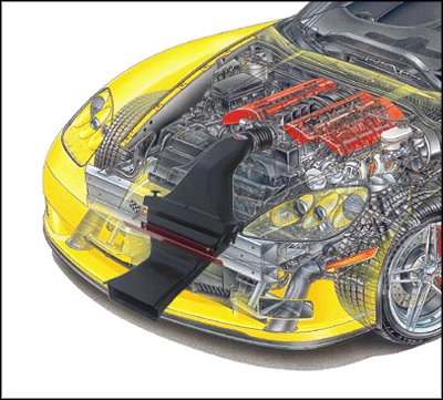

Default Corvettes of Westchester will always be a VARARAM SHOP!
And for a good reason. In fact, SEVERAL GOOD REASONS.
First off, the company is friendliest, most cooperative, and attentive to it's customer's
needs...Whatever they be.
Second, Patrick.... The man behind the product development....IS ONE SMART DUDE with
credentials and products to back it up.
Vararam ain't no CONE FILTER ON A PIPE...It's a well thought out design and
each and every feature of his Corvette products has a definite purpose...
That's why they will ALWAYS be the leader in this market.
Any problems I've ever seen with Vararams were ALWAYS installer error.
They don't just drop into place...There's some work involved and that's
another reason why they work sooo well.
BUT, if you don't install them properly....don't expect them to look or function
at their peak performance. That's on YOU.
Most people prefer to come here or to our booth at Carlisle as NOBODY
has installed as many Vararams as Corvettes of Westchester.
From a tuners perspective VARARAM intakes just plain work. Lots of thought
and testing goes into each design and what's best about them is that I always
get a nice clean, stable, repeatable signal from the MAF where as other intakes
with cone filters and MAF sensors up front by the filter have way too much
"swirl" or turbulence at the air meter just like what you see in the bowl when you
FLUSH THE TOILET.... The air spins and tumbles and the car runs poorly down
low or at light throttle..... NO GOOD.
Be wary of any product that has a VORTEX effect at the air meter.
You tuner will hate you and your car will run like CRAP.
Recently, we've even had to REFUSE to tune customers with certain type intakes
as I spent hours and hours to make them right, and I'm still never happy.
If I'm doing a mail order tune or a an AutoCal tune....
YOU HAD BETTER CALL ME SO I CAN SEND YOU A VARARAM!
That's my 2 cents.
