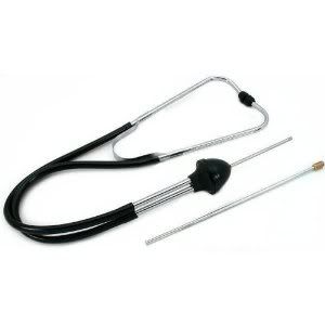

^This^
And if that doesn't do it..
Old Feb 11, 2012 | 04:44 PM
Joe_G's Avatar
Joe_G
Joined: Jul 2002
Posts: 14,950
Likes: 264
From: St. Louis, MO
St. Jude Donor '08
Originally Posted by DSOMC6
^This^
I find more use out of that tool. Worth every penny. It's amazing how well it works.
