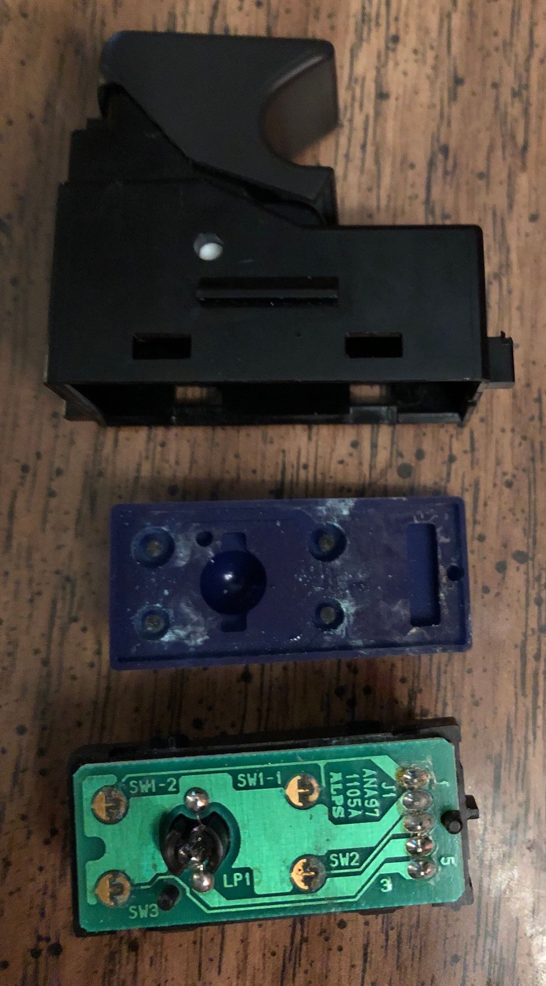

Default Passenger power window switch corroded
I replaced the passenger side power window switch and disassembled the original one. The contacts on SW1-1, SW1-2, and SW3 all show signs of corrosion after cleaning. The contact on SW2 if half missing. J1 also shows some corrosion, especially around pin 1. It’s clear to me now why this switch failed. It’s just worn out. It was probably helped along the road to failure by getting wet. The new switch, ACDelco D1991F, GM 20794871, works great.

Great post, thanks for sharing.
