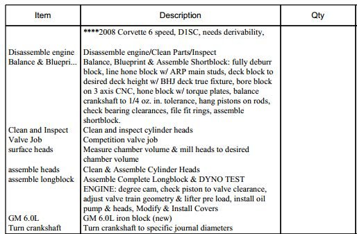

Hey guys, wanted to update on my new engine build plans. This is going in a 2008 Corvette with the following bolt ons: Procharger D1SC, Dallas Performance Big mouth kit, AEM Meth Injection Kit, boost-a-pump, upgraded fuel system (not sure which one), OBX 1 7/8" Headers w/ 3" xpipe, Magnaflow Axelbacks.
Late Model Engines in Houston, TX is the builder.
The engine build plans are the following:
not included on the invoice is port&polish.

Mostly due to cost, LQ9 is much cheaper than a LS3 block and only weighs around 60lbs more. And also due to it being a stronger block.

I should be around 800hp with this build, have never had this amount of power!
