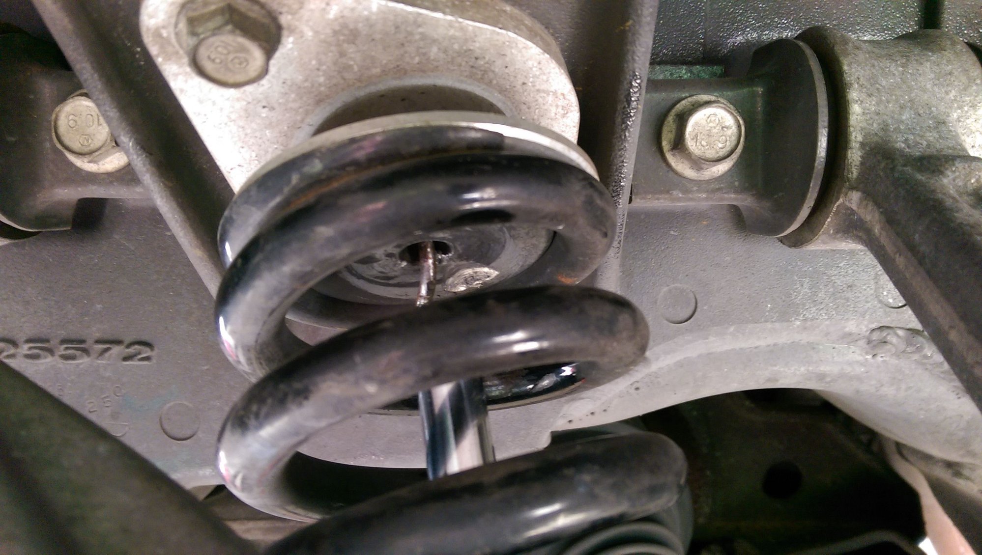

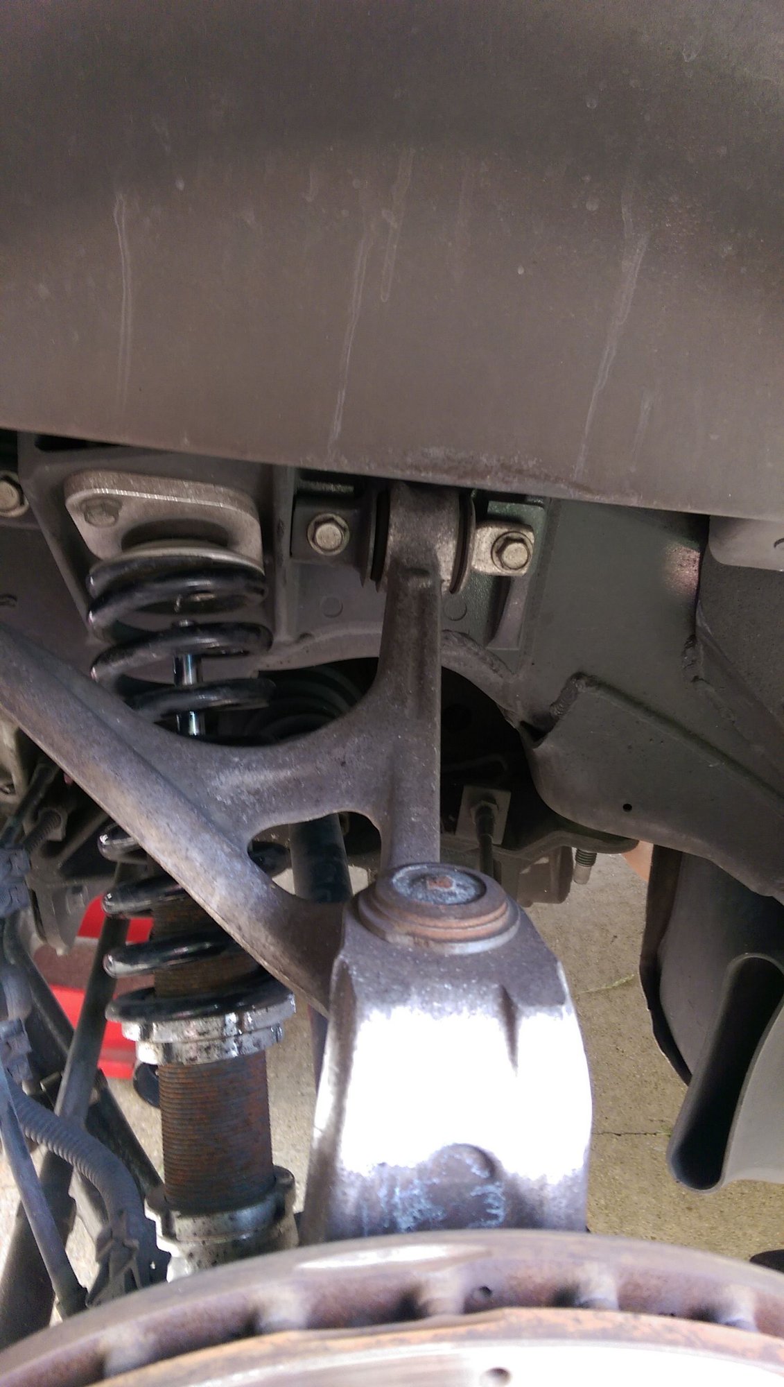

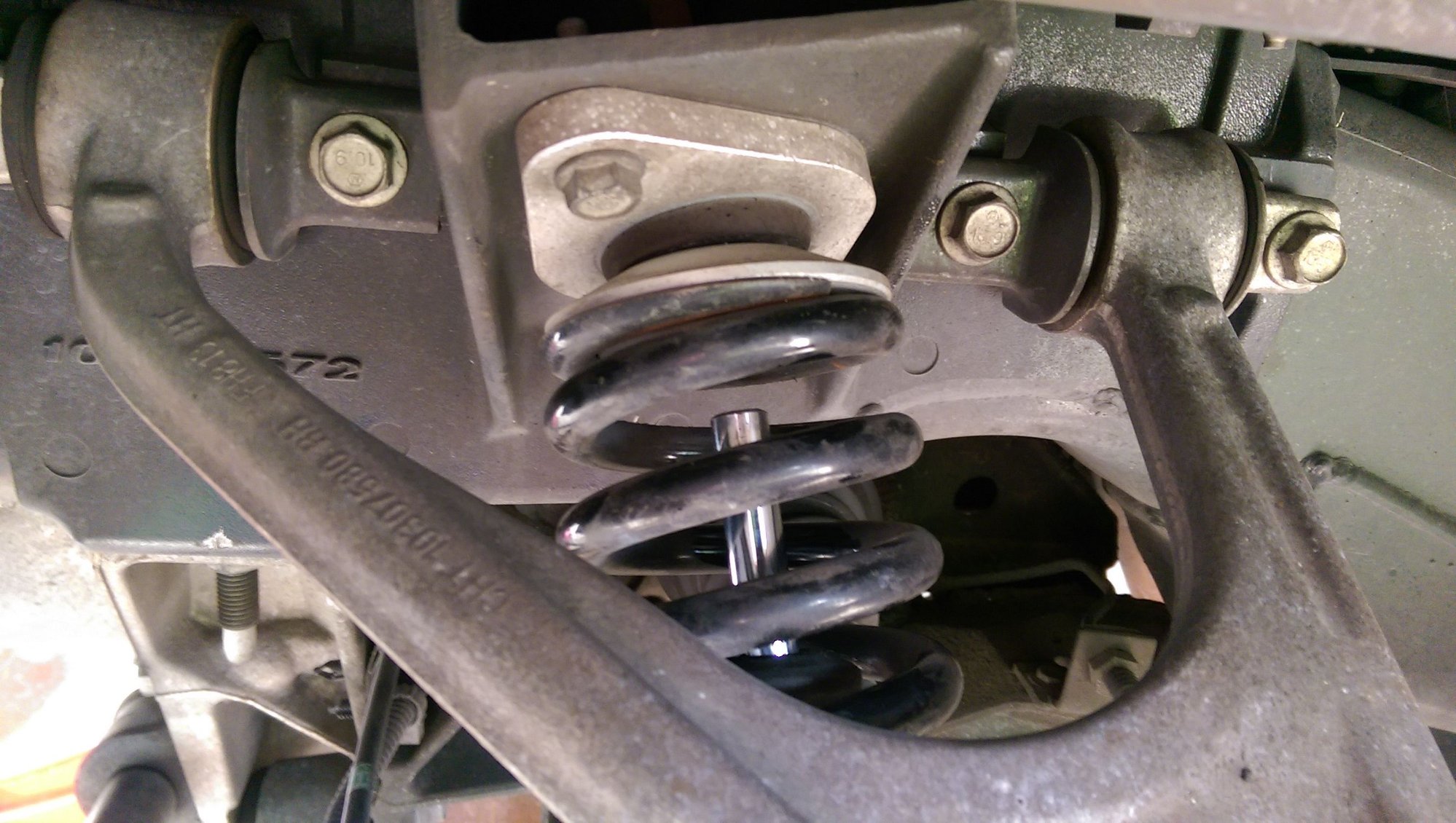

Mine also broke, slightly different model. Made a clunk clunk noise whenever the wheel is in rebound, because the shaft of the shock rattles inside the coil before it lands back in the coil seat. No noticeable change in handling (on smooth pavement, wheel bounces obviously on rough road)
Anyone have more reliable coilovers? I love(d) the ride quality before it felt/sounded like the wheel was coming off. I actually jacked the car up (not easy on a lowered Z06) in a restaurant parking lot in Knoxville to pull on the wheel to see if it was indeed coming off. Sounded like the world was ending behind the passenger seat going over any bump.
You can see where the shaft end likes to sit on the coil mount.
Mind the gap!
Bent adjuster rod
