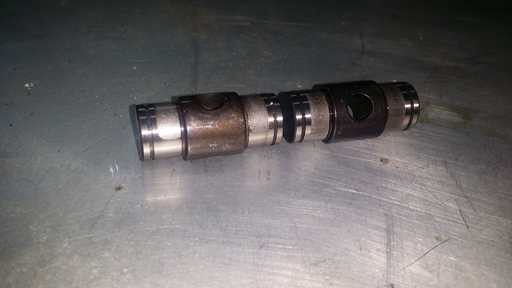

Has anyone else had problems? This is my 3rd set in 30,000 miles...The bearings keep wearing grooves in the trunion...I am a 15 year machinist with a shop and tested them on my Rockwell tester. They came in at 50Rc, a little low..
They were definitely installed right. I have PSI springs. Mild Katech cam. I run good Brad Penn oil. And I now believe these MIGHT have been the culprit that toasted my motor 20k miles ago..
Just curious what other peoples experiences are. Thanks Derek
Trunion on left is first set trunion on right is second set
just ordered 3rd set. And all trunions look the same

Could it be the springs? I know you mentioned a katech mild cam, but mild due to low duration, lift, lsa, etc? I know those numbers can be misleading. The lobe ramp rate may be aggressive, like an lsk or lsr too. Just some food for thought.
Also, i read that some of these good oils contain a lot of zinc zddp? But some don't do to well on shear pressure...something along those lines.
Old Oct 12, 2014 | 10:35 AM
Dano523's Avatar
Dano523
Joined: Dec 2013
Posts: 12,513
Likes: 3,638
What lifters, and are you sure that you are running around .080" of valve lash pre-load with the valve bolts torqued to 22ftlbs?
Also, what valve springs are you running, since as pointed out, the cam lobes may be more aggressive that you think.
The only other thing that comes to mind is the mistake that AMF had when they first bought Harley Davidson, being that the bearing materiel and the bearing raceways for the wheels where both made out of like types of steel, which caused the bearings to galling seize and lock up, even though the bearing where correctly greased.
The trunions are 8620, so now it just a mater of finding out what metal the needle bearings are made out of (best guess, 52100 chrome steel). http://www.google.com/patents/US20140261269
http://en.wikipedia.org/wiki/Galling

In my first setup I had an lsr lobe with dual springs and stock valves... and the cam/trunions went to **** and ate the motor...I am not sure which one happened first or they both just had their own problems...So I rebuilt the motor with same style cam.. dual springs..SS valves..rebuilt trunions...lunati lifters and then the axles came out of 5 of the lifters...
So I called Jason at katech and he recommended this cam with milder ramp rates. And went with hollow valves.. PSI springs and comp cams short travel link bar lifters...
And rebuilt trunions...
Now 8,500 miles later I am still having just trunion issues...
And as for the trunion material, yes using dissimilar metals is a must and would imagine chromoly rollers are standard...I was looking at the stock bearings and the rollers are encased between two 60+rc bearing housings. They wear great but have failure issues of their own

I did some more researching and found all the failures you spoke of...I have come to some conclusions of my own and am going to do some R&D...beins I dont want to spend big coin going back to stock and I already have the new set......I believe oil starvation is the problem...if you look at the stock trunions/bearing, oil can easily enter.
So I will make 2 very small oil slits(roughly.010") on the top of the trunions(both sides) about 30 degrees cw and ccw that goes down into the corner and protrudes into the race about .050" and angle it 45* to the bearings...being there is no load up there it shouldnt be anything but an upgrade...This will allow oil to pool and run on the race and rollers...
And after some research I am going to change oil...this is a great independant oil test I found...probably one of the best unbiased tests I have found on oil

New trunions with oil grooves.
Will keep a very close eye on these. If this doesnt do it Alum. Brz. Busbings are going in.
The snap rings did go on
