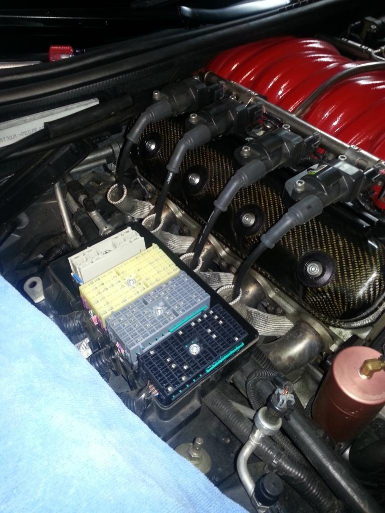

I Got into the wheel well last night in an attempt to Ohm out the fuel pump harness.
I got the connector undone, and probed the connector thats fixed to the inner wheel well. Battery was disconnected, fuel pump relay pulled. I grounded to the bolt/chassis that's visible right there at the filler neck. . I got continuity on all 4 pins. ???
I also attempted to OHM out the other loose end of the cable/connector and got no continuity.
Does that sound right, or did I have it backwards?
after that, I was poking around the fuse box in the engine bay, I got the upper fuse panel disconnected from the bottom part, but it had a small bundle of red wires (5 or so) still connected. I stopped there and put it back together due to lack of time. Is there an easy way to get those wires disconnected? They looked as if they went inside the lower fuse panel.
Once that's disconnected, do I loosed the silver posts/bolts from teh top to separate the upper and lower fuse panel?
Thanks in advance!

Well, after much trial and error, hand wringing, headaches, a tow truck and alot of input and other stuff, I think I got it figured out.
Using the links suggested above, I took the relay/fuse panel in the engine bay out:
I have to be honest, "unswaging" those bolts/standoffs so I could separate the panel was a major PITA! It took way more time than it should have. After some prodigious swearing I got it all apart:
Guess what I found? Two burned wires, and not the ones that feed the fuel pump relay that has burned out twice in last 2.5 years. The two wires that burned are underneath the fp relay, so my assumption is that they are somehow related. Anyway, using the writeup in the headlight thread link above, I replaced the two wires with a few cents worth of wire.
Ive heated the car up twice now, and brought it back home hot. Shut it off and repeatedly started it up over and over, like 10-15 times, and not once did it slow crank. I will say that when hot, I have to blip the throttle a little to get it to start, but that could be the tune, or the ls9 injectors I've got; I'll know for sure once I address that issue, but at least it doesn't seem to slow crank anymore to the point where it goes into limp mode. Time will ultimately tell if I cured the issue once and for all , but things are looking up!
