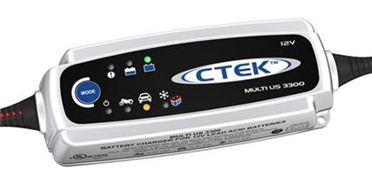

Yes, with the wrong tender.
Hence the cheap trickle charger from harbor freight have too high of a standing voltage and will boil a lead type battery if left on too long, and since they are not designed for a AGM, will kill them as well.
The Black and Decker maintainer is not bad, but since it lacks a desulfator cycle like most other the lower priced units, you may not get the life out a battery that you would with a Ctek 3300.
To be blunt, just pick up a Ctek 3300, and make sure to put it on the car if you are not going to drive the car for a week or more. The little more money you spend on the 3300 up front, will be a lot cheaper than the money you speed on another tender first, then buy it afterwards. Plus with the desulfator cycle that the 3300 has, will help the battery to last longer as well .
To add, I have both a Black and Decker maintainer that I use it on the truck or 6v batteries when I'm away, and a Cteck 3300 on the vet. I needed something for the vet before I fly out on a extended trip, so pick the B&D up to throw on the vet first from walmart for under $20, then switched over to the Cteck 3300 on the vent when I go back and it was i the mail box waiting for me.
The B&D is both 6v and 12 V, but does not work on AGM batteries.
The Cteck 3300 is 12v only, but does work on AGM batteriess, as well as lead cell batteries.
http://www.walmart.com/ip/21721663?w...055512&veh=sem
As for the Ctek 3300, check around on the site, since there are vendors here that have the accessory kits with them for a reasonable price. On mine, I have the lead connectors off the battery that plug into the extension cord, then into the charger so I can leave the 3300 screwed on the wall(read just pop the hood, plug it in, then lower the hood back down without latching it).
If you want to go high tech with a mag type quick plug so you don't have to pop the hood, that is a option as well.
http://www.nakidparts.com/id127.html

We have the Corvette-marked CTEK 3300 and I use it any time we will be home but the car won't be driven for a week, or if doing work (open doors) that will turn on the interior lights.
However, I'm reluctant to leave any electrical equipment On for long periods of time, unless I can check it periodically. There have been occasional posts here about tenders going bad and boiling the battery, and I suppose it might be possible to do even more damage than that.
When we go on vacation for weeks in the Corvette, I just disconnect the battery in the tin cars.
