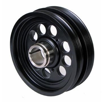

I am in the middle of a H/C upgrade on my 2005 Z51 C6 and since my VIN# is in the first 11000 made in 2005 and there was a TSB notice on the stock harmonic balancer, I've decided to go ahead and replace my stock unit to hopefully avoid a future issue. It seems that a lot of people have been having success with the Powerbond HBs so I'm leaning that way since the ATIs are very expensive. I'm interested in the race series Powerbond model PB1117SS, but it looks like it already has a rectangular shaped key on it (see pic). How would I pin this balancer if my crank has never been pinned? Most of the pinning kits I've found on the web look like they have round pins versus what the PB1117SS has. Any thoughts, ideas, or recommendations?

OK, I think I have since learned that the TSB for the early 2005's were more focused on the replacement of the balancer bolt rather than the HB itself. I am going to use a new ARP bolt when I install, so the question is still how do I pin this HB since it is already has a rectangular looking keyway, or do I just mount it and use as is? Alternatively, I can just get an ACDelco HB and pin that for extra stability...

I dunno. Seems like the experts would be the company that owns PowerBond and that would be Dayco. Have you talked with their tech staff as to what to use, or if they have something to use in their product lineup?

mount it and use it. no need to pin the harmonic balancer unless there is extra load on the belt system via supercharger. my ATI balancer was the same and ATI told me the same thing. most aftermarket cranks have a keyway on them so that makes the balancer a little more usable to those who purchase them for aftermarket cranks. BTW the arp bolt is an upgrade but I used a new factory gm bolt. make sure you lock tight the bolt and follow torque procedure. I had mine back off the crank snout and go against the steering rack on the dyno. new front seal and another GM crank bolt WITH lock tight and it was good to go!

Hey guys! Brian from Dayco here. First off, good question. The stock GM Corvette and almost all GM late model harmonic balancers use a press fit and bolt to secure the harmonic balancer to the crankshaft. As car owners make more horsepower, it adds more torque against the press fit and could, and most likely will, cause the harmonic balancer to spin on the crankshaft. There is no danger of the harmonic balancer coming off, but there are certain timing issues that will result. PowerBond by Dayco “keys” our performance late mode GM harmonic balancers and recommends that buyers have their crank shaft “slotted” to add a woodruff key to ensure no slippage will occur. Pinning does not require the slot and essentially does the same thing. If the user elects not to have their crankshaft “keyed” and elects to “pin” the balancer to the crank shaft or do nothing at all, silicone is used in the balancer keyway slot to stop engine oil from coming out. This is not a pressurized oil system so there is no concern from engine forcing the oil by the silicone. Also, note that PowerBond Supercharger Series or SFI Race Series Balancers are dual keyway slotted for the ultimate in balancer strength on the crankshaft. To date, we have never seen a PowerBond keyway compromised. Hope this helps.

I used the SFI model LS cranks are not keyed the HB goes on the same and it gets pinned the same as any other. use the side opposite the key way, car runs soooo much smoother

Use the ATI pin kit from the side.

I recently installed this balancer. I did not know that I should seal the keyway. I never gave it a thought and there were no instructions to do so. I presently does not leak and the only thing I can think is the bolt head is sealing the keyway. I may be wrong about all this.

When you are pinning the crank with the ATI kit (from the side), you drill a small hole in the side of the front crank snout and insert a round pin. It sticks out just about .1". Now when you install your aftermarket HB, you line the pin up with the notch in the HB and slide her on. Yes, only needs to be pinned if supercharged. I just bought a supercharged car and it wasnt pinned. Luckily I caught it before it started slipping or grenaded the HB

timing issues would be the least of your problems if hb spins on your crank.spinning will damage your crank snout!!!timing issues I believe he is talking about is some of these hb's have timing marks on the circumference of them.to most of us this is not an issue as we don't time our cars with these timing marks

I use this balancer with my Blown LS7 and have had zero issues so fare. I have a keyed crank but I would just pin it. No need for the race modle (2 keysS) order what ever you find with the best price. I found mine for like under $200 shipped.
I like the fact that it doesn't have have all the bolts to deal with....

I just sealed the keyway with red rtv. No leaks for me.
