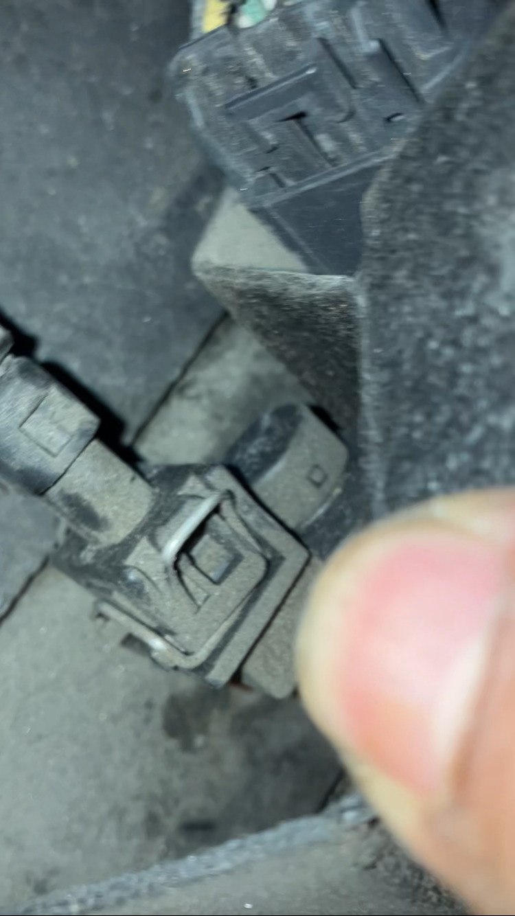

Old Nov 6, 2025 | 07:14 PM
F8l_ZeeOh6's Avatar
F8l_ZeeOh6
Cruising
Joined: Sep 2023
Posts: 14
I sprayed the c455 connector right above my thumb, didn’t seem dirty but what is this connector right by my thumb can’t get it to separate and I’m having the same issue as op
