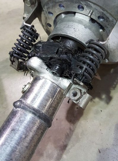

Default This is what they found when I had my torque tube rebuilt....
Granted my car is a C5 with 75k on the odometer, the last time anything had been done to the tube was in 2002. I had the TT rebuilt a couple of weeks back as part of power upgrades, I figured it should be serviced since I was getting the rear end replaced anyway. I was in shock when they sent the pics over of what remained of my couplers. If you have the opportunity to get this done on your terms, take it. This would be a good idea especially if the car is a few years old. I had planned to do the bearings and couplers from the beginning since I was also upgrading the driveshaft and I'm glad I did.
I bought the bearing kit from RPM as someone else mentioned above but I went to poly couplers front and rear.
