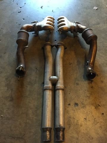

A good muffler shop can put a 3"-2.5" reducer pipe and they'll mate to your Corsa's. Below is a pic of the reducer:
thanks for posting that. It seems like it would not be to restrictive.
