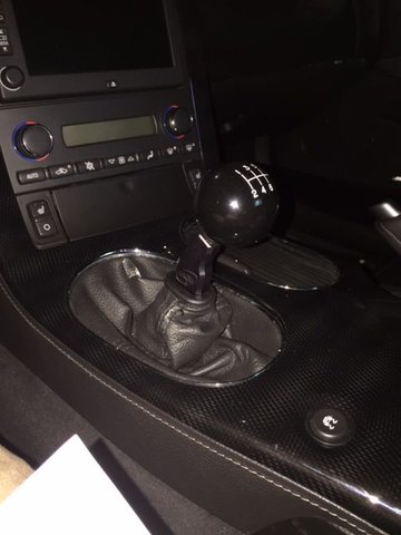

So I Installed my new MGW flat shifter in my Z06 this past weekend. The Shifter itself is amazing and the craftsmanship that went into the designing of this shifter is top notch. The install was very straight forward as long as you follow the install videos on MGW website.
The only issue I have with the shifter is that once the shifter is in gear I have play in the shifter in every gear. Meaning if the shifter is in any gear the shifter has up to an inch of travel from side to side. I have double checked all bolts to make sure that they are all tight, so I don't think this can be the issue but has anyone else had this issue with these shifters and if so can you please tell me what I have over looked or is this normal for MGW shifters?
