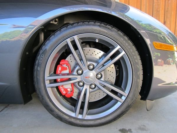

Just curious, why not just park your car on jack stands, and take your calipers apart and get them powder coated?
Maybe you can find a set of used calipers from someone who has changed them out. I am sure there are some out there. Unless you plan to only powder coat the calipers, You would also need another set of brackets.
Having powder coated my own, I know it shouldn't take too long to get them powder coated and back on the car. Also, some shops may have cores, calipers and brackets, available in the color you want, they just need a core charge, and your parts in exchange for your core charge.
In this photo, both the caliper and the bracket have been powder coated.

Your calipers look nice. As I said, I am getting tired of repainting mine every year.
