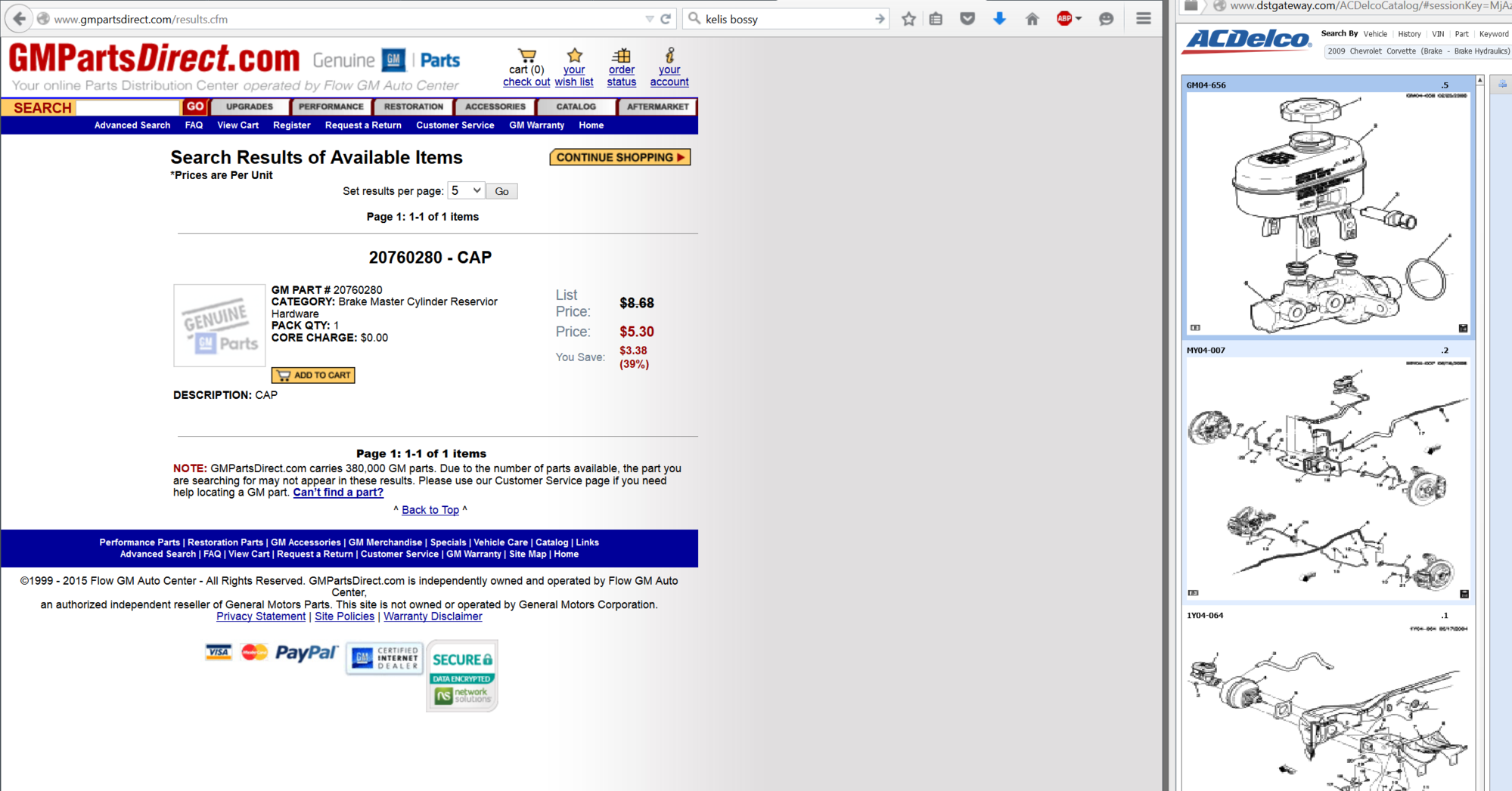

I tried that easy bleeding method. It made it worse somehow. I'm making a DIY pressure bleed so I should be able to flush/bleed the whole system this weekend. I'll check back in then. Have a great week
Now time to go find a spare cap since the cap can only be purchased along with the master cylinder

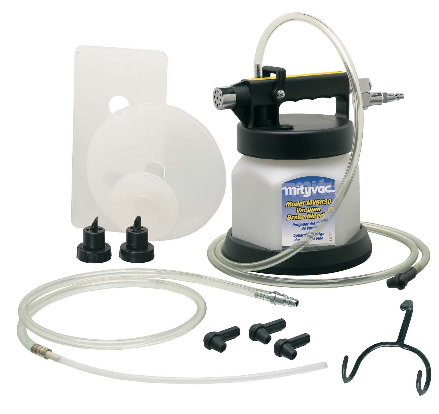

Starting to make me feel like it's the slave cylinder.... I just ordered a vacuum pump and it should be here next Friday. Lets see if that works. if not, i'm done...

2.) i finally got a vacuum bleeder and i tried bleeding it through the master cylinder during lunch. I saw a lot tiny bubbles flowing to the top after pumping it to around 20" vacuum. I kept it at around 20" for 5 minutes. got back into the car and pedal was to the ground. I pumped the pedal around 40-50 times and the pedal seems to be slowly coming closer and closer to the top!!! I'm going to use the vac again for 10-15 minutes after work and see what happens. I'll keep posting

I tried using a vacuum bleed method via the MC. The pedal would hit the floor on 1st pump. After 40-50 pumps, it regain a little pressure and remains about 40% of the way up. A lot less than the pressure bleeding.
