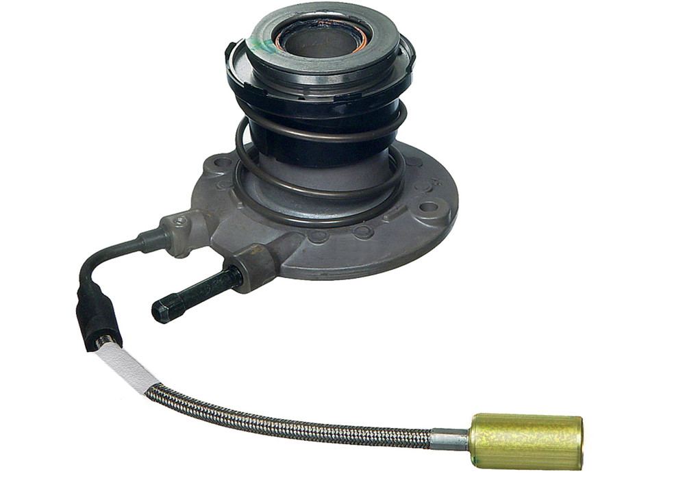

A remote bleeder is nice and convenient but not all of us are willing or able to put a remote bleeder in or quite honestly I don’t know if you can even get one installed without tearing the torque tube and clutch out. So what can we do that is not too labor intensive and wont cost much? or How can we optimize this system and make it last? Whether its the basic STOCK clutch setup or a rather expensive aftermarket clutch this should only help. We are going to tell you how we do it in the car without too much labor.
The easiest way that we have found is to pull the intake manifold for the C5 and C6 Corvettes. We have ported hundreds of manifolds so we have become proficient at pulling intake manifolds. (Total time to clean head ports and put it back on about 45min.) This will allow one to lay in and across the engine bay. With your head right at the firewall with a 9mm combination wrench and a light just barely have enough room to see the port, pop off the rubber cap (leave it off) and open it while someone else is depressing the clutch pedal. Bleed it just like a brake system, one person (A) holds pedal, the other (B) opens the port till fluid pours out and then closes, (A) pumps pedal till firm again and then repeat till fluid is clear, 3-12 cycles. Remember to check the reservoir! Refill it so you do not get any air in the line. Earlier F bodies and GTOs may be accessible from under the car and may not require pulling the intake manifold.

Intake manifold removal is quick and easy. Give it a go and see for your self.

It drains inside the bell housing where the slave lives. It drains to the bottom of the inspection cover where you can flush it out with spray brake parts cleaner and also flysh out any other dirt and dust.

The bleeder sticks out of the side of the bell housing so it'll dump the fluid outside of the bell housing.

Probably not enough access to install a bleeder. I get the impression this is a tough reach and blind, at best.

Originally Posted by Last C5
If you can use this method to reach the port with a wrench, why wouldn't you be installing a remote bleeder while you're there???
It would be hard to do because of the distance to the bleeder threads from the outside. Only the very end of the bleeder screw is accessible..
This is especially relevant with most bleeders that use the short fitting with the crush washer.
Rats, sounded like a way to get to permanent fix without dropping the drivetrain.

It's unfortunate that nobody has made (That I found) the correct fitting that is long enough to do without having it all apart. If the remote bleeder fitting was as long as the stock bleeder screw, it would be significantly easier.

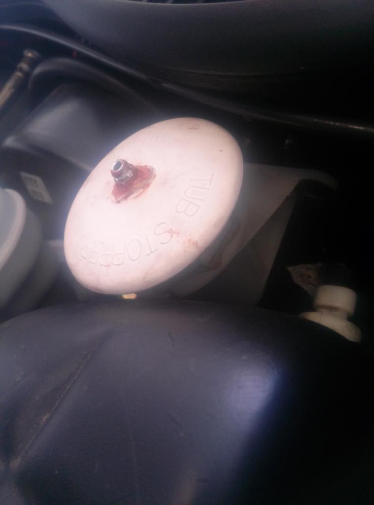

You can actually bleed the slave cylinder by applying vacuum pressure to the MC. This procedure is documented in the factory service manual. If you don't like it, take it up with GM. It requires a special adapter to seal over the MC, but here is a thread about the one I built from a rubber drain stopper.
https://www.corvetteforum.com/forums...c-adapter.html

OH SWEEEET!!!!!!!!! That sounds much better than pulling the intake!!!!! So you just install that plug on the reservoir, pump, and then what?

Pump up (down) to 20" vacuum, hold for a second, release, repeat several times
What happens is the slave cylinder collapses and the air in it rises and/or gets sucked into the reservoir. Then when you release the vacuum, the slave cylinder relaxes, and pulls back in fluid instead of air.
It does work. I've done it several times. And I've heard unofficially that this is actually the method which was used on the assembly line.

So glad I tried this! Worked great and cost me about $10 for the plug from Lowes and bleed screw from Autozone.
