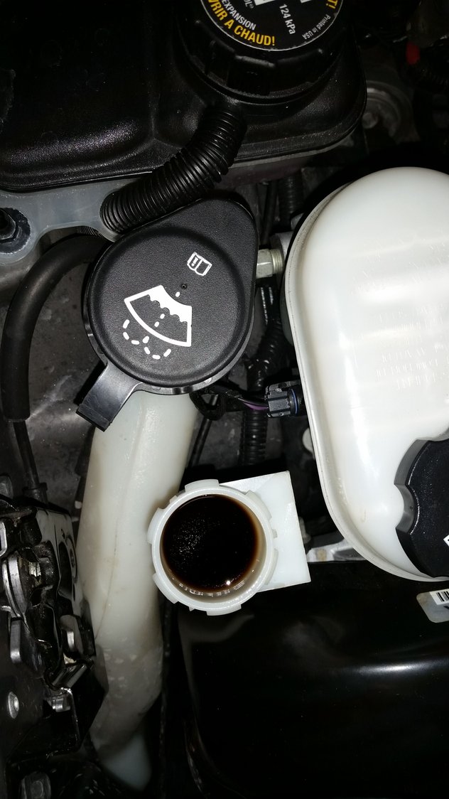

As a related subject, lots of talk on the forums about dark clutch fluid and keeping it clean etc. My replacement master cylinder came pre filled with clutch fluid, reservoir attached and everything. And it was dark, not clear. Comments?

define dark. can you show a pic? I'm sure it's fine, I'm just curious
This is how the fluid looked when I got the new master cylinder.

I'm sure that fluid is dark by design. But given the issue with the fluid getting contaminates from the clutch dust in it, personally, if that was my car, I'd flush it with new fluid. Not because I don't trust what's in there, but to keep an eye of the cleanliness of the fluid, it's best that it starts clear so you can see it get dirty. Again, I flush mine minimum once a month
