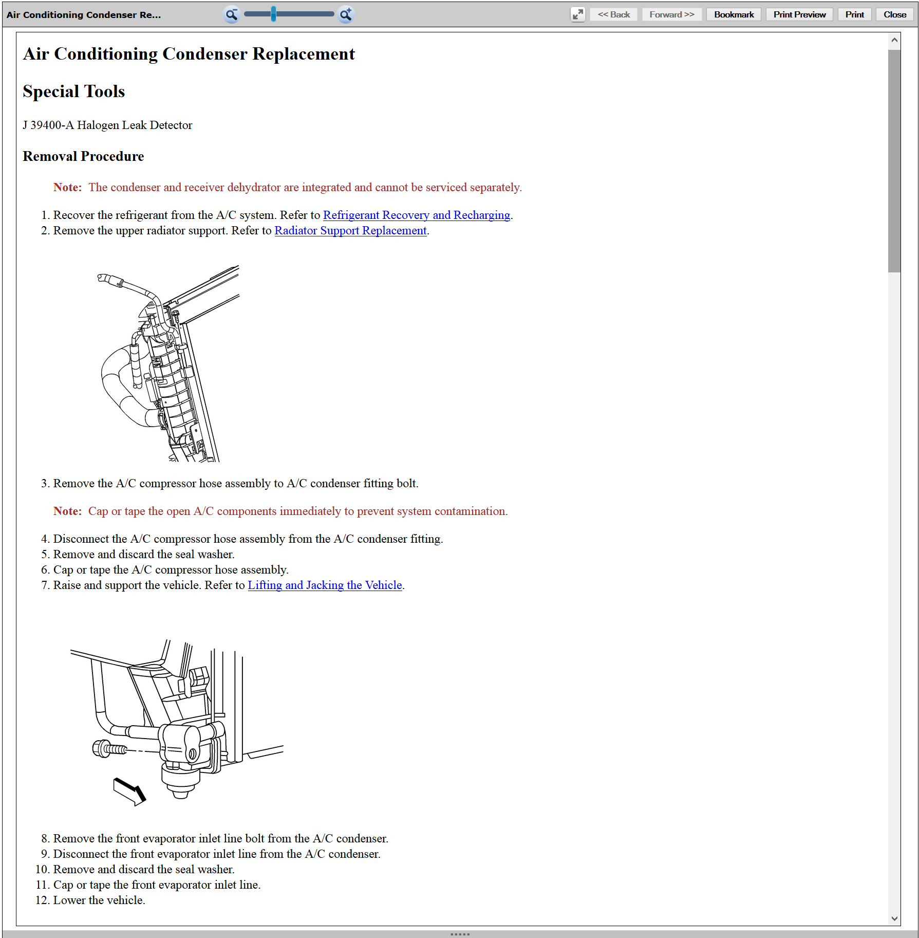

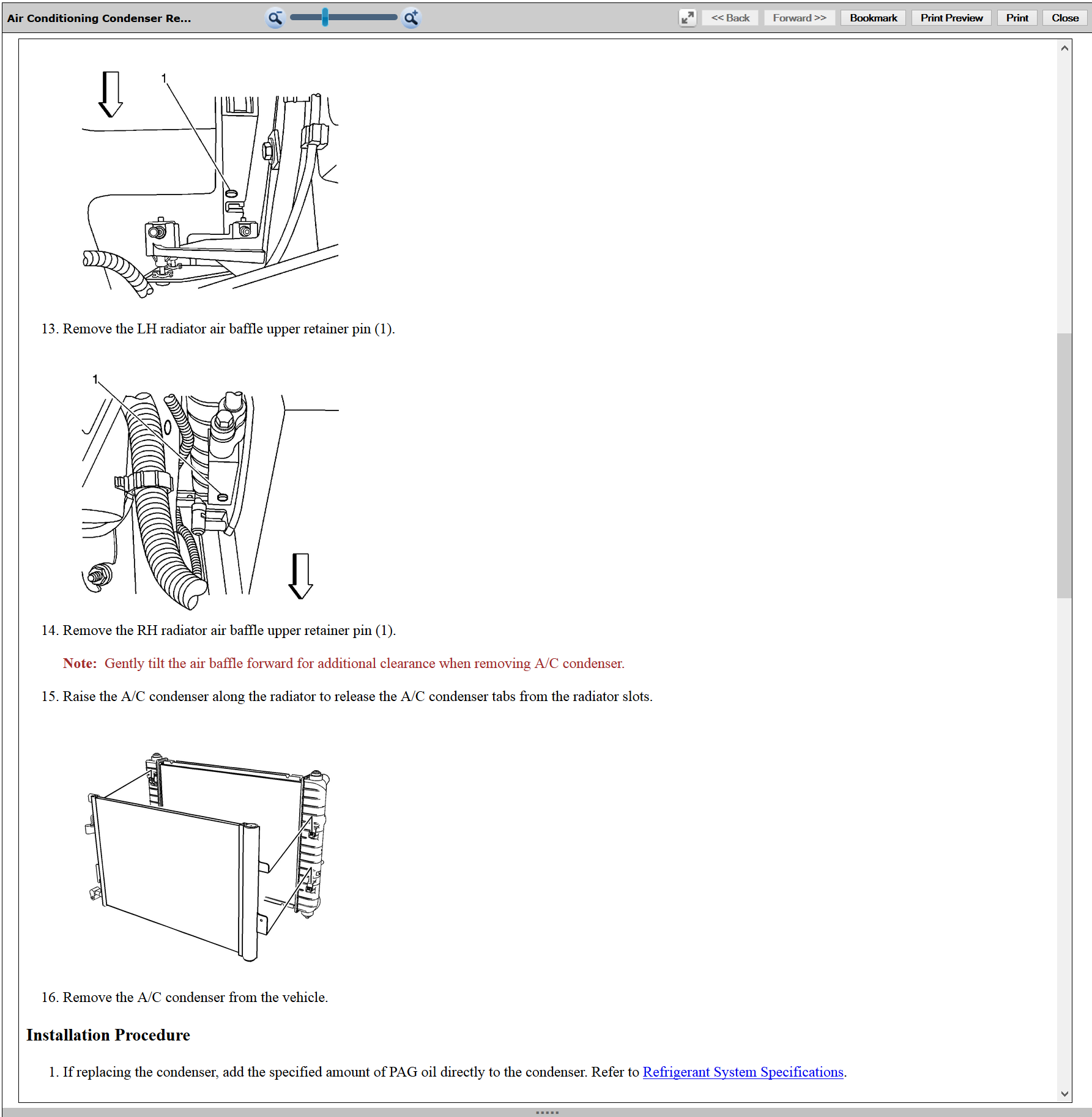

Old Apr 1, 2020 | 08:00 AM

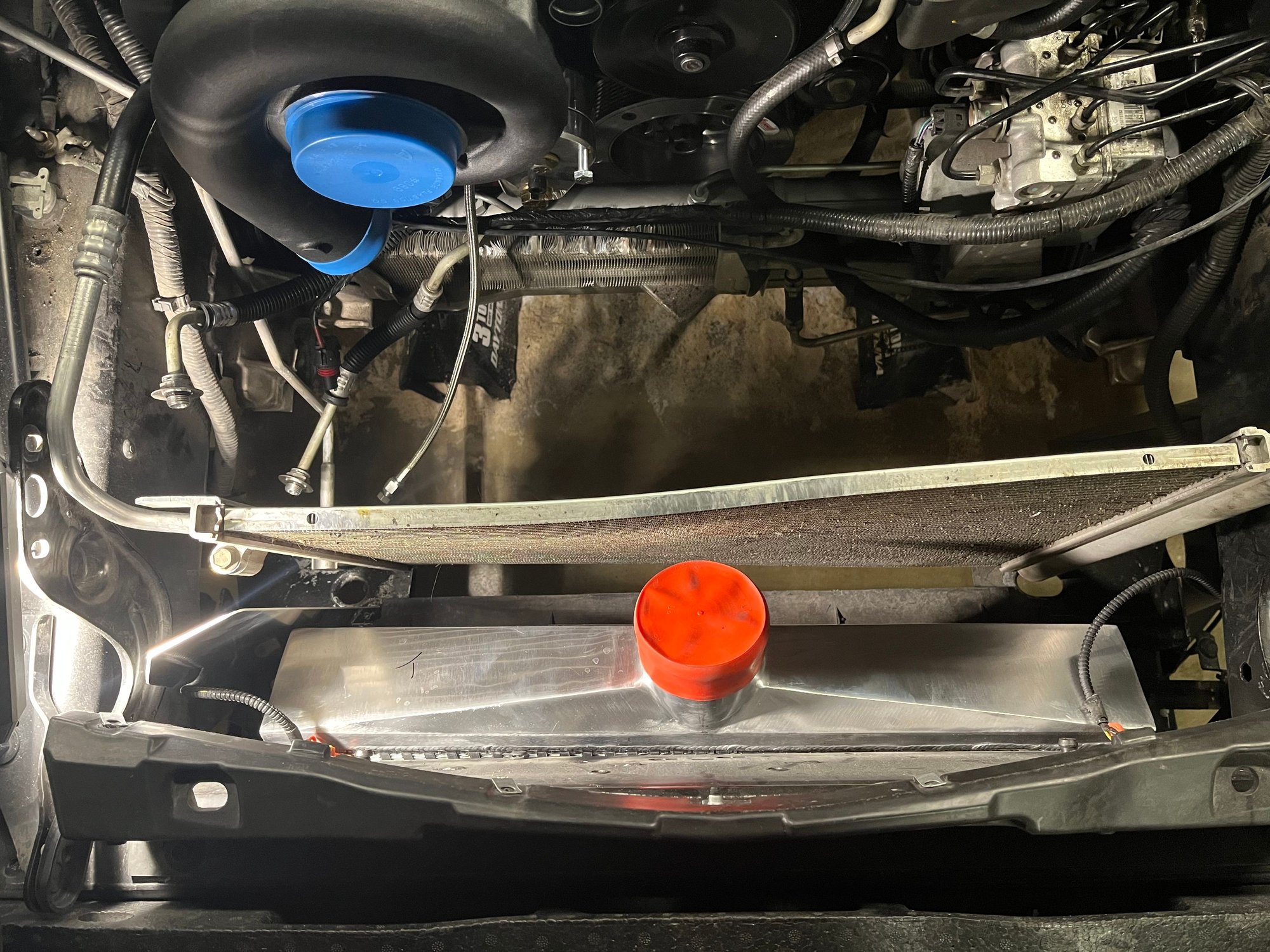

bringing up an older post. I’m in the process of installing an A&A blower. I bent the crap out of the AC condenser while installing the harmonic balancer I’m in the process of mounting the intercooler, and I need to drill the mounts for the two air scoops on the side of the intercooler. So I was thinking to myself how about take this condenser out install the new radiator from Dewitt’s and then mock up the new side scoops for the intercooler? The main question is if I take this condenser out and leave the two connections open until I get a new condenser and recharge the system. Am I opening myself up to bigger problems down the road?

I have searched high and low but cannot find the factory part number for the A/C inline filter (orifice tube) as seen in the image above. I have a 2007 C6 base coupe with Z51 (if that matters). I'm installing a new factory Condenser so this would be a good time to replace it. Does anyone have a number for this that they can share?
