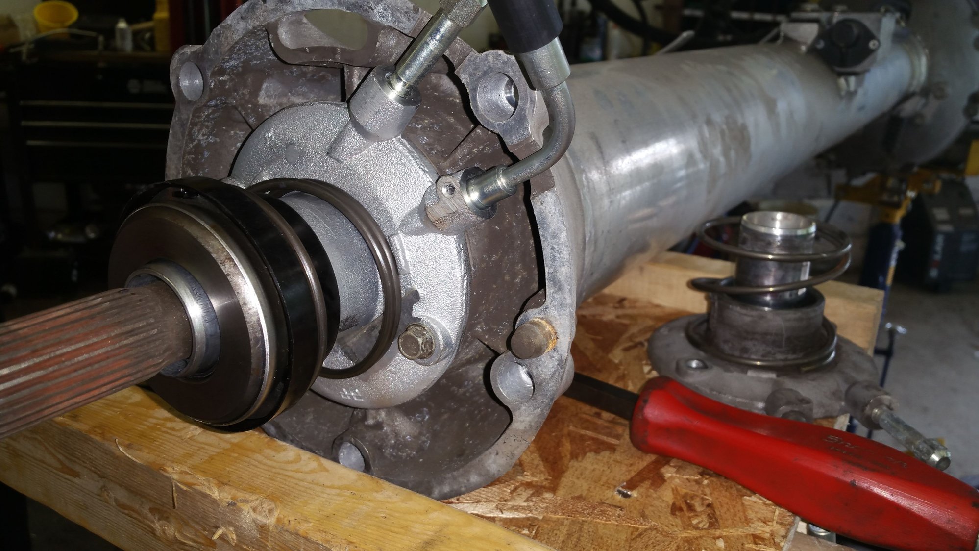

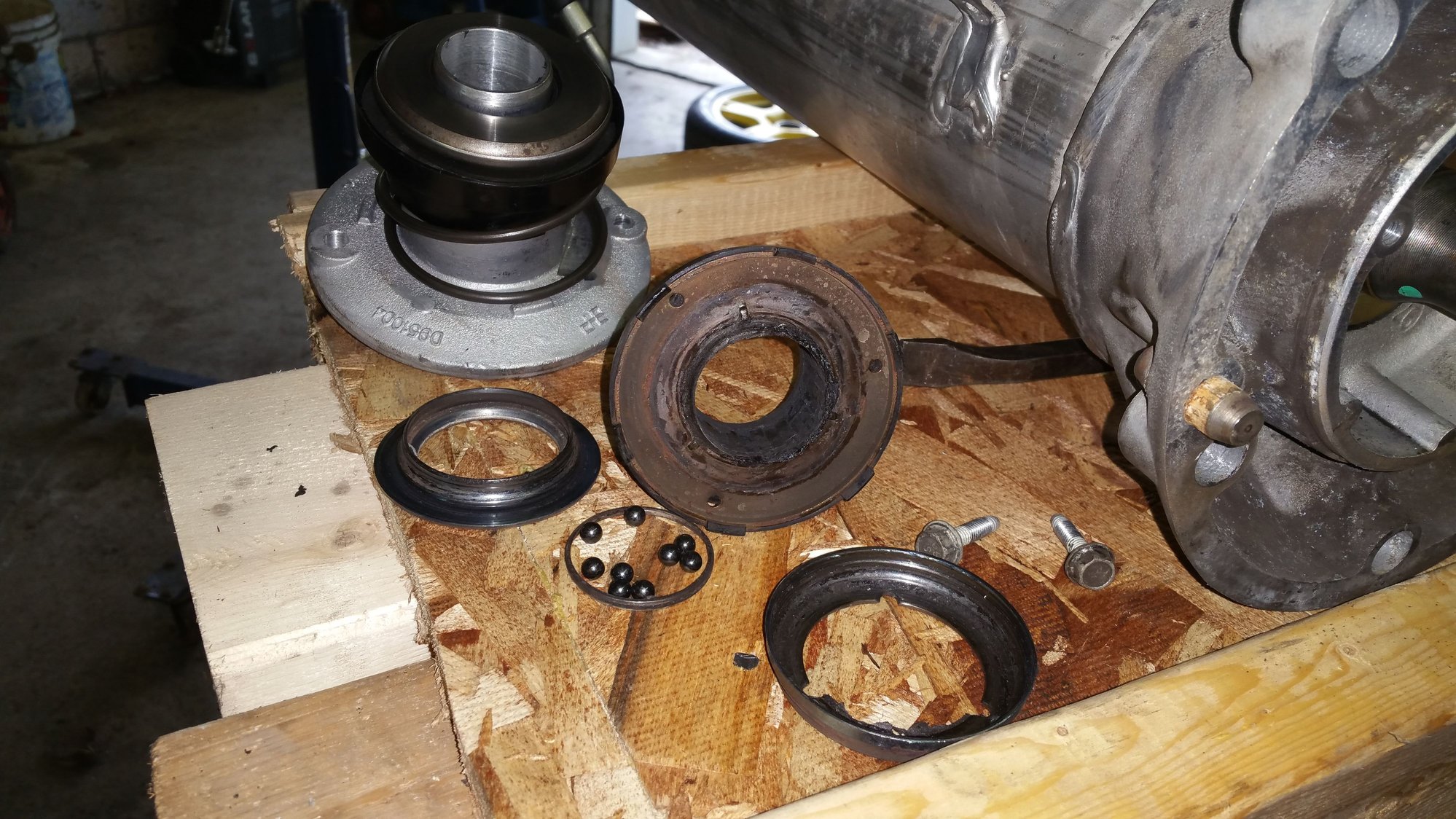

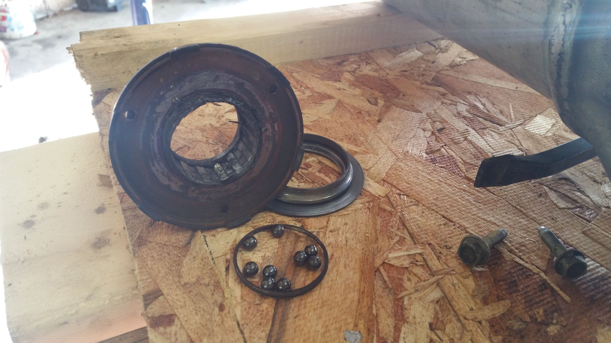

Upgrading monster triple 1000hp to 1500hp and driveshaft to aluminum Hinson 1000hp and couplers. I had a knocking noise from 1500- up RPM coming from bellhousing not when in neutral. Is my slave supposed to be in two pieces like this? There wasn't a shim in here either. Isn't there supposed to be a spring in here? How does clutch look?

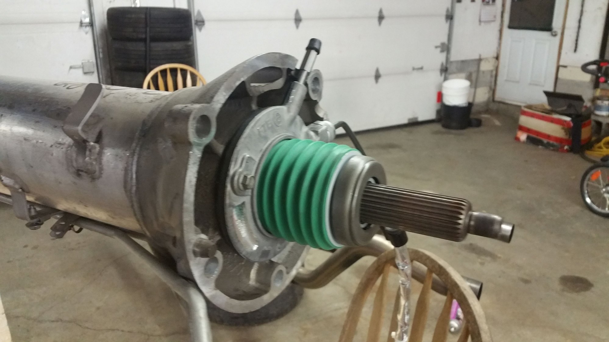

the C5 had a spring that you can see. just did one
but your slave looks nothing like my c6z, what year is yours. here is what mine looks like.

You are missing a few things. Spring and the retaining clip to hold bearing support.

Uhhhh so where the hell did it go is my question. Mine 2008 with TR6060

This is the part number on it but where the hell is the rest of it? Nothing in bell housing.

that's what I'm saying. What you have looks an awful lot like the c5 setup????

No the part number is a c6Z slave. I just talked to the shop that put it in and they said you have to cut it to fit the clutch. Anyone ever heard of this?

Are you using Monster's metal billet bearing support by chance?
To install it you have to take a retainer off of the slave to get it apart. I put one on mine and found it had came back apart.. Was thinking the same might have happened to you
Here's what one disassembled looks like
http://monsterclutches.com/pdf/Monst...ortInstall.pdf

that looks like it for sure, but where did his boot go lol

I don't have the support but it set came apart. Would this make a bunch of noise from bell housing when driving? Don't know where the boot is def not on it or in bell housing.

That noise you here is the bearing bouncing around the input shaft and sliding forward and backwards between the clutch fingers and the slave base. You more then likely need a new slave.

Here's what a brand new C6 slave looks like taken apart. Yours looks like a C5 slave.
I'd contact them first to see if there's a "why" on why it was used. Maybe that particular clutch needs it for some reason.

It has a gm c6 part number. Unless someone stamped on a c6 part number on base and stuck a C5 top on It...lol. It is missing the green boot and spring. The shop that put It in said they cut it and it's normal to do this. Have y'all heard of this? For the horsepower level question it's 1020rwhp @ 16. 1XXXX@ 25

BTW, I personally never heard of someone taking the green boot off. it's certainly not standard procedure as far as I'm concerned. I've done a handful of them and never seen that taking old ones out, and never did that on the way in.
